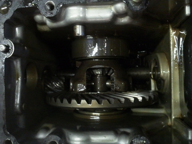

In the words of Scottie - its worse than that its dead Jim.
So I opened up the transaxle case today.... and all the planetary gears in the diff are missing a lot of teeth. Now, also the pinion and wheel on the left side is also not connecting, although I haven't had eyes on that yet.
I'm scouting around for a replacement transaxle now, as that will probably work out cheaper and fairly fast to repair. If I can't find one, then I'll have to so some research on matching parts to rebuild the current transaxle - although the truth is I'll probably never find the time to do that!
Not the greatest picture, but you can probably make out some of the chewed teeth here:

So, it is just the little spider gears.
The ring & pinion is ok.
I wonder if an automotive differential will fit, if you could just find the right one. My biggest problem is searching for something based on dimensions rather than model.
A good machine shop should be able to cut your gears, and repair any bad bushings, but I'd hate to think what the cost would be.
The ring and pinion looks in good condition. I think getting the gears cut would be a last resort, I'm sure I'll be able to get a new rear end from somewhere eventually. The worst thing will be if I have to get another tractor and park this one until a donor unit comes up for sale. I'm sure I'll get some responses from the used parts suppliers once they are back from the Easter break!
