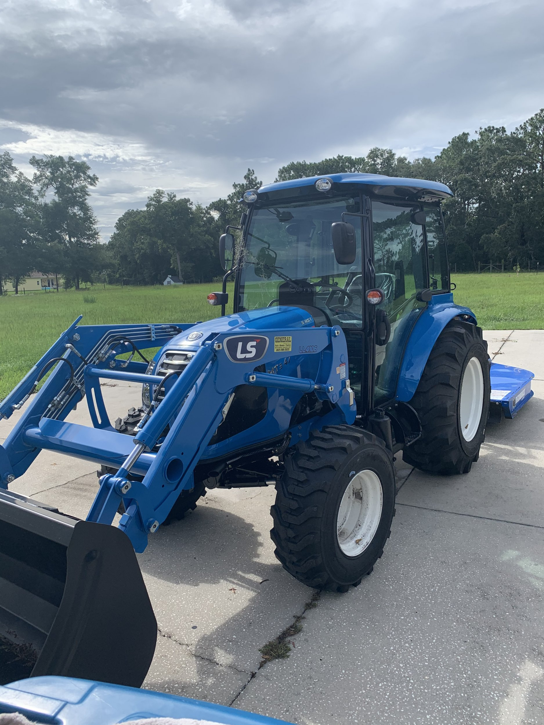

Well...nothing ever fixed my tractor. They did the whole wiring harness, ECM/computer, throttle, and switches. Basically rebuilt the whole electrical system.
I now have a new MT347HC to replace it. The cab is awesome in the Florida heat!
