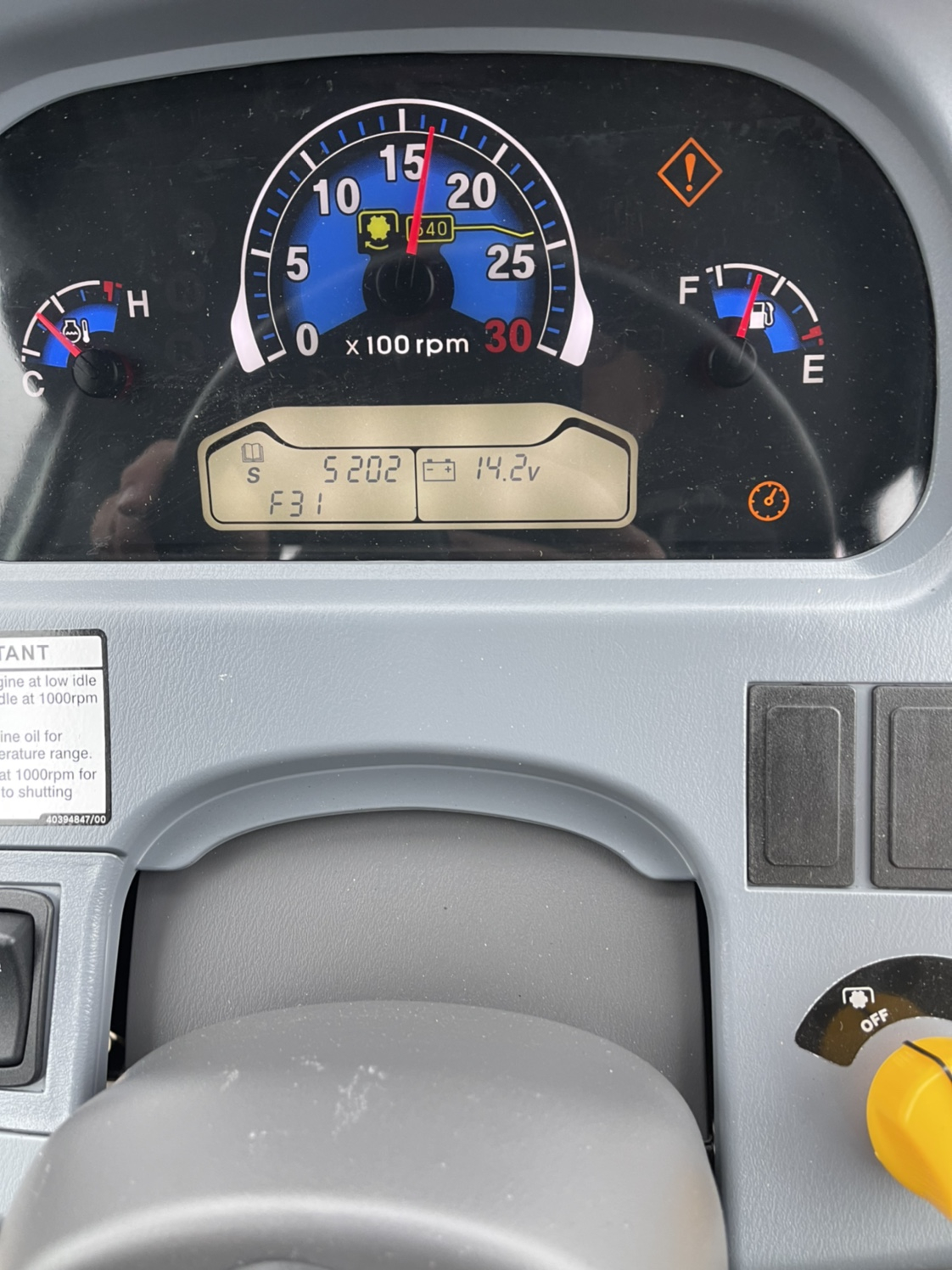

Do you know what the codes are, specifically? Have you tried an OBD2 scanner? I can help look up the codes, and figure this thing out, but a range of codes between 91 and 5202 is not specific enough. Also, they should be S91 F31 or some combination thereof. If there are several codes flashing one after another, take a video or photos and post them.
/ Issue already #40
I'm concerned, just bought a new holland workmaster 40 with 60 hours on it and I'm having these exact issues. It's under warranty, but the closest dealer is 60 miles away.
I have the 636 F02 then i just saw the 5202 F11 code today.
Any thoughts on what this could be?
