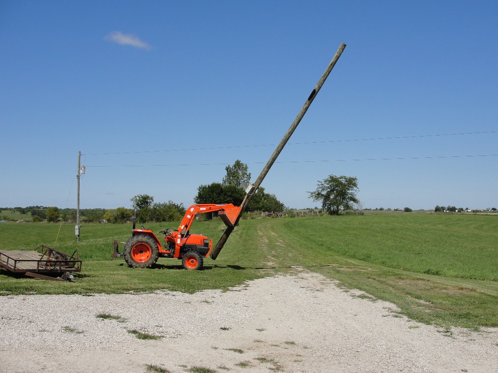

The balance issue holds true for virtually every type of tractor or excavator. If you do a search for "Loader endo", "Loader stoppie", "Dancing diggers" on youtube, you'll see even the big boys could do with a little more weight. (And the employers could do a better job of hiring.)
These guys are doing this intentionally, but if you've never seen these videos before, you may be suprised that those big loaders lift enough to counter their own engine's weight.
YouTube - Front End Loader Stoppie
YouTube - loader stoppie
I can't imagine how heavy my BX2350 would have to be to counter the implements, since weight attached to the tractor itself isn't nearly as effective as a longer (moment) implement.
