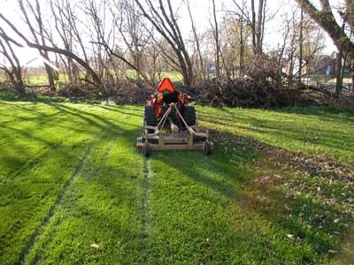

Here's a pic. The add-on is a piece of 12ga that measures 3-1/2" wide X 1" high. Half of it sticks up above the existing wing. I ground the galvanizing off of the new metal, and cleaned the old blade before MIG welding it on. I used a jig and clamps to get all 6 tips on the three baldes positioned the same.....................chim

And here's the way it works since adding the wings. Sorry I don't have a pic from earlier this week when the first 80% of the leaves fell. There are still a few on the trees, but not many................chim
