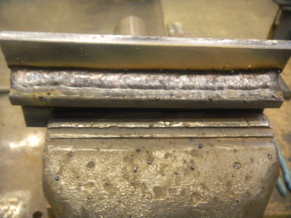

Oh yeah it leaves a real heavy slag! But I always thought dual shield was very fast. I'd have to go and compare the deposit rates between spray, and dual shield, I'm sure spray will have a higher rate. But where I was going with the side by side comparison is all the extra prep work that spray requires. As we all know, there is more to welding that just pulling the trigger!;)
Here is a picture of the slag, and a chipped weld.

Yes, prep time would be an issue especially with painted or rusty metal. For some reason I just don't think of spray transfer as something that would be done in the field or outside a well equipped shop. I don't see it being used on rusty old metal but rather on new fabrication with steel that just needs scale removed. I haven't ever used dual shield but cannot quite see that as a technique to use in the field either given the gas requirement. That said, your picture of the dual shield weldment looks very nice....but not as nice as what even I could do with spray transfer! Spray transfer is so pretty and smooth. Looks like beautifully applied caulking. I may be overly impressed with the finish look as most of my welds are still on the bird poop side of the spectrum.

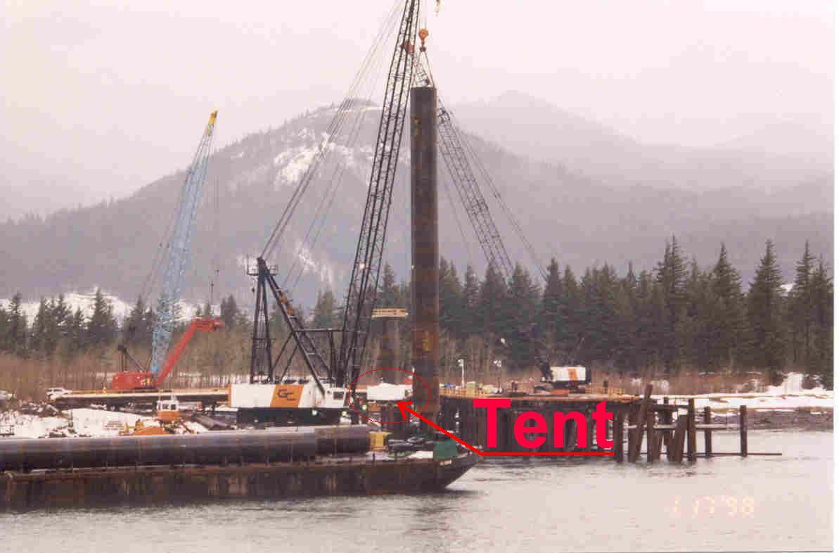

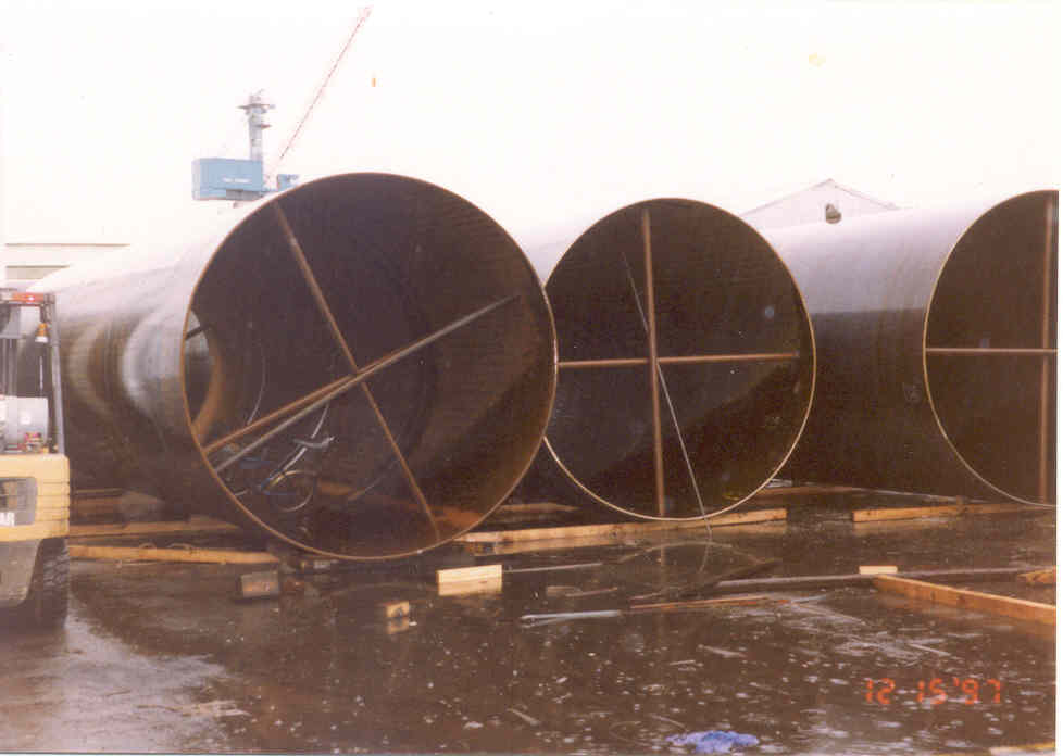

I was the project superintendent on this outfall project. We had a crew of welders welding these 10-feet diameter 1-inch wall pipe with dual shield. 100% X-ray. Had to have the welders in a tent because of the gas coverage.

And there you have it, proof is in the pudding. Some cool projects you have been on bud!

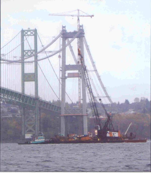

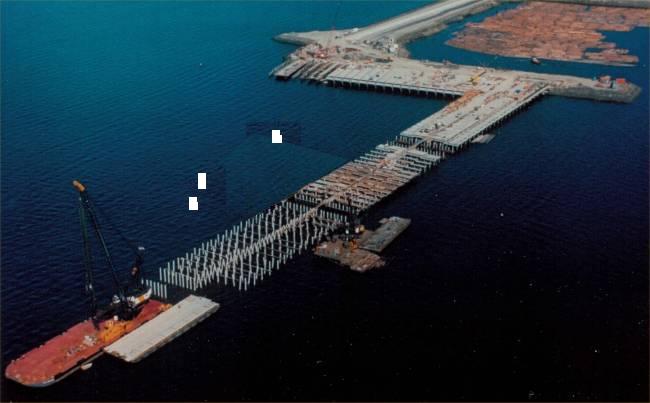

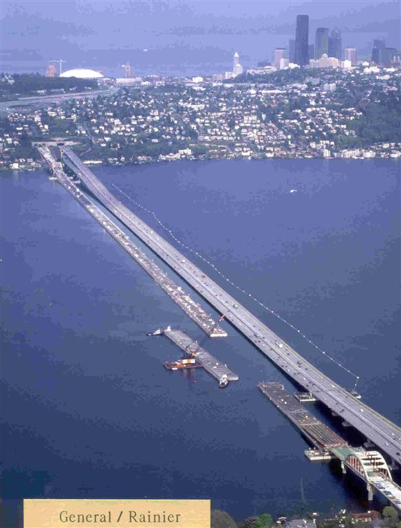

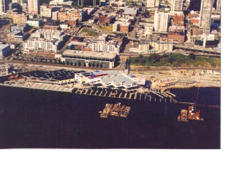

Yeah lots of projects. If I would have known about this Internet thing, I would have taken more pictures. :laughing:
