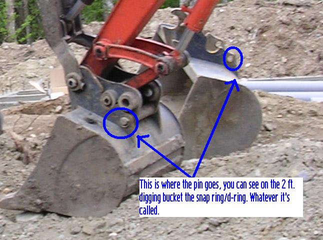

Re: It\'s Here!!!!
Blake,
Is there anyway to get a closer picture? I love to know if it's the same! How is the bucket attached.....Is it a long steel pin at the base of the bucket? I'll post some more accurate pictures if necessary.
Especially since I was told no buckets would be available until June and a 12" would be roughly $800.00 Thanks.

Re: It\'s Here!!!!
Rat, not anymore! LOL. I work at a rental company now so I drive everything under the sun, the only draw back is that I'm not actually doing work with them like I did my last job, I loved that stuff. I'll be switching jobs soon so hopefully I can get back into that. Here's a closer pic. of the bucket Jim, the bucket has a single pin towards the back of the bucket that has a snap d-ring at one side to keep the pin in. That's all there is to it.

Larry,
I guess I didn't put enough washers in cuz I lost it again, and this time I can't find it! I'm going to have to go to the rental place and rent a metal detector to find the pin tomorrow AM. If that doesn't work, I'll have to go to the local steel place and try to buy a new pin and make it myself. There's lots of dirt and rocks where I was pulling some stumps and it's going to be hard to find. What a bummer. I think I'll weld the pin on next time. I little shot the the MIG ought to do the trick. Extremely poor design Kubota.........

Re: It\'s Here!!!!
This is my solution....I bought a 14" long piece of 1 3/16" steel rod and tightened on two pipe clamps to keep it on. It'll be relatively easy to remove now. The pipe fits perfectly. BTW...I actually bought a metal detector and looked for over an hour where I had been digging trying to find the factory pin...no luck. My nephew is lucky....he just got himself a new metal detector /forums/images/graemlins/smile.gif

Re: It\'s Here!!!!
An alternate to the clamps would be drilling the pin and using bolts. Obviously the engineer never ops ck'd his work.

Re: It\'s Here!!!!
I don't think bolts would work very well. First time digging in a trench and the bolt threads are hammered over thus not being able to remove bolt (easily) to change buckets.. I've been through this a hundred times and found a tight washer stack works well. If it is loose at all, you will continue to lose lynch pins

Re: It\'s Here!!!!
The pin is behind the bucket, My bucket has pins with cotter keys that are easily removable and are not hammered. I don't see why the bolts would not work but then again I don't have a OD bucket.

Re: It\'s Here!!!!
The clamps are just temporary until I get a chance to fire up the drill press. I am concerned about the bolt route due to rocks destroying the threads. That hoe point is not the place for anything but hardend steel. I'll likely weld a plate on one end and figure out something more permanent for the other end. I don't want anymore too permanent.

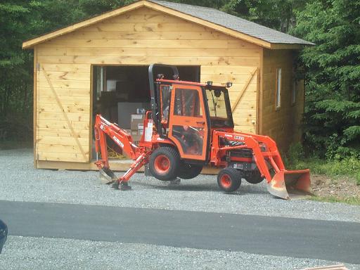

Re: It\'s Here!!!!
Pulled her out of the garage today and wasn't thinking. I ripped the whole top of the garage door trim off and it was sitting on the FOPS /forums/images/graemlins/shocked.gif
