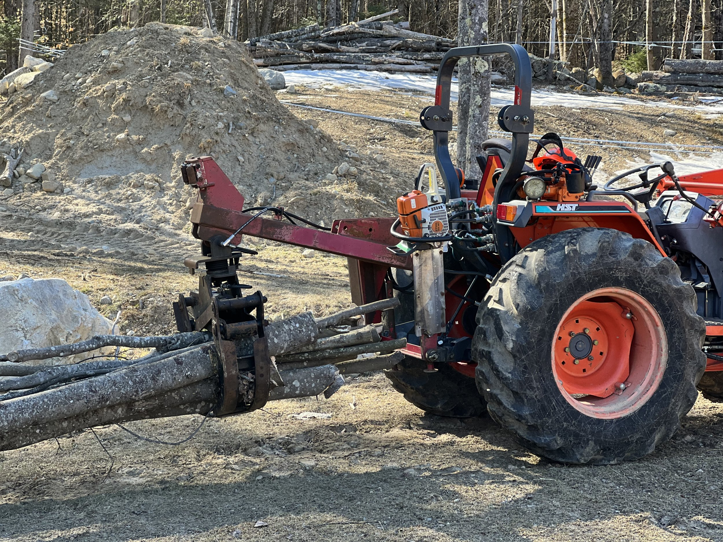

Since then I bought a used logging grapple for less than I could possibly build one for.
I think a good alternative to a full blown logging grapple, would be a simple 3 point frame similar to mine, with just a set of logging tongs hanging from a chain.

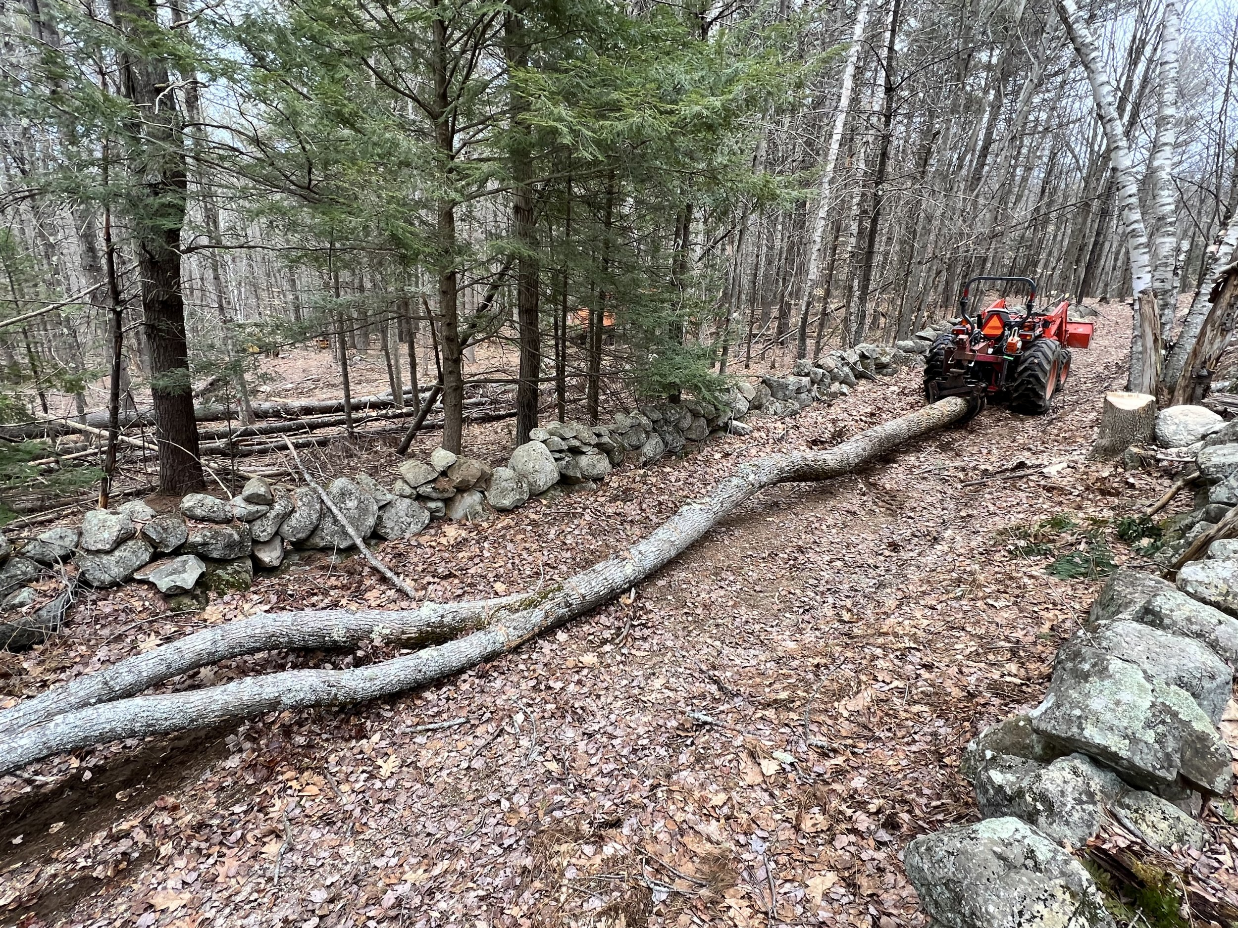

Piston that looks like it had a winch on it at one point. From the looks of the valve on your right fender that you've got to juice, just need a winch.
I build a similar "thing" and put a 8000# Ramsey planetary hydraulic winch on mine. It's no where near the speed or power of a 3pt. and only carries 90' of cable but the line speed is about a foot per second and I'll winch in a grapple full to just under the grapple from different directions and then grapple it out.

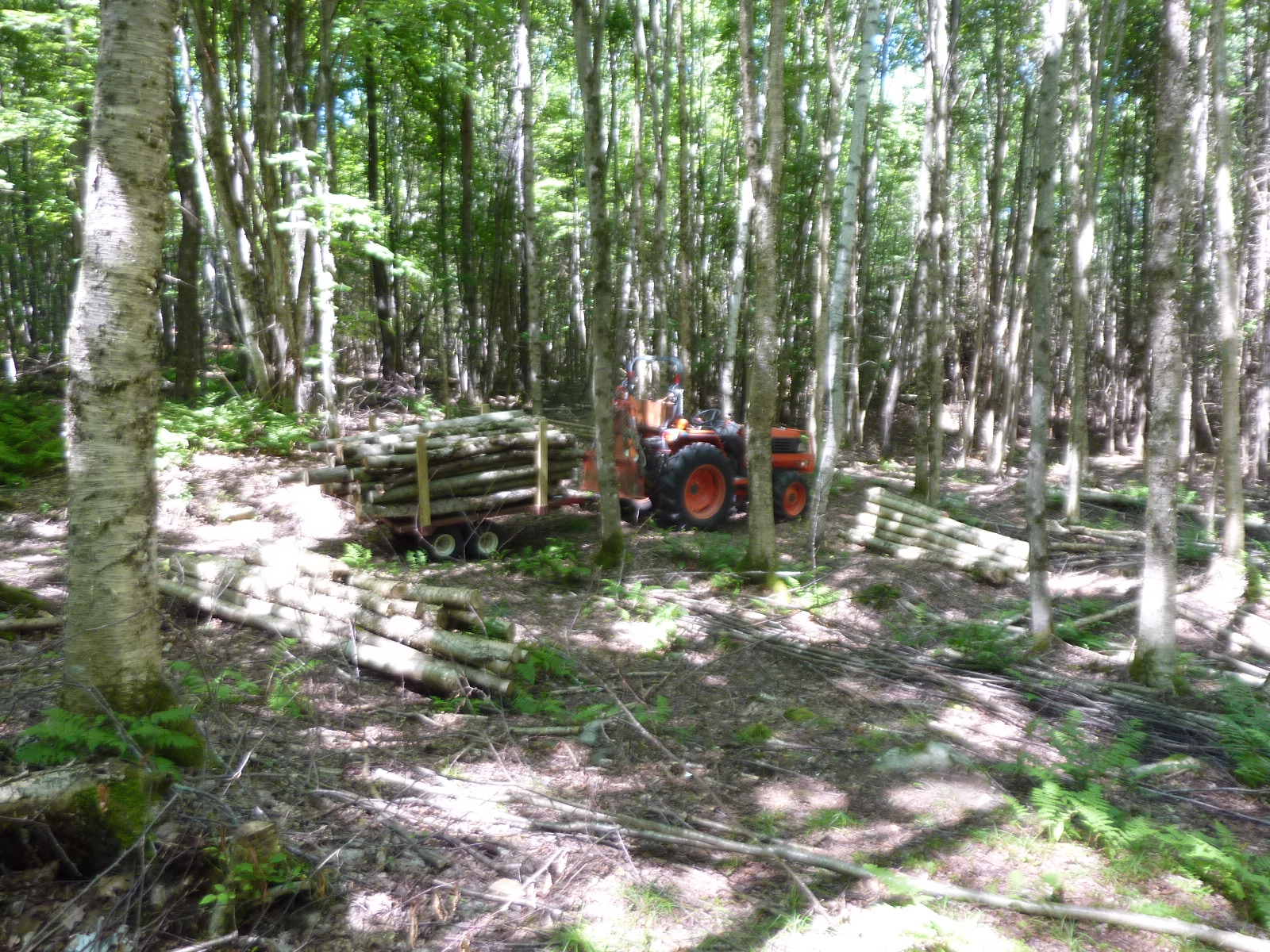

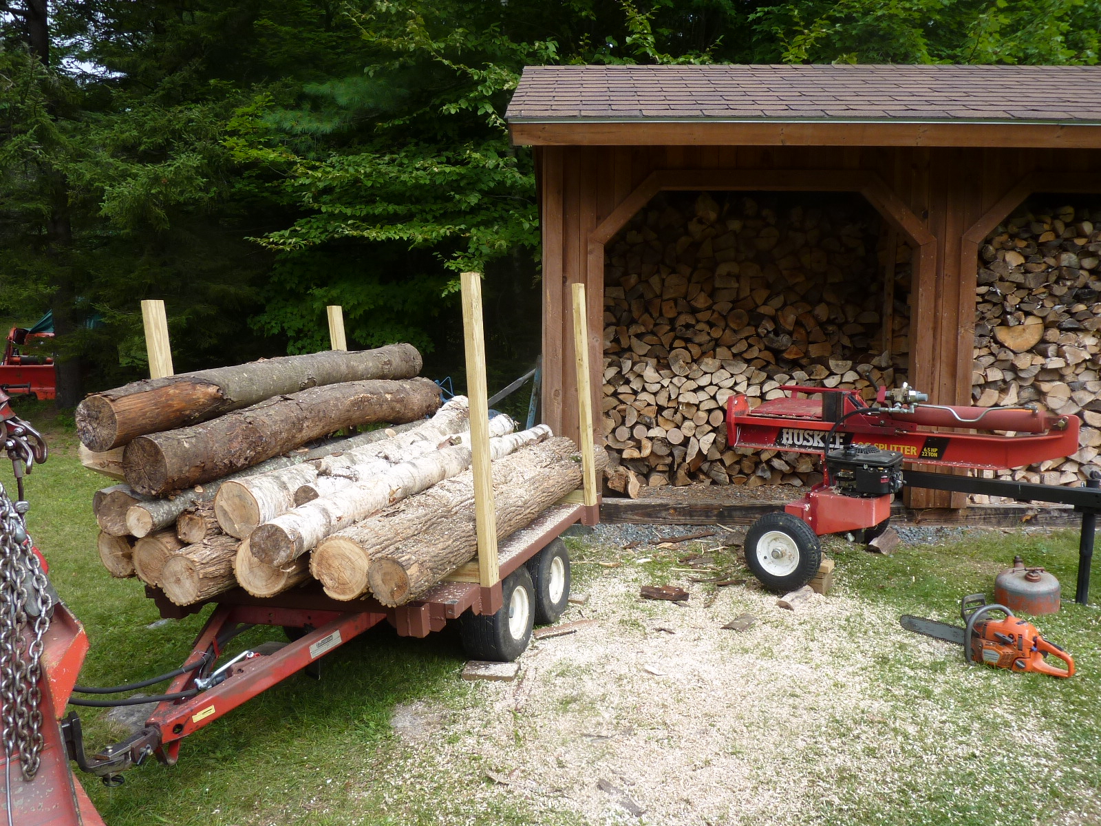

I do mine many different ways but I agree that coming out of the woods with a trailer load of logs and blocking them up right on the trailer, splitting them, and toss into the storage, all in one fell swoop is about the most efficient method I have tried.

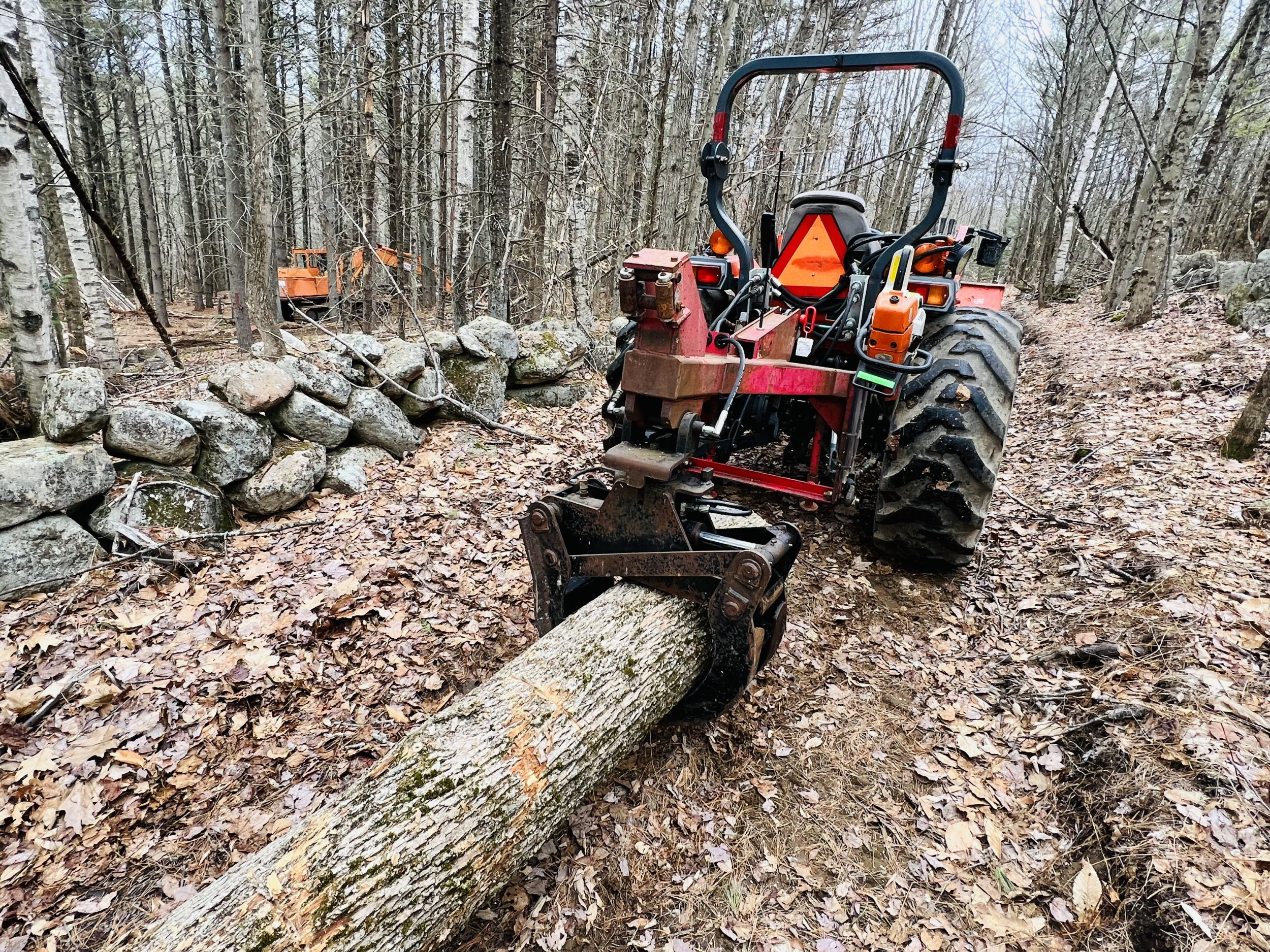

You are correct. The guy I bought it from stopped using it after he bought a Metavic forwarding trailer. He had a hydraulic winch on it but wanted to keep the winch. I've wanted to get one for it ever since I bought it, but I haven't put in the effort to find one. I honestly don't know what to look for??? It seems easy enough to bolt on and hook up the hydraulics, but what do I buy?
I really like the grapple as I don't have to get off the tractor to drag trees out, however if I added winch, it would obviously be many times more useful. I've been looking for a 3 point skidding winch for a while, but I'd almost prefer to just add one to this and avoid having another implement.

Gordon, is that your old pronovost trailer? That is a great idea. I ended up selling mine because I felt it was just too small. This looks like a great way to make it super useful.
   / It's Logging Season-Northeast #27
Yes, that's the Pronovost. And every time I use it I thank you for telling me about it's availability. It is small by most standards but good for my 30 hp L3010 in the woods. I can haul a yard of gravel or 3/4 cord of wood. As you know the side panels are removable. I added some stake pockets and rub-rail/side stiffeners to make it pretty versatile now.
