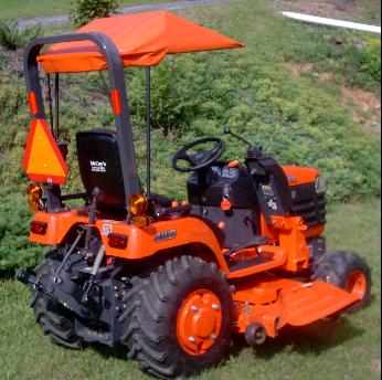

<font color="blue"> Do you have any pics of the FOPS posted sans the mini skirt ??</font>
Since you asked... /forums/images/graemlins/grin.gif
And here is a thread showing the evolution of the Hood Guard…Head Guard /forums/images/graemlins/smile.gif
   / It's not a Canopy, but... #22
Re: It\'s not a Canopy, but...
Very nice. Looks like good protection from limbs and small trees. When reading your post about building it, you stated you were thinking rollover. I dont think I'd like to put that to the test with that light of metal, but if you keep most of the rubber on the ground that thing should do everything you are looking for. May have to rehone my poor (very poor) welding skills once I find a bigger machine.
#23
<font color="blue"> When reading your post about building it, you stated you were thinking rollover. </font>
Not so much roll over, as in roll cage type protection, but more worry about somehow tipping the tractor beside a tree, with the tree on my side of the rops and nothing up there to stop a slow speed, low energy tip...as the tree slid down my side of the rops...and my seatbelt held me firmly in position under the tree, as the distance between the tree and seat got smaller and smaller... /forums/images/graemlins/frown.gif ... with me in between... /forums/images/graemlins/shocked.gif
I figure the ROPS is the main line of defense if a roll over would occur. Along with the protection from flalling limbs, I am pretty sure if the tractor started a slow roll next to a tree, the light duty fops would stop it. It is rock solid when I climb up on it once in a while and sure feels solid...in any case, I hope to never need it for protection, either from falling limbs or a tip over next to a tree! /forums/images/graemlins/smile.gif
