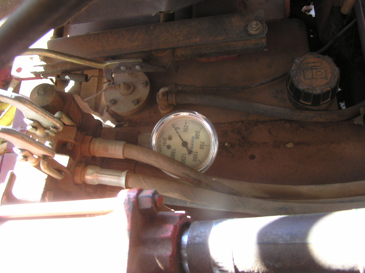

Do you have a high pressure gauge to see what it is doing?
I put one on the loader valve to see what is up. Or down ;) .
   / It's time; either get started or....
#185
I don't have one that is specifically for testing hydraulics but I'm thinking an old gauge off a cutting torch, either oxygen or acetylene side might serve. In the meantime, I have the pump off. I can turn it by hand but it feels like there is a "load" even though the ports are open and there is no fluid in it. Is that normal? The Sta Rite pump I have on the bench turns freely and I can feel there is both suction and pressure. The problem with that one is the three outputs and how to manage the two I can't use.

I would start with teeing a 3000psi or 5000psi gauge into the line from the pump to the valve to see what pressures you are getting from the pump.

I have had time to do some calm meditating on what could be going on with the hydraulics and I have come up with two scenarios which I need to check out before I spend money on a new pump. The first scenario has to do with air entering the system ahead of the pump. Not impossible but because I don't see any leaks between tank and pump when the engine is off, that scenario is unlikely.
The other one, which I should have checked out before removing the pump and should have been a no-brainer is stalling of the belt drive under load. Because that is under the tractor and out of sight while I'm trying out the operation of the hydraulics, I never thought to check on that (another example of brain cell aging/decomposing) :rolleyes: . While I had the pump off, I opened it up to see if anything obvious showed up. It looks clean and I don't see any wear or sloppiness in there so I closed it up and tightened up the four bolts that hold it together. Now I can't turn it by hand but I'll loosen those bolts, spin the shaft back and forth and retighten the head bolts and retry till it works like it did before I opened it. If, when I have it all put back together, it turns out the belt(s) are slipping, I have an idler pulley for that.
