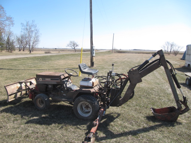

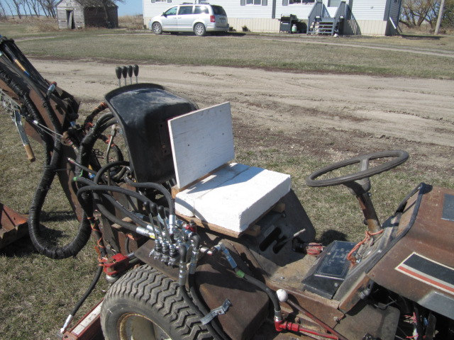

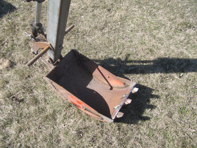

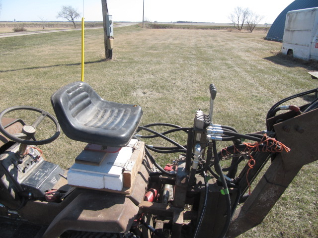

It's over three weeks since I posted to this thread and in that time I have made some progress. The engine starts and runs since figuring out the scrambled terminals on the new ignition switch - totally different from the one I took out. 🤨 I have all but one of the hoses hooked up. That last one needs an adapter to complete the circuit. Hope to have it tomorrow. I drove the backhoe out of the shop yesterday and took some pix.
The first one shows the machine after driving it out of the Quonset. Pic #2 is the seat ready for backhoe operator. #3 the seat for driving. That "snarl" of hoses will need some tidying up to make room for my left foot!! #4 the bucket with its teeth. IMG_2712.JPGIMG_2714.JPGIMG_2716.JPGIMG_2720.JPG That long pin will be shortened after I determine how I'll attach the chains if needed for helping with dumping out sticky clay that wants to stay in there.

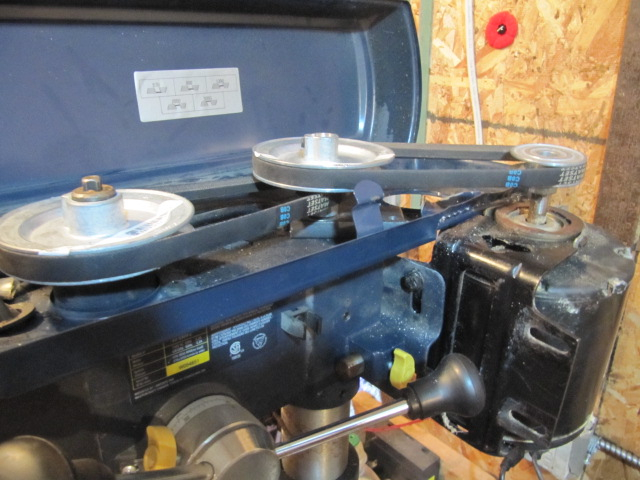

Can you do a speed reducer like you did on your drill press?
   / It's time; either get started or....
#170
That is what I'll try if I take that route. What I hope to do first is fashion homemade restrictors for the individual cylinders. The location of the pump drive is under the tractor because the engine is a vertical shaft type. Not really a fun place to work :rolleyes:.
