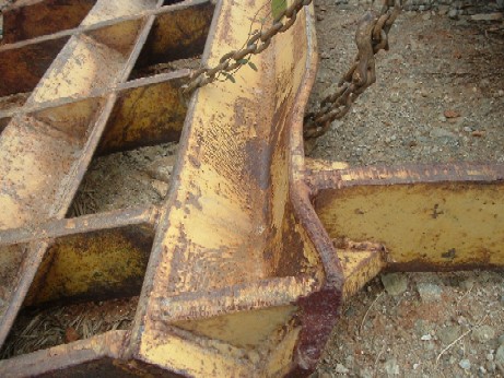

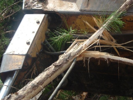

We cut three pieces of 2 inch angle iron and welded it together in order to deflect those trees.

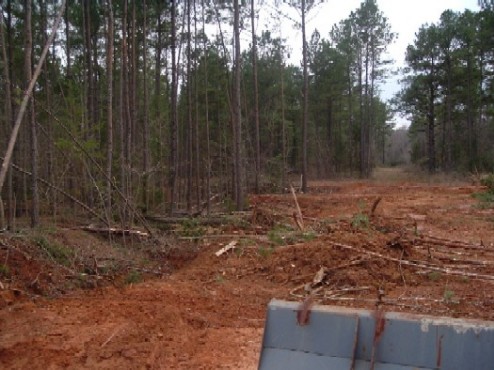

It's been long enough for those trees to dry out enough to burn.
I had a guy out who wanted to the pines, which I gave him for free, but after a few trips, he hasn't been back in a couple months. Not sure why, he doesn't return my emails. Oh well, time to burn them.

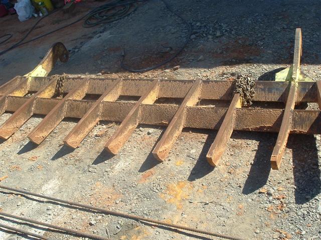

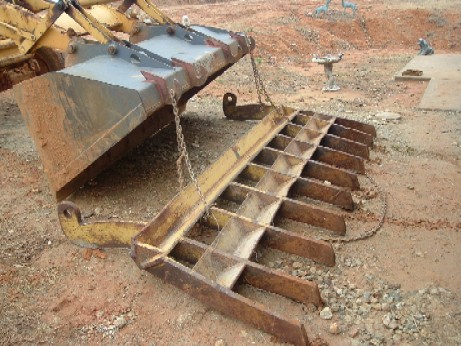

Here is the rake on my dozer.

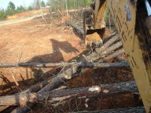

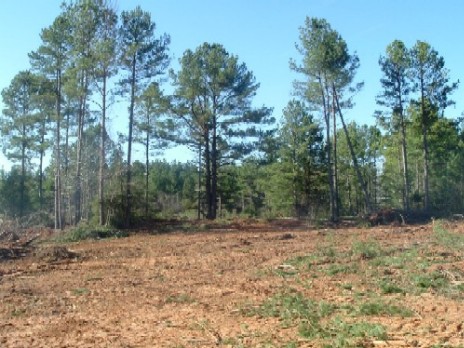

The trees are where I left them, but now they are all dried out.

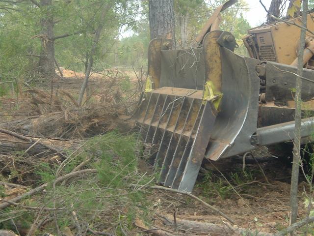

Re: It\'s tree removal time!
The rake does a real nice job of holding onto the trees without digging up the ground. I can even push more at a time with the rake!

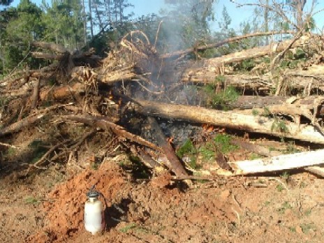

The fire has been going for a few weeks now. When it gets to hot out to work on my workshop, I take a break on the dozer. Every day I add a few loads to the fire, punch it up and let it burn.

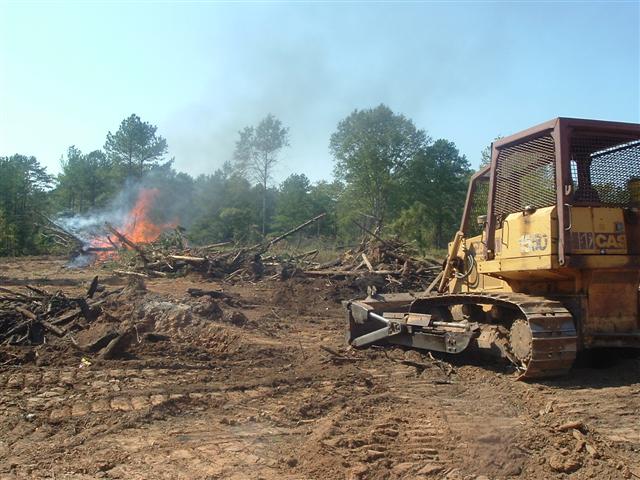

Time to fire up the burn pile. For now, I'm just interested in trying to clean up the trees I've had on the ground since I started building my workshop and home.

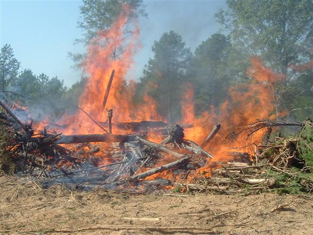

This has been burning for about two weeks. Every morning, more trees are added to it.

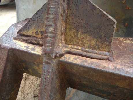

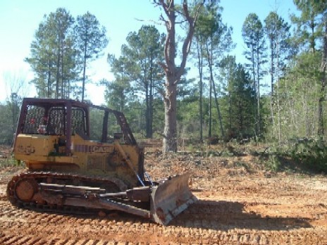

While the fire has been burning, I've been clearing my trails and moving some dirt. That's not even close to being done, but it's a low priority for now.
Burning trees and cleaning things up is my present priority. The best tool I have for this is my rake on the dozer. The problem I'm having with it is the teeth are over 12 inches apart, and I'm losing lots of small branches while pushing piles of trees.
Eddie
   / It's tree removal time!
#96
My neighbor had a rake built for a small dozer with the teeth only 6 inches apart. It does an amazing job at getting all the small stuff.
My teeth are 1 3/8 thick by 5 inches and overall, it's ten feet wide. Pretty substantial, but it could use seme improvement.
I thought about putting another tooth between the existing ones, but haven't come up with a good way to mount them to maintain the same level of strength.
Then I thought about putting wire mesh across them to catch all the branches, but changed my mind when I considered all the dirt it would hold.
My solution was to weld 5/8 rebar across the teeth to catch those branches I'm losing.
Eddie

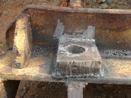

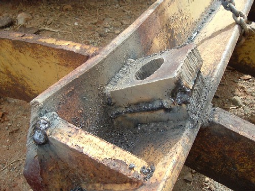

#98
Well, this didn't work out very well at all. As you can see in the pic, all the rebar is gone. In just a few hours, it all broke of in pieces.
I'm thinking that 160 hp, 40,000 pounds and trees that are all tangled up and being moved hundreds of feet over uneven terrain is more stress and preasure than the rebar is capable of handleing. /forums/images/graemlins/frown.gif
Next I'm thinking about welding a piece of 1 1/2 inch angle iron I have across the teeth.
Any suggestions?
Eddie
