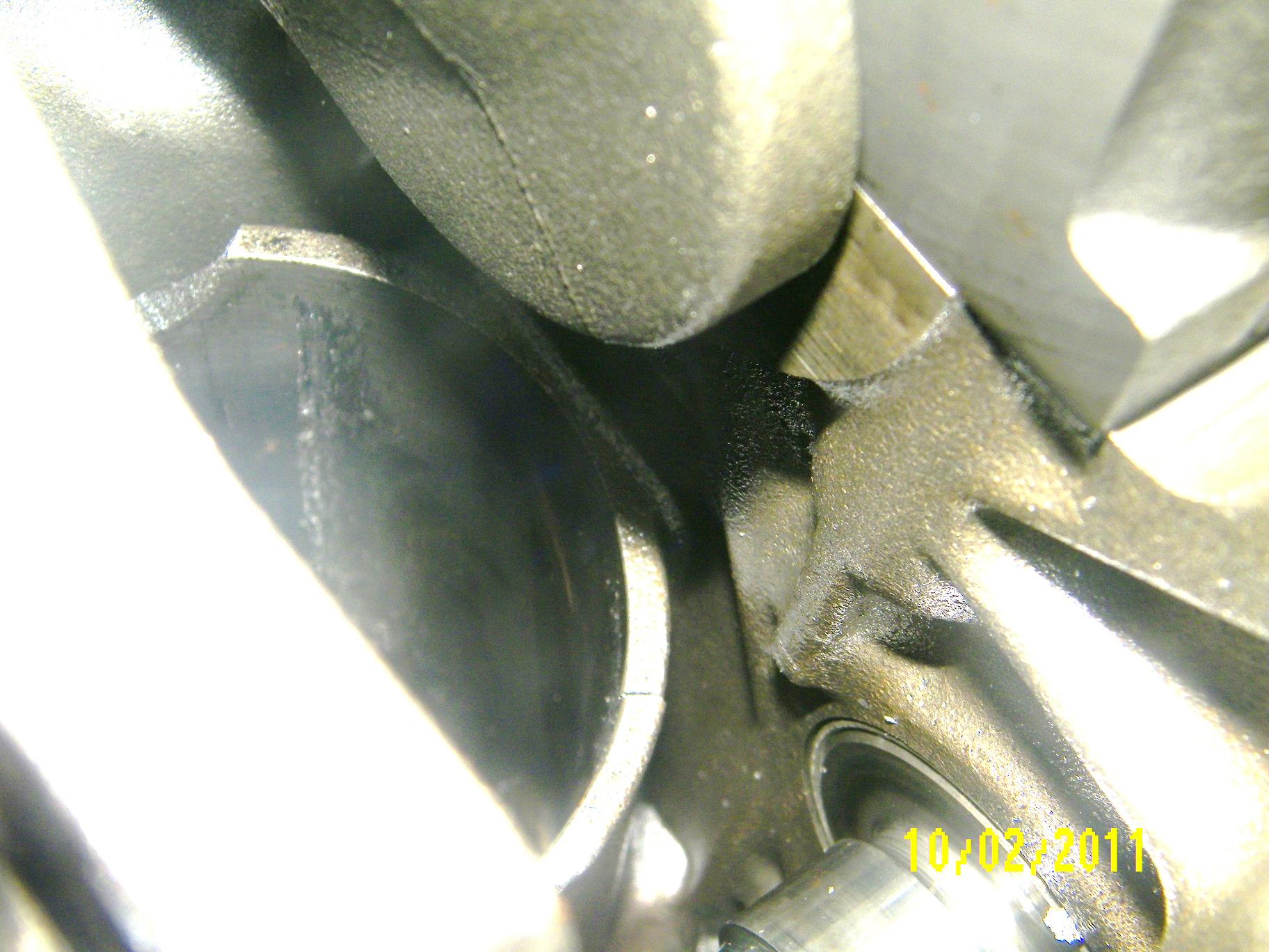

If it has sleeves the block is a easy fix.Look at cyl from the bottom.This is usually the easy way to toll if it has sleeves. The bottom of the sleeve is machined and where the bottom of the sleeve meets the block there will be a line around the cyl.If the liner goes through the casting look on the out side of the bottom of the cyl for machine marks. You will be able to tell where the sleeve meets the casting. I would let a machine shop look at the head. They can magnaflux it and find cracks that you cannot see.

Yea, I need to get the bottom end opened up but need to get it on the stand first. But... I'm in the middle of a major remodel on the house... so my weekend time for toys is limited (by respect to my wife). I really need to stay focused on the house. You married guys will understand this...she wants her house back. It came up on eBay... did the "buy it now" thing... and went and picked it up. But my curiosity would not let me leave it alone... so I pulled the head. I was told it had swallowed a valve...

I don't *think* the 2011s are sleeved. The passages you see surrounding the upper cylinder and combustion chamber are for engine oil for cooling. When you go to price/order replacement parts, you'll need to know how many notches the head gasket has and such. Your service manual will explain it all in detail, but when the short block is assembled, the piston's protrusion above the deck needs to be measured so that the proper thickness gasket can be installed. In one corner of the gasket, there'll be a set of notches for identification....usually one, two, or three notches. We've had the heads off of several Deutzs, and usually just use the original gasket for reference.
Not sure why the valve let go, I've never seen that occur on one...BUT...the Deutz is an interference engine. I have seen LOTS of them have the valves hit the pistons when the timing belt fails. Deutz built the engine with the pushrod as the weakest link though, so when the belt breaks and the valves *meet* the pistons...the pushrods bend. The pushrods are rigid enough to do their normal job, and no more. I've gone on a few service calls over the years, replaced a broken timing belt, and then...bent the pushrods "straight" again to get the machine up and running. Is it "correct" to straighten out a bent pushrod and re-use it? Nope. But sometimes you work with what you have to work with. Many people pooh-pooh the timing belt setup, and really pooh-pooh the bent pushrods issue if the belt lets go. The thing is, Deutz recommends belt replacement at 3000 hours. It's fairly easy and inexpensive to do...so it's hard for me to be sympathetic when owners/users let 'em go and then complain when it fails at 4-5000 hours and it costs them more money.

I really appreciated your long reply and information. I had stumbled on Memo's web page in my information searches... and sent off for info/quote on the more common things one would need for a rebuild. Now he did list a liner... but at 28 dollars and change I thought it a mistake. I'll be getting it on the stand shortly and pulling the pan. So will see if its really lined or not. If it is, its wet. the casting cracks grain of the metal is uniform all the way across, so its either block or a bottom held wet liner... lateral forces have to be held at the bottom as the top just seals down to the head gasket.
I wondered about the belt when I first started researching after I bought it but before I picked it up. Was a bit surprised to see Deutz design that way. Boy yea... talk about an interference engine!!! Likely has less than about a 16th inch between the valve heads and the top of the piston at TDC! I looked at the push rods... some have been bent evidently in the past... slight "s" shapes to several, but these pistons do not show sign of contact... so it wasn't this build. Very little ridge... but who knows how many hours are on it total. I can't imagine reusing those rods... but hey... some people can't imagine me using much of anything on this engine either. I figured on a new belt just on principle when I saw it was designed with one. I will not own another car with one.

That's not unusual on these actually. When the valves and pistons do come together, they hit almost dead flat. The pistons usually don't get indented or anything. There'll be a circle imprinted in the carbon coating the piston top...and that's about it. Once in a while, I'll see one that has had the belt break when the engine was running at high speed, and then the pushrods will be bent and the rocker arm mounting bolts will be deflected sideways also. Not enough to see at first, but it becomes apparent when they're being unscrewed as the bolts and rocker clamps wobble. Then once you get them out you can see the bend clearly as you look at the threads....

OK all... here's the verdict... its basically dead.
-Non-Sleeved... not good. Not sure it can be made to accept one or not... **** tight to the web for the main bearings (see photo).
-Timing belt is in good condition... properly tensioned... expect its still in time... and NOT the cause.
-it just sucked a valve due to valve stem failure at high rpm. Too bad, its clean as a whistle in there... not much time on these cylinders. I've seen much worse.

-modify the block and build a sleeve... maybe, but my mill (1935 Van Norman #12) is not likely able to handle that. The lathe can turn a liner (1920 Hendey 14x5), but I may have to have the block machined at a machine shop.
-find a good bare block... and rebuild from there...

From all evidence, I think some one went through this from a belt failure not very long ago... either short blocked it or rebuilt this block... but didn't examine the valves good enough (although one may not have been able to see much). Valve head is gone, broke off the stem, the bent stem was still in the guide... but the stem was also broken at the base of the keeper... hard to tell which end let loose first. But several slightly "S"d push rods indicate a potenial prior interference. Engine is almost clean enough to eat off inside... one can see that in the photo. No ridge. Honing is gone though. Rod bearings like new. I'll research this winter... likely finish stripping this block and take up town and let the machinist tell me what he can or can't do with it. It will just sit in the shop until then. Maybe I'll find another 2011 by then, and use the best from both. I've done that before on a 1950 Minneapolis Moline "U".
