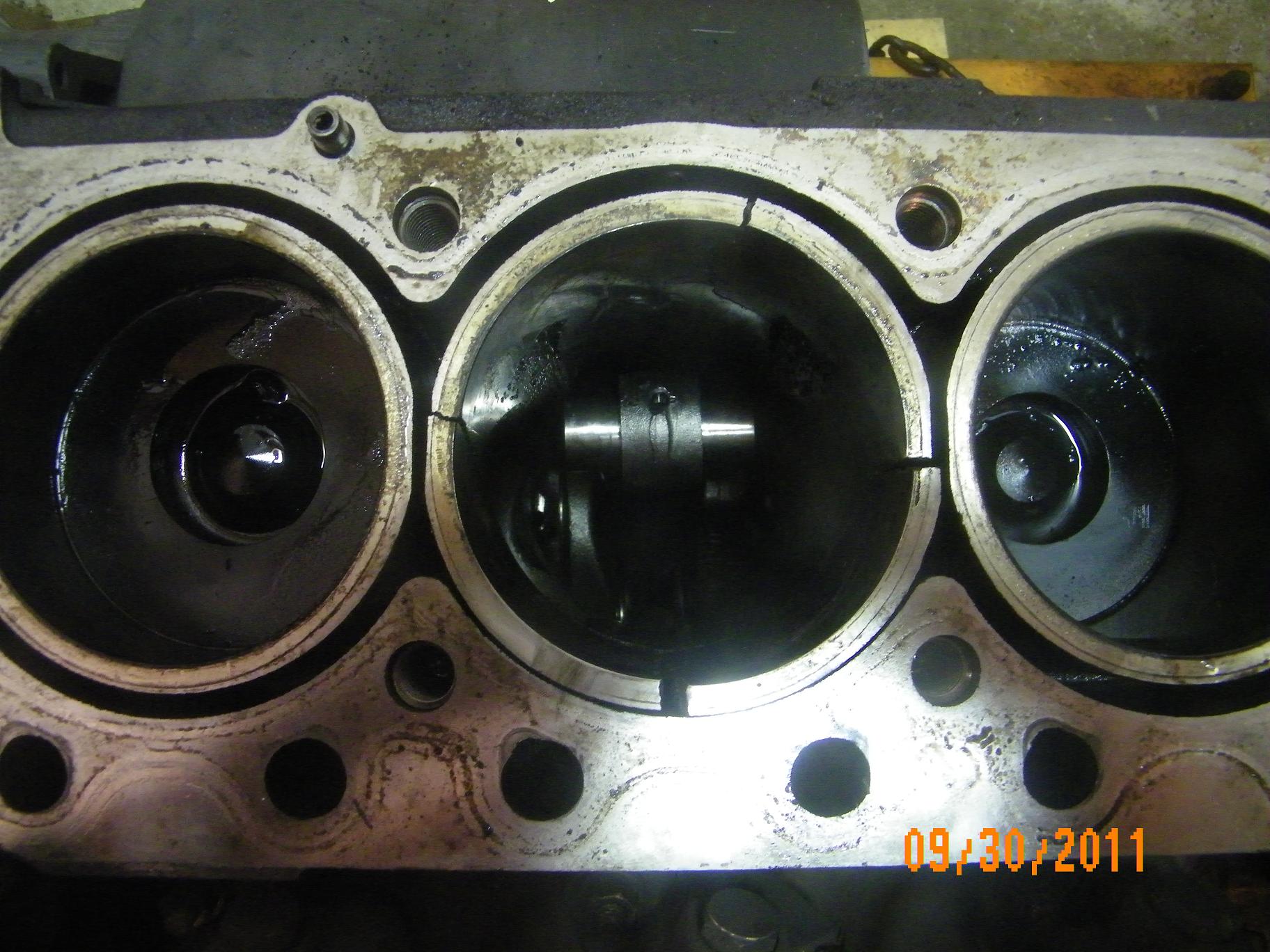

Here's the jist... 1) Block casting may or may not be usable... I can't tell if the liner in it (if it has one) has the block casting all the way to the top. If the block casting itself comes all the way up... then its bad... and simply getting a new liner will not do it. unless I custom design one... if it can be held by the base of the cylinder, or if the liner is held by the base of the cyclinder... maybe it can be repaired.
2) head casting may or may not be usable.... likely not if it was for normal duty or something someone had to stand behind and warranty.
I was hoping some one knew how the liner and block was designed. I do not yet have a shop manual (its coming)... I bought the engine on the potential to be rebuilt... Its ugly... but the jury is still out.
I will be using new parts to repair if the block and head can be salvaged. But to buy both and a full rebuild kit, or a short block and a head, would get a bit pricey for my more or less non-existent budget (by some standards). Sure an industrial unit that's costing a $100k a day in down time warrents a 7k new engine immediately... for a boat conversion to inboard, that's still in the idea stage only, its a "see what we can do with it". I'm in it for an entire $75, plus a tank of fuel.

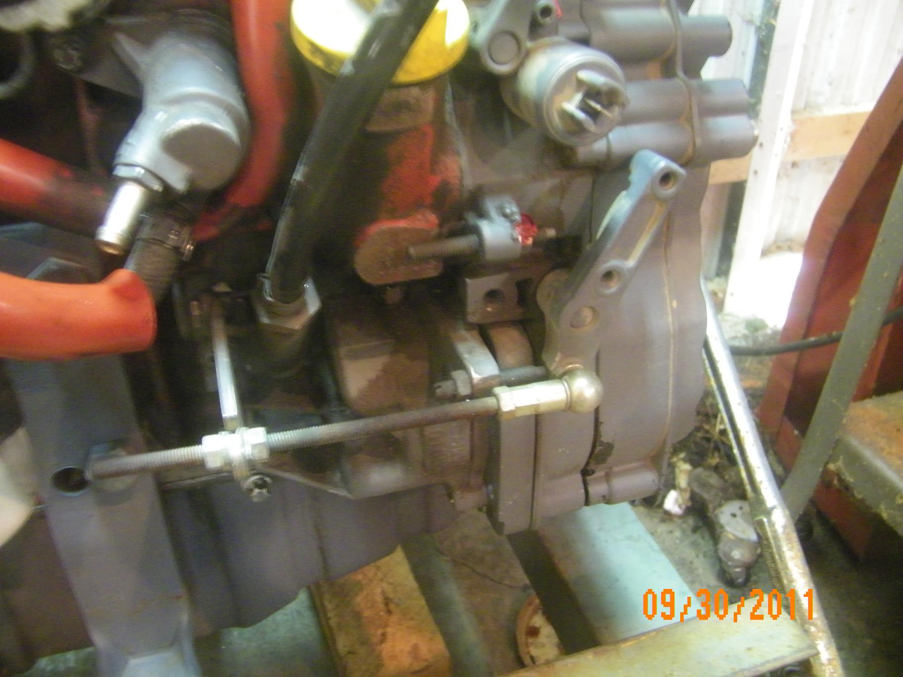

couple more pictures... strange to pull the head and look straight down into the pan isn't it? Never saw one loose its piston totally before. Seen them beat up... but still attached to the rod.
Since what I assume to be the throttle is locked in one position (see picture) that looks to be a fairly wide open position too maybe????, I'd say it had likely been on a gen set or other continuous high rpm application. Probably running unattended. High rpms and unattended... not a good combination, as you can see. The other three cylinders continued to do their thing... until someone heard it or saw the smoke and came running to shut it down I suspect. Must have made a **** of a nasty racket!

Regardless of how the block was designed (wet or dry liner), a wet liner can be installed, and it is typically only supported at the top and bottom. I had one done about 2 years ago and it was $100.
It's not unusual for valves to break, and drop down in the cylinder, and instant destruction of the cylinder.

If it has sleeves the block is a easy fix.Look at cyl from the bottom.This is usually the easy way to toll if it has sleeves. The bottom of the sleeve is machined and where the bottom of the sleeve meets the block there will be a line around the cyl.If the liner goes through the casting look on the out side of the bottom of the cyl for machine marks. You will be able to tell where the sleeve meets the casting. I would let a machine shop look at the head. They can magnaflux it and find cracks that you cannot see.
