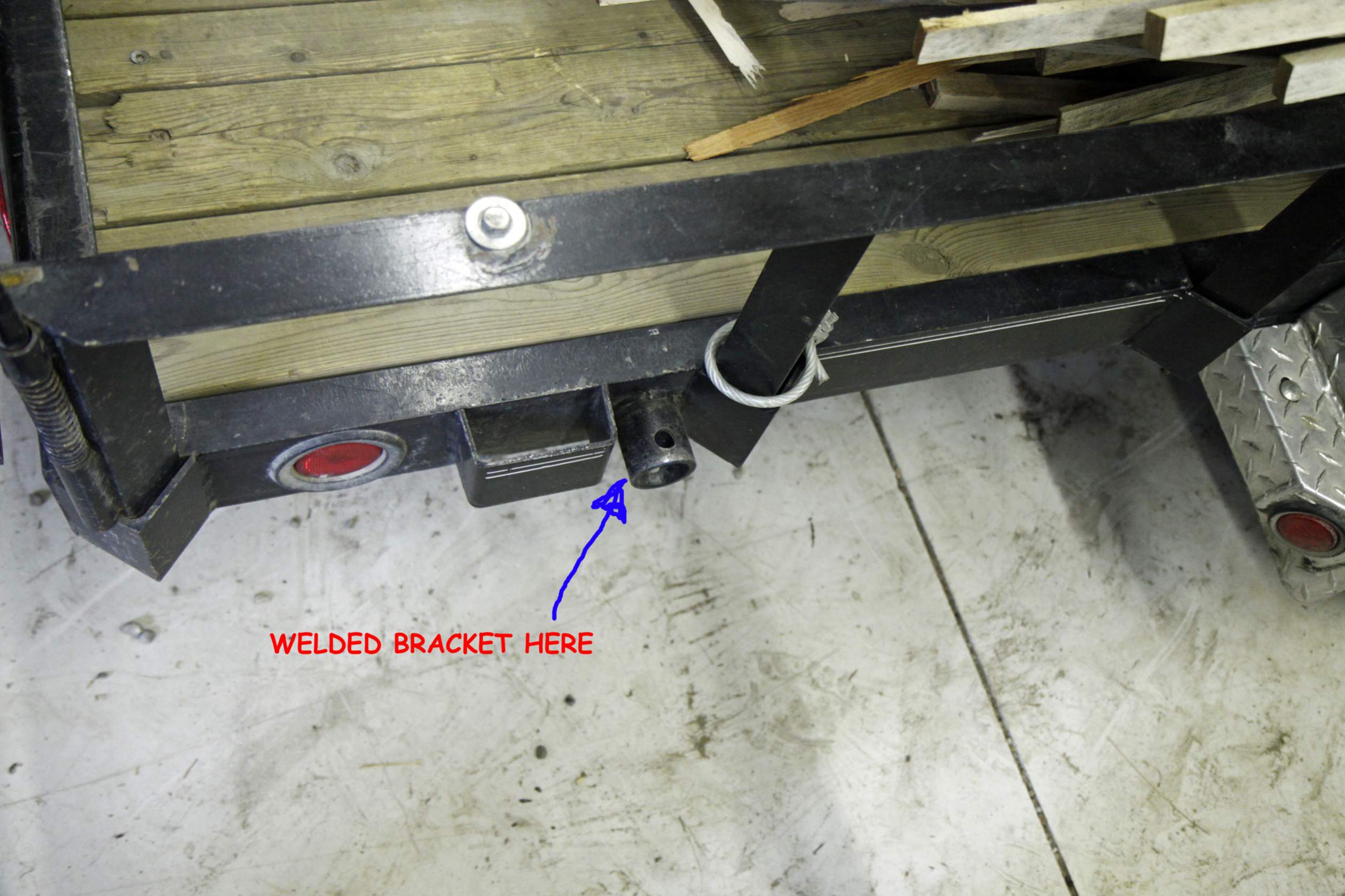

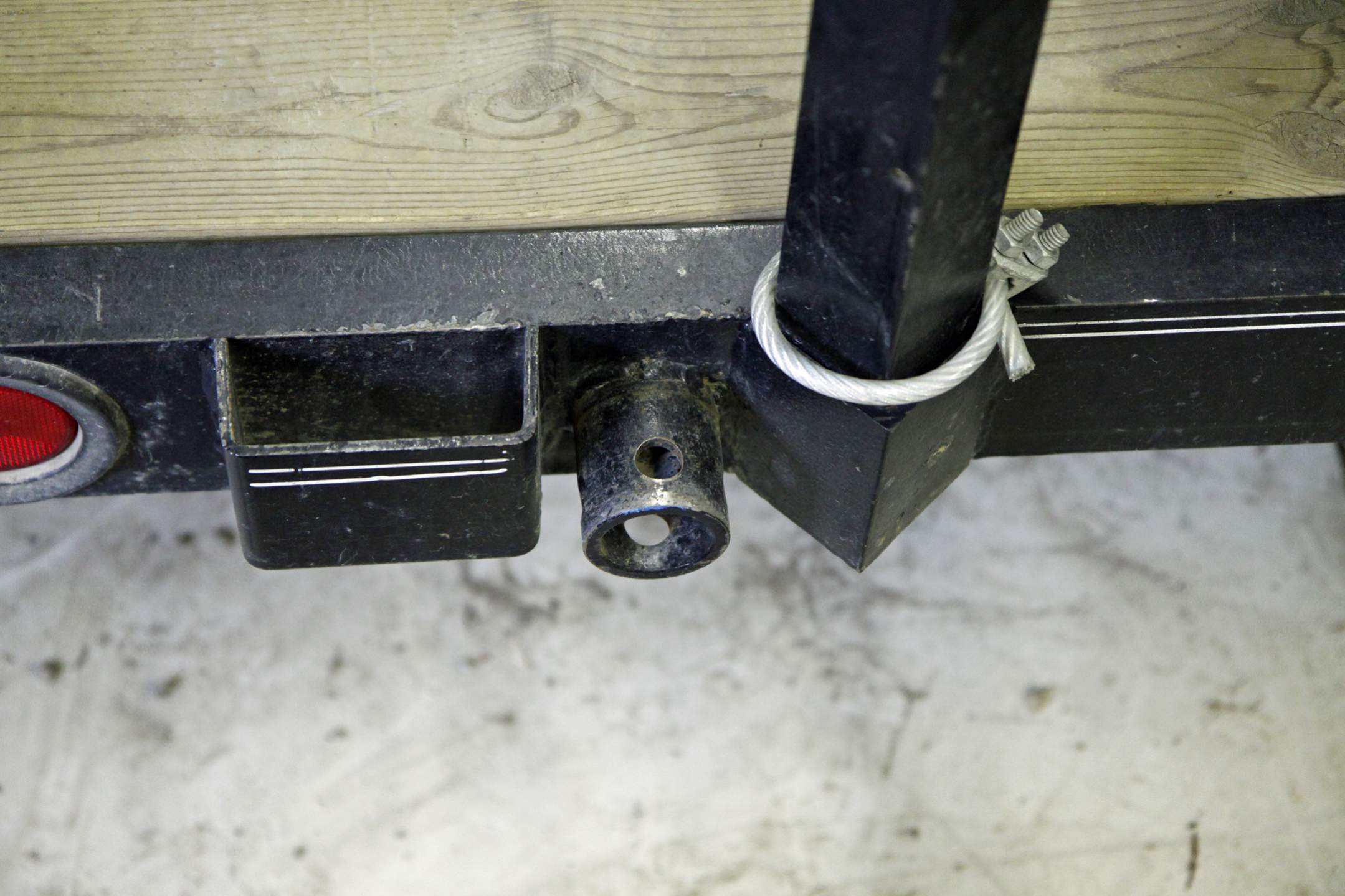

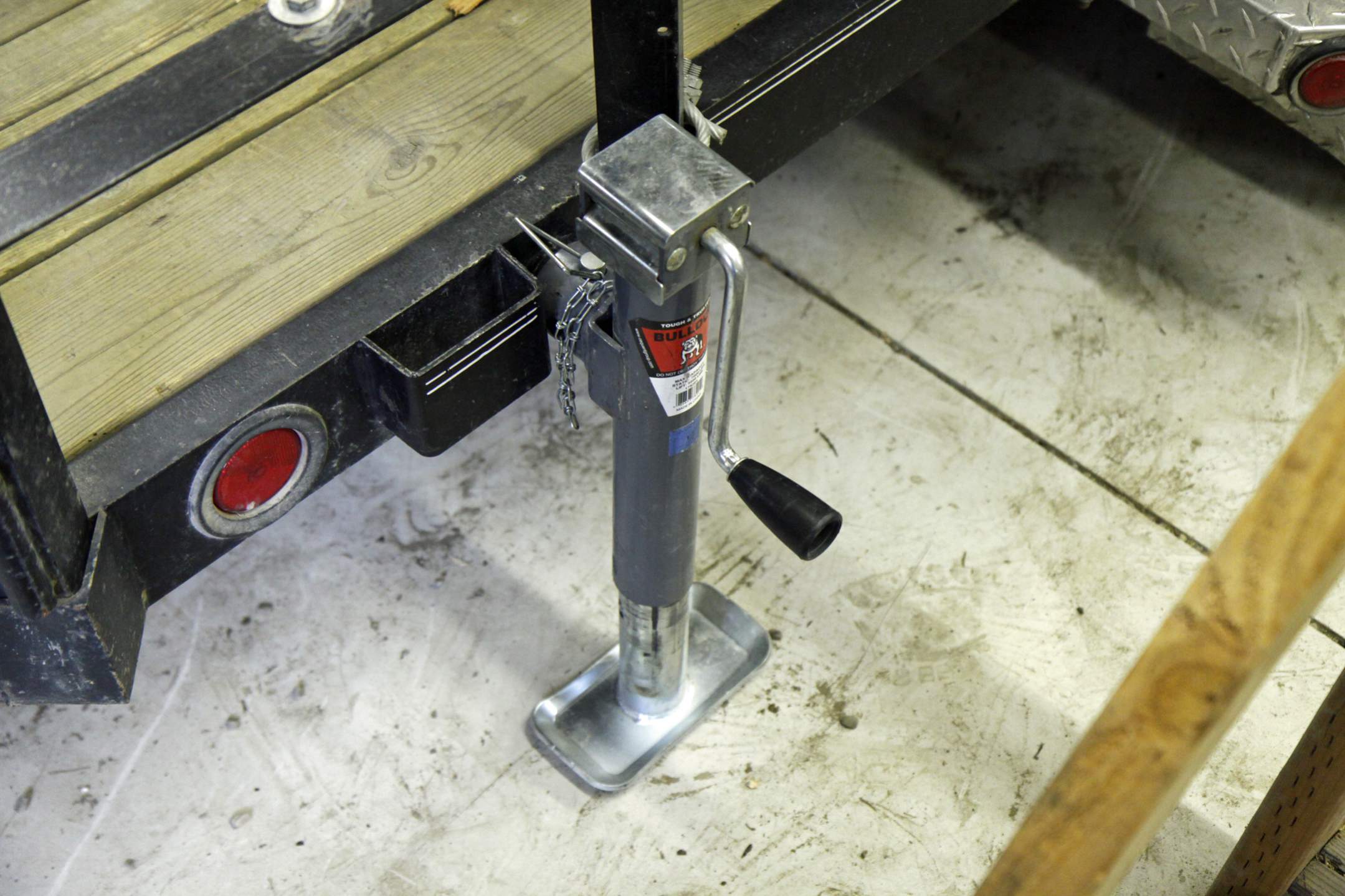

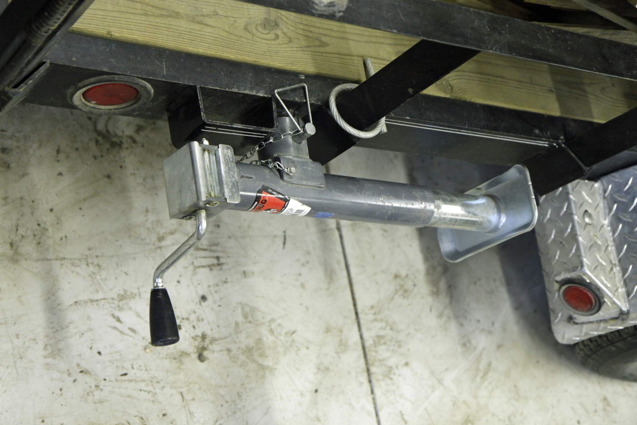

TRAILER BRACKET 1 copy.jpgTRAILER BRACKET 2.jpgTRAILER BRACKET 3.jpgTRAILER BRACKET 4.jpgI purchased 2 - 5,000 # trailer tongue swing jacks that came with a welding tube for my 16' trailer. Took less than 30 minutes to install... and work perfect. i can drive my tractor onto trailer without any lifting of the truck or bouncing of the trailer.
I can either swing the jacks up afterwords or pull the pin and remove them to prevent theft of the jacks.

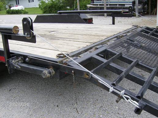

My 16' Woodworth has "loading legs", 2" sq. tubing drop-down legs that set an inch or tow off the ground until weighted. When loaded, simply back up to relieve the load & swing back up. Same thing could be bolted to an existing trailer with heavy angle iron. Cheap, simple & always there!
