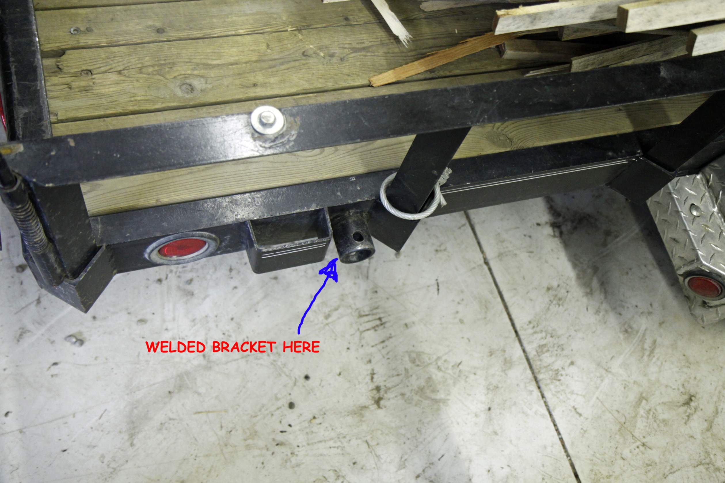

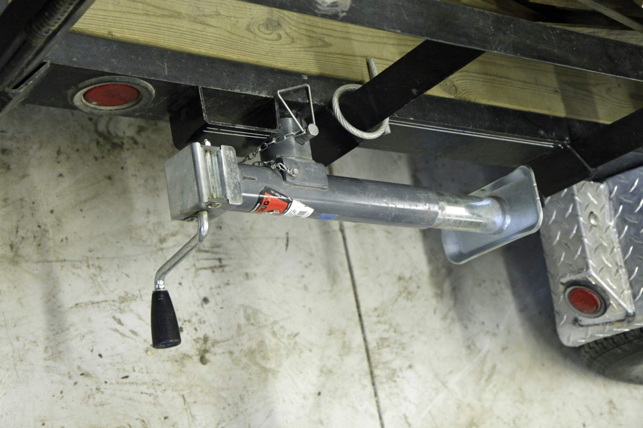

View attachment 271043View attachment 271044View attachment 271045View attachment 271046I purchased 2 - 5,000 # trailer tongue swing jacks that came with a welding tube for my 16' trailer. Took less than 30 minutes to install... and work perfect. i can drive my tractor onto trailer without any lifting of the truck or bouncing of the trailer.
I can either swing the jacks up afterwords or pull the pin and remove them to prevent theft of the jacks.
I have the same jacks for loading my B2910. One nice feature of this setup, is that trailer can be loaded/unloaded without being attached to truck. Just block wheels on trailer.
