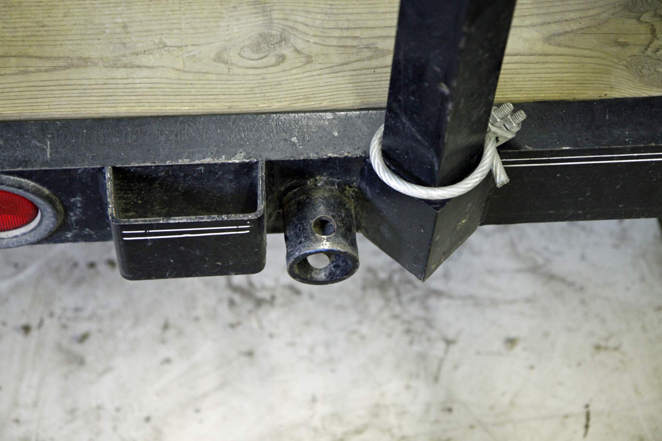

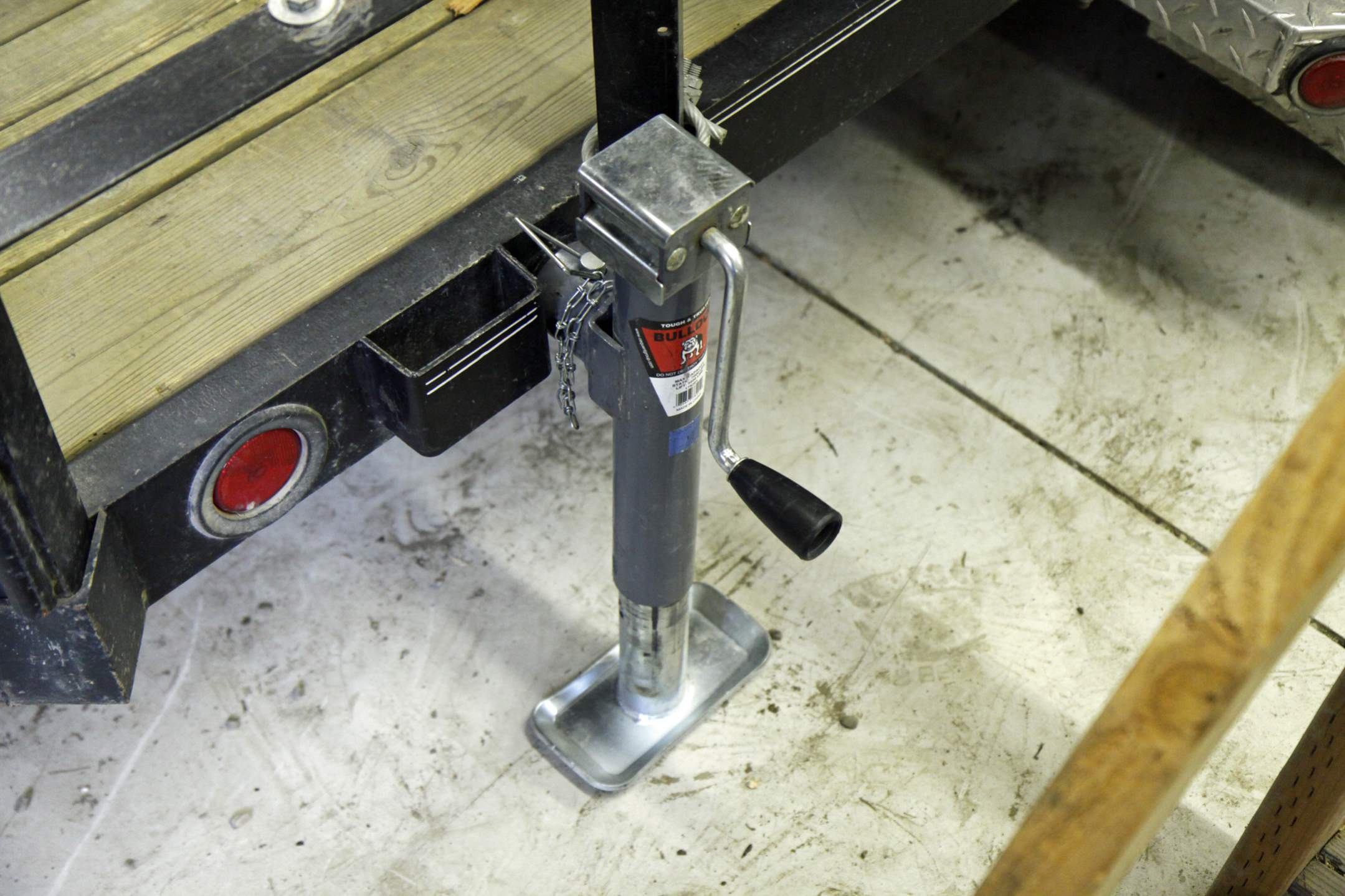

View attachment 271043View attachment 271044View attachment 271045View attachment 271046I purchased 2 - 5,000 # trailer tongue swing jacks that came with a welding tube for my 16' trailer. Took less than 30 minutes to install... and work perfect. i can drive my tractor onto trailer without any lifting of the truck or bouncing of the trailer.
I can either swing the jacks up afterwords or pull the pin and remove them to prevent theft of the jacks.
Exactly what I had in mind.
The dovetail on my trailer would allow the pipe to be welded, and the pins would let you raise the jack just enough to clear the ground, then remove, precluding a lot of effort to raise and lower.
Too, being able to take them off, removes one more "knee knocker" from getting around the trailer to tie down the tractor. Mine is a flat bed with stake pockets, which I decided on partially because it makes that activity much simpler than having static rails in the way of getting up and down to attached my chains and binders.

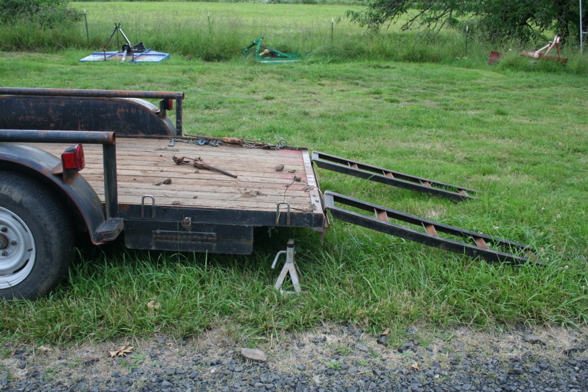

I highly suggest cheap jack stands for now.
When we first got the tractor, we were loading it on a slight grade; the weight of the tractor pushed the rear of the trailer down, the back of the truck was lifted enough to render the park brake useless. the truck and trailer started moving down the hill. Dad was smart enough to goose the tractor onto the trailer bed and everything came to a halt..
I bought dad a brake holding tool to lock all 4 truck brakes just in case.
we didn't start using jack-stands until we got the aft rail cutoff, then the trailer started bending during loading and we started using the jack-stands. We realized that with the jack-stands I can load the tractor no connected to a truck.
sometimes the stand gets stuck, just drive forward and let it tip over..
