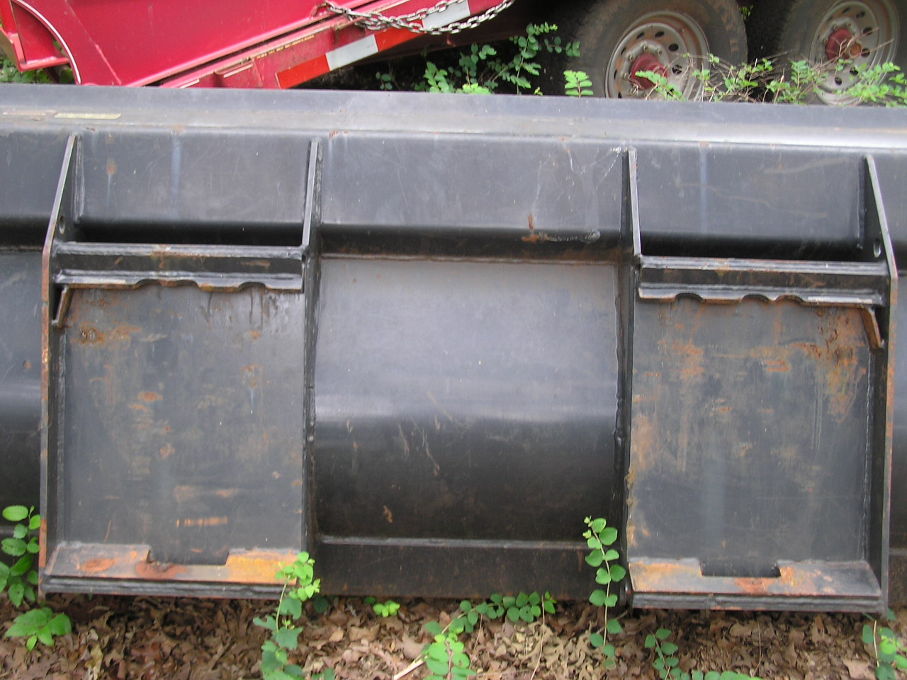

So finally had a chance to get some brackets made and get this thing tack welded together. Have run into a couple issues.
1. The handles won't stay up so I can get things attached. Working with Skid Steer Solutions on this.
2. I can get the Sheyenne boom and Construction Attachment forks to mount but not my Bobcat bucket or auger. It seems that the new quick attach will not slide up into the attachments far enough so that the pin can lock. It only does this on the Bobcat attachments.
Anyone had a similar issue?

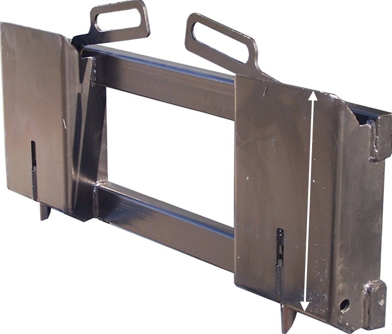

Here are the specs for the SSQA.
Check the top angle and length to the bottom bend.

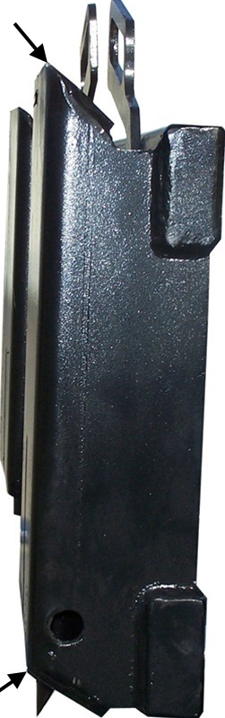

The critical dimension is where I added the arrows in the pictures, if too long the pins won't latch.
ET_UA_30_4__03739.1407974581.1280.1280.jpg ET_UA_30_5__07760.1407974360.1280.1280.jpg
The attachment plate should be flat against the front of the quick attach.

Where you have a 16" measurement for the face I have 15-3/4" which I think is too long still. Skid Steer Solutions hasn't been much help.

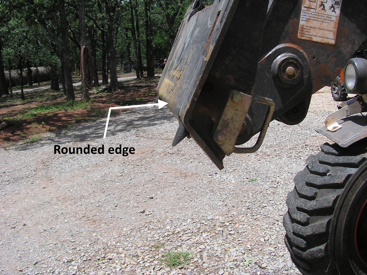

Here is my V417 quick attach plate, notice the rounded surface.
Your plate may have a sharp edge at the bottom, that would hit the weld on the latch bracket.
You can put the bucket on, look up from underneath and see how close the latch pins are to the slots.
I had to file the left side slot (where the grease is), so the lever would go down, when this bucket was new.
   / JCB 210S Skid Steer Adapter #29
Yes. Neither of the bobcat attachments sit tight against the attachment plate. The auger will not even sit down even on the plate. Kind of hard to look up and see if its hitting anything in the top. There is a 1/4" to the 3/8" gap at bottom of plate on the bucket. That makes me think the plate is too long.
   / JCB 210S Skid Steer Adapter #30
Check the width at the top. Maybe it's to wide and not letting the Bobcat attachments slide down all the way.
Put some grease on the top edges of the quick attach, then try the bucket. Remove it and look for grease spots to see where it was touching the bucket.
