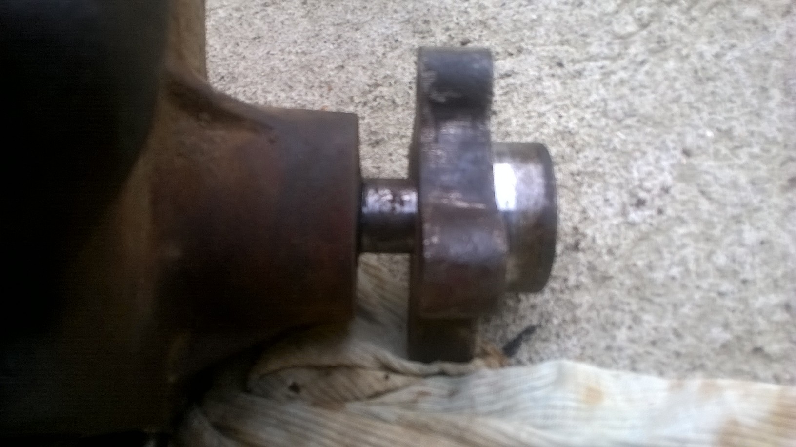

Hi,
now the water pump is broken... I searched the related posts, but I did not found yet, so I write here. I think that the JD9257 ball bearing needs to be fixed, so I have to dissamble the whole water pump. The ventilator axle is making buzzing and sturm - this was the cause that the ventilator fan was broken earlier. I am not able to accelerate with the tractor engine, because it is verry noissy. BUt if I remove the V-belt - everithing is working well, the engine is silent and I can accelerate maximally again.
So now I am obligated to repair again.........
I found a plastic ventilator fan, but I can not put to its place until I dont remove the water radiator from it.:eek:
   / JD 1020 power steering #94
JD9257 bearing, AR101549 seal, T30897 impeller, and new gaskets should be all you need. A pretty easy repair if you have a puller and a hydraulic press.
#95
Hi everybody...
I removed the water pump and I am going to disamble it... Which part should I start, what is the right order to disamble?!
First, I think should I remove the T30720 hub from the axle? But how, with hyd press because with bearing puller is not working.. Maybe I should heat it?! I dont have a hyd press, but I can take it to neighbour machine repair shop.
Than - the axle needs to be push forward, also with hyd press until the JD9257 bearing comes out?!
Or, what should I do? The new pump repair kit is ordered, but first I have to remove the old axle with the bearing!
Thanks verry mutch for the your accorded help!

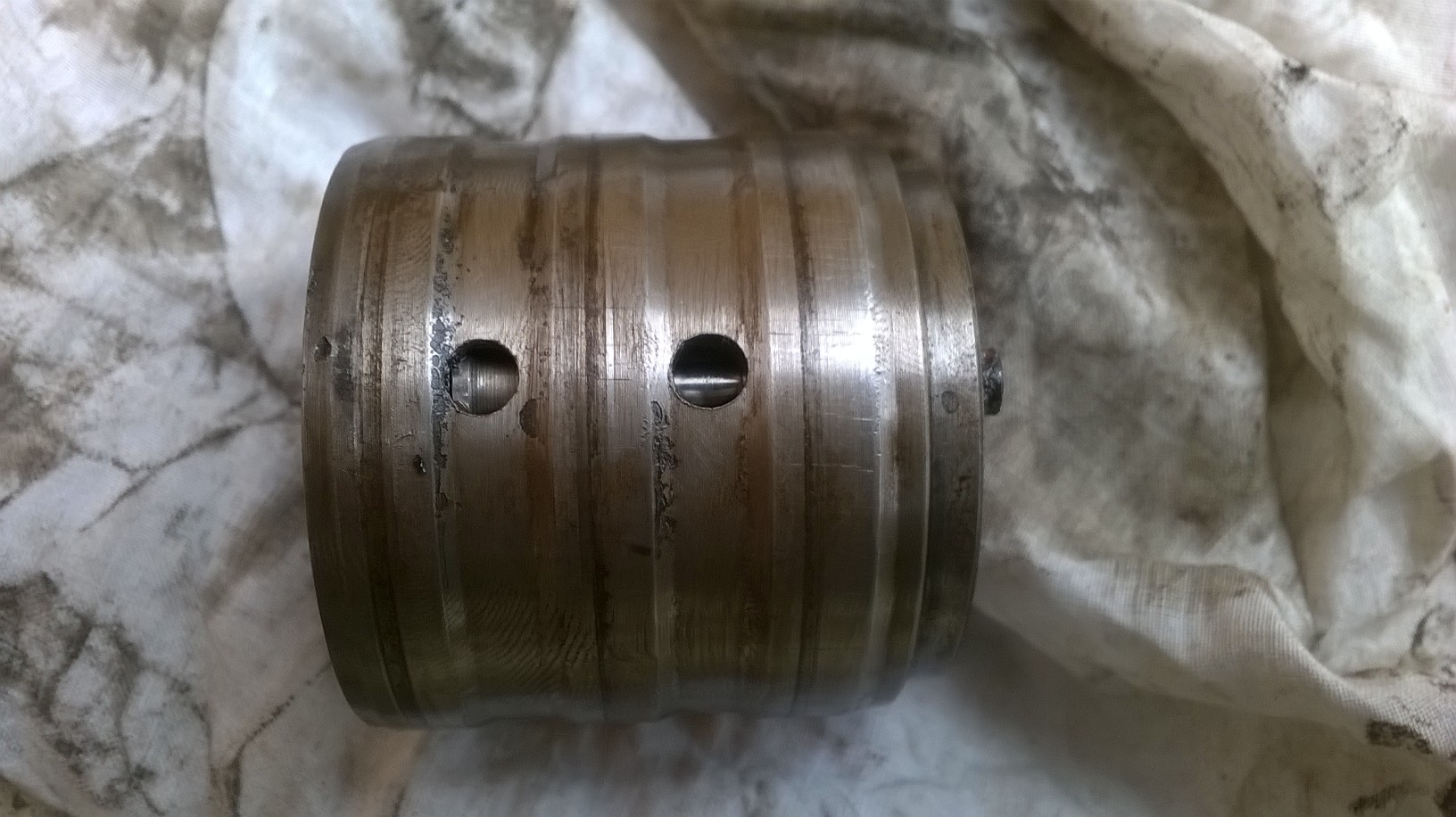

#97
Hello, JIm...
You had right - the valves on both steering control unit (AL26312 and AL26311) is stuck..... Verry tightly...dugattys.jpg
I dont understand why did it became both so tightly.... The end of the shift almost curbed..
