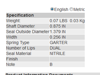

Hi everybody...
Please, give me the next JD piece exact sizes: power steering seal - T22260........... in mm or inches.... Its seems that the PS now is working, but the upper seal
T22260 is broken after few second...
Thanks....
   / JD 1020 power steering #113
Here's the spec's for part number T22260

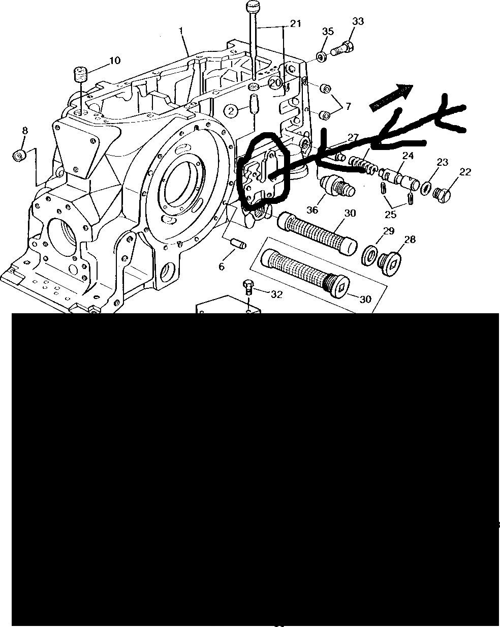

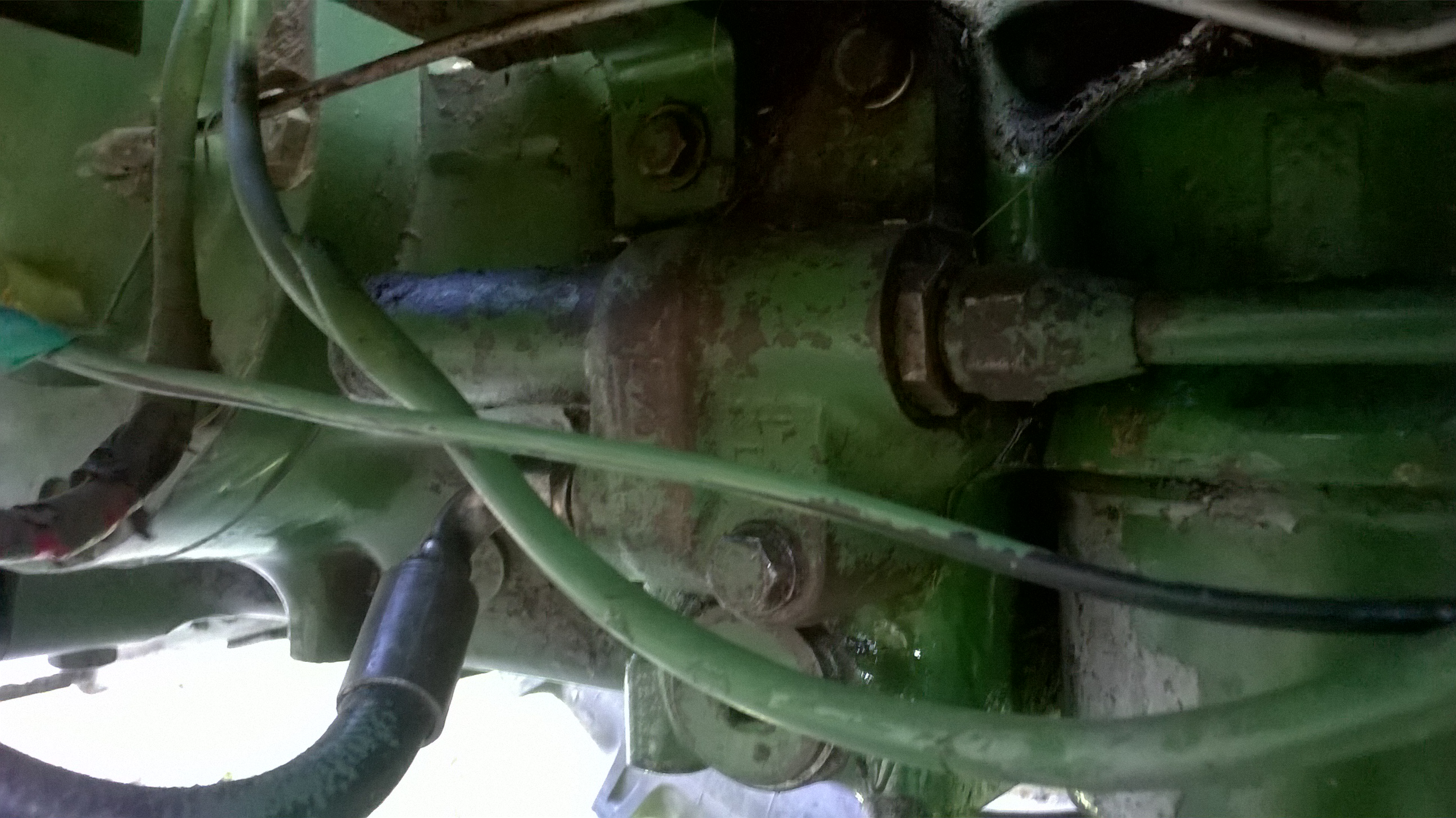

#114
Hi,
I have a new problem..... Under the tractor, behind the hydraulic oil filter case there is a piece, as show on the attached pictures... And from that piece the hyd oil is leak... But in the JD catalog parts I dont find this pieces name in english... and thats why I dont know what type of gasket should I use there.... Please, help me to identify this pieces on the online JD parts catalog.........................

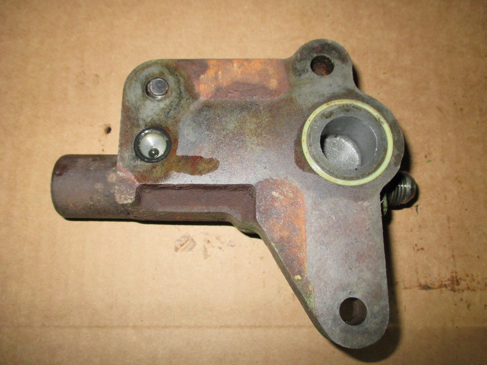

#115
Finally, I identifyed the mentioned piece, is the flow control valve - R39273...
After the pictures, it does not exist any special gasket, there are only two O-rings: a bigger one (the yellow one) and a small one, as you can see on the attached picture...
The problem is, that I am not able to identify the rings code. I searched in the JD online parts catalog, but there are more than two O-rings so I am confused....
After you - what are the codes of the two O-rings from the piece picture????? (U15415, or R26375, or T13119 or which one)??
   / JD 1020 power steering #116
The smaller one should be R28776 and the larger one should be R60332.

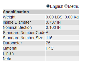

   / JD 1020 power steering #117

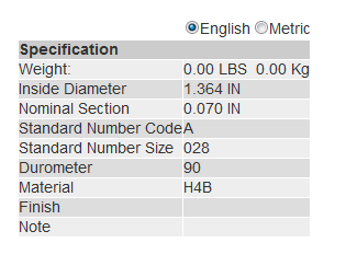

jd110
Although I agree that R60332 will fit correctly the parts catalog for historyan1975's tractor shows U15415 because I think his tractor was built for European sales.1st photo is spec's for U15415,2nd photo is spec's for R60332,3rd photo is spec's for R26375,4th photo is spec's for T13119
#118

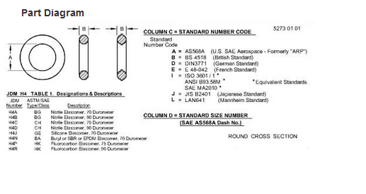

Hi,
than the R60332 and the U15415 o-ring are the same?! There are identic? An other question / I know the inside diameter but what does the nominal section mean? The o/ring thickness or what? From where should I found the outside diameter?
Or, the best it would be to dissamble first and measure it for the exact sizes with calliper-square? If the durometer is 75 and 90 that means that its a very durable (rubber) material (if I know well - the most durable is the 100 on the Shore A-scale)..........

Here's some more info on spec's
