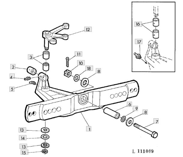

Hi,
I have a new problem with a stering arm from the front axle as you can see on the attached short video.
The triangle shaped bellcrank is clicking very much on its own hole/caliber.
What could I do?
I suppose I should repair/replace the bush between the stearing arm pin and the caliber/ or I need a pair of new needle bearing acording to the photo?
Thanks, Benedek J

   / JD 1020 power steering #165
Whether your 1020 will need bushings or needle brgs on bellcrank shaft will be determined by tractor serial #. Bushings up to SN _-062660 & needle brgs SN 062661-

Thanks.. On my tractor I cant see the serial number plate.. But its made in 1972, theoratically the serial number sholud be starting from the number 134700.... Am I right_?!
According to your advice I need to buy the needle bearing?
   / JD 1020 power steering #167
How did you determine your 1020 was built in 1972 without having access to tractor serial #? Did you look on RH side of trans case for serial # tag? I agree 1020's built after mid-1968 should have needle brgs in this application.

#168
I have the original tractors papers from Germany (register, stud book).
