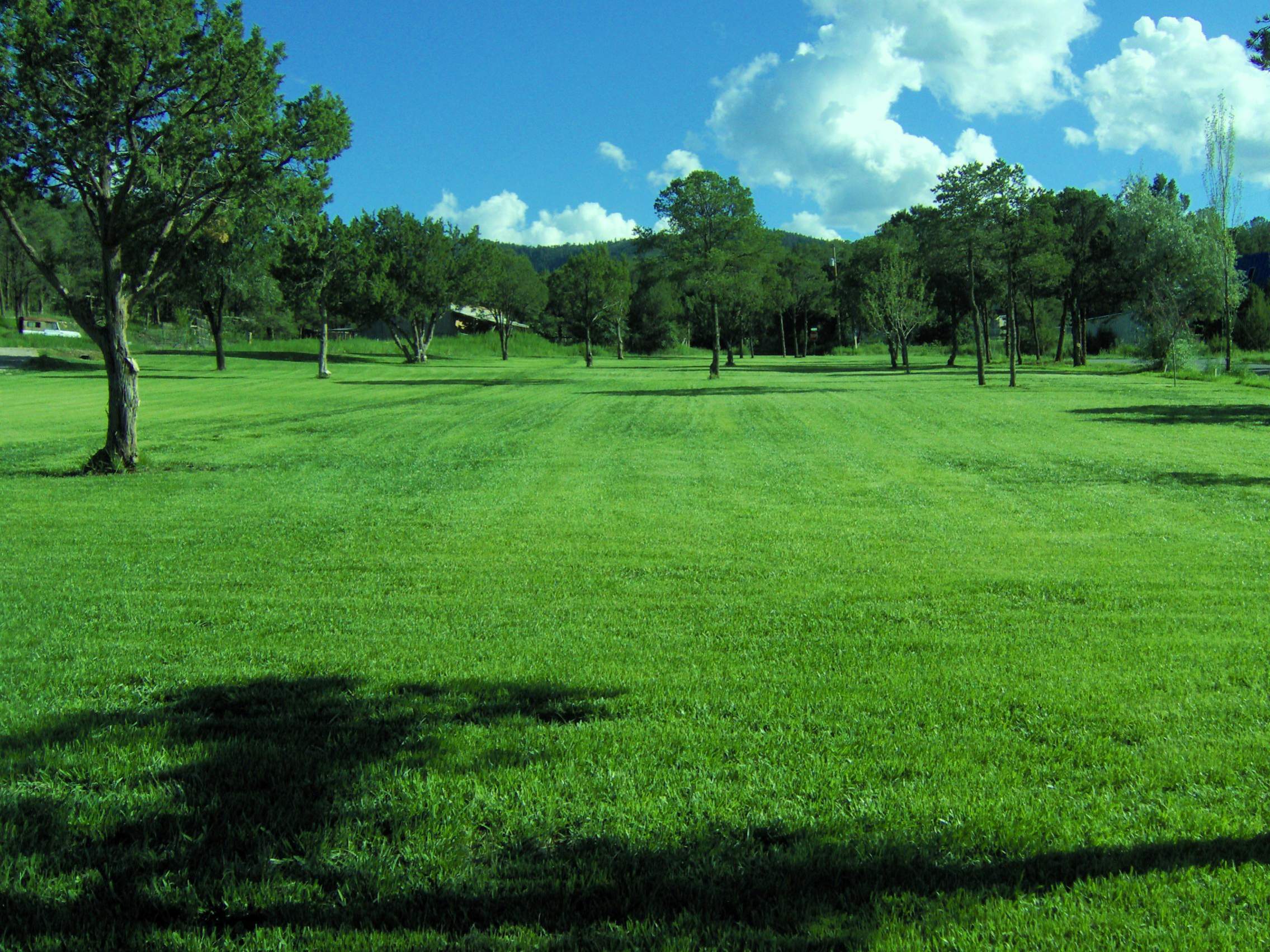

I think I would rent or hire out a larger tractor to clear and put in the lawn. Then buy a garden tractor or subcompact to mow the lawn and handle small maintenance jobs. I use my 4520 and 110tlb to clear and put in lawns and do most of my lawn maintenance with an x749. Once you put in the Fescue lawn I don't recommend you drive heavy tractors on it for routine mowing. Periodically I use my larger tractors to pull an aerator across the lawn but most of the time lighter mowers will handle all the grass related jobs.
I can till, smooth and plant a 2 acre lawn lawn area in most cases within 2 to 3 days. Clearing varies with the density of trees and stumps that need to be removed but average another 3 days. So in most cases about a weeks work, hardly enough to justify buying all the equipment.
For lawn maintenance you will need a good garden tractor/mower, pine needle rake if you have these to deal with, pull behind seeder/fertilizer spreader for routine applications and possibly a collection system. An additional tool that would be very beneficial would be a good aerator, more important to have for the lawn than a small fel. Best I can recall it is pretty hilly around Huntsville but if your lawn area does not have too much slope a ztr could be a good choice for mowing. I personally prefer the garden tractors with 3ph because they can handle a variety of attachments from tillers, landplanes, box blades, rear blades, landscape rakes and collection systems. I don't find a fel to be needed to maintain a nice lawn, further the ballasting and weighting of a tractor for safe use increases the machine weight. For the cost of a small fel you could hire out the major portion of the lawn prep and clearing work. For this reason I am not a fan of the scut/fel/mower machines.
Here is a picture of my Fescue lawn, I try to keep the larger tractors off of it as much as possible and use the garden tractor and riding mowers to maintain it.

Dammmmn...that's just braggin'. Beautiful. :thumbsup:

Looks like a friggin golf coarse,nice job jenks
