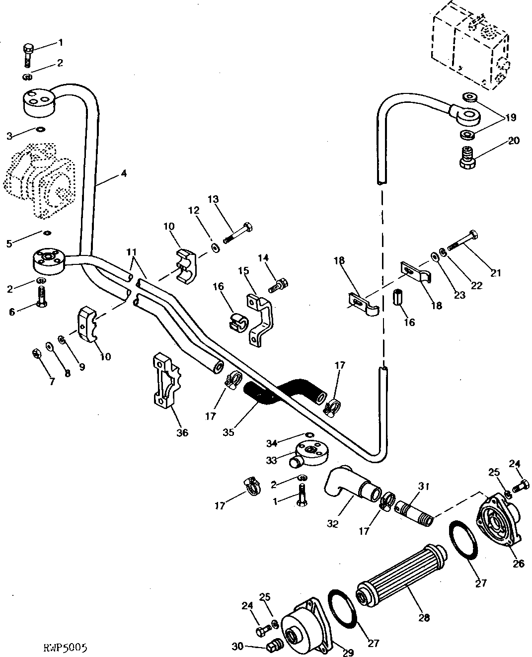

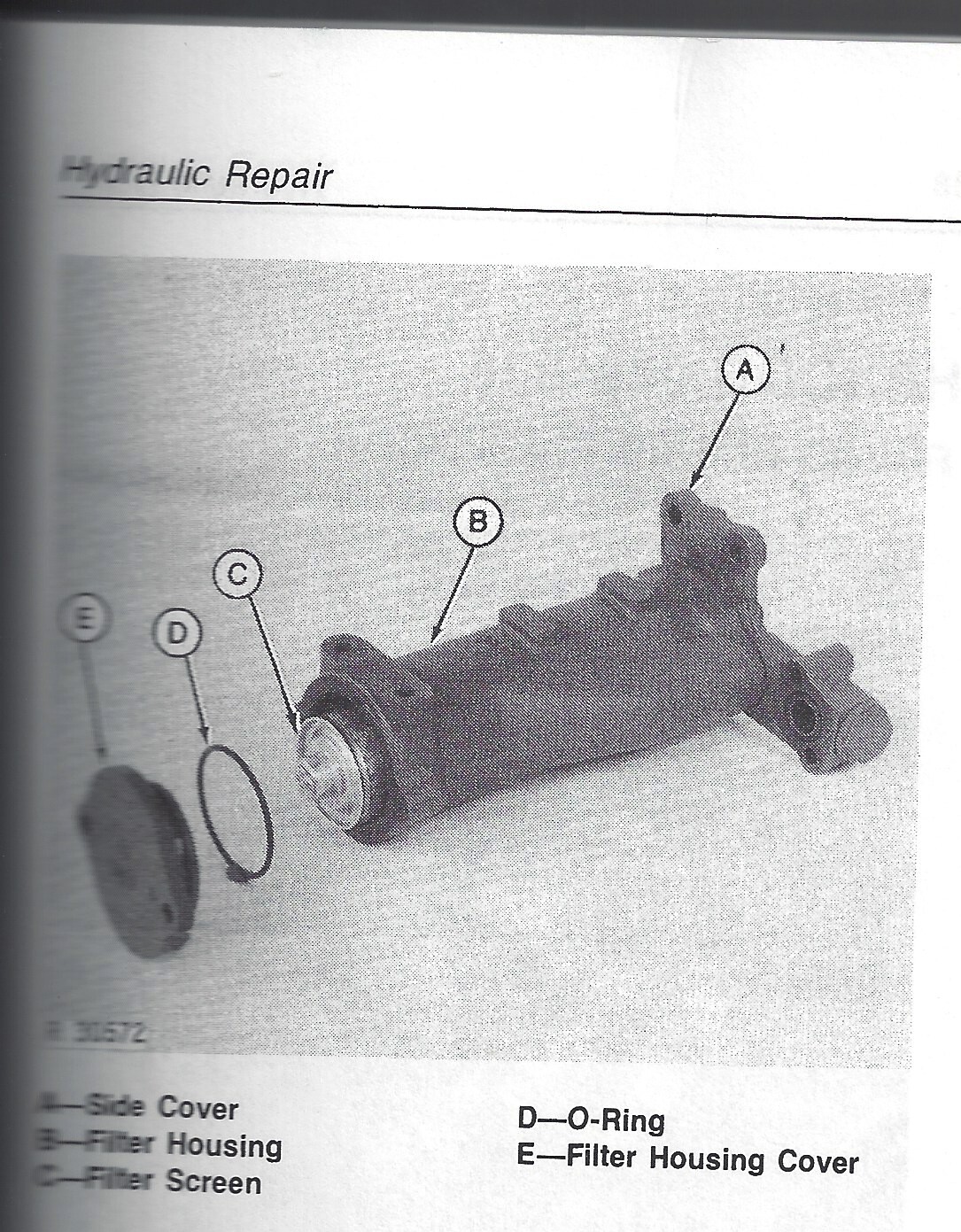

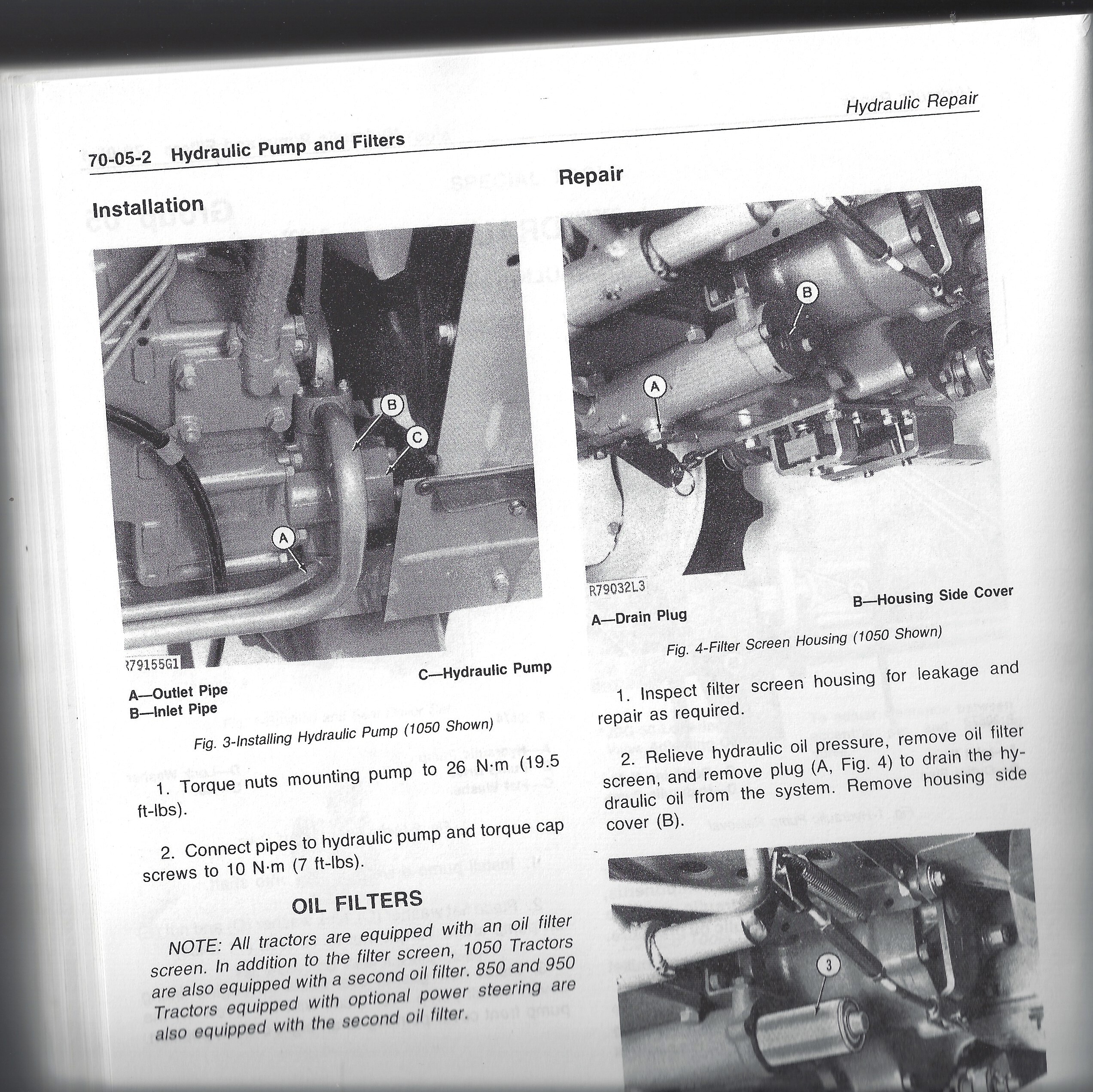

Not being open center, there won't be a hydraulic pressure accumulator. So about the only thing left is some sort of restriction to or from the hydraulic pump. Offhand, I can't think of another brand of tractor that had a cleanable hydraulic filter, but all of the Yanmars did. In addition to the spin-on replacement filter, Yanmar/Deeres had a cylindrical fine screen suction filter that could be cleaned periodically. Look under a triangular cover about where your right heel sits. (on the left on some models).

Hopefully these help the OP to know where the suction filter is located.
