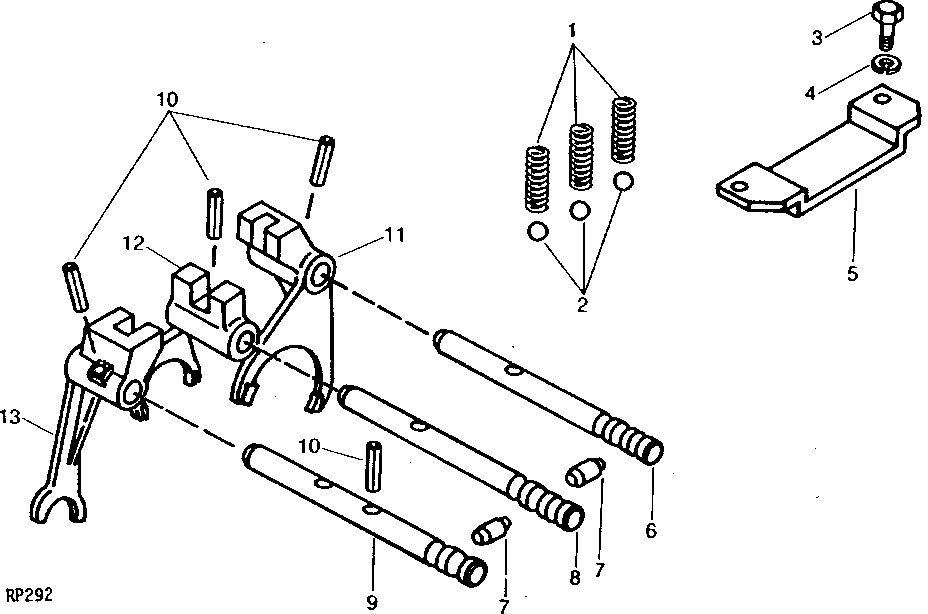

Jun 16, 2012 / jd 1050 reverse #2 B BATTY54 Silver Member Joined Jul 6, 2000 Messages 228 Location Western,MA Tractor JD 850, L130, 317 It may have a bent fork in the trans. Attachments RP292__________UN01JAN94[1].gif 13.1 KB · Views: 190
Jul 4, 2012 / jd 1050 reverse Thread Starter #3 OP B brownie1 New member Joined Jun 1, 2012 Messages 4 Location centerton, arkansas Tractor john deere 1050 The forks were alright but it turns out that the spring on the bottom of the shifter handle was broken. Put new spring in. Fixed problem.
