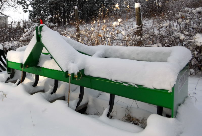

Well Friday I removed the hoe from the 110 for the first time and even with the Laurin cab section mounted it was easy using AK's method. Thanks alot.
Top and tiltkit and 1284 boxblade
Afterwards I found all the pieces and mounted the top and tilt kit, I set it up so that forward and backwards on the joystick rolled the unit front to back on the top link, I used the left to right (curl) to tilt it side to side and the third section A/B to operate the toothbar. Seems to work well but I need a bit of practice :D to say the least.
Hooking up to the heavy ***** box blade was easier than I thought. I first pinned in one side, then the top cylinder, then I used the top cylinder to push and pull the box blade into position to pin the remaining lift arm. This approach gave me the minute adjustments needed to pin in the last arm.
