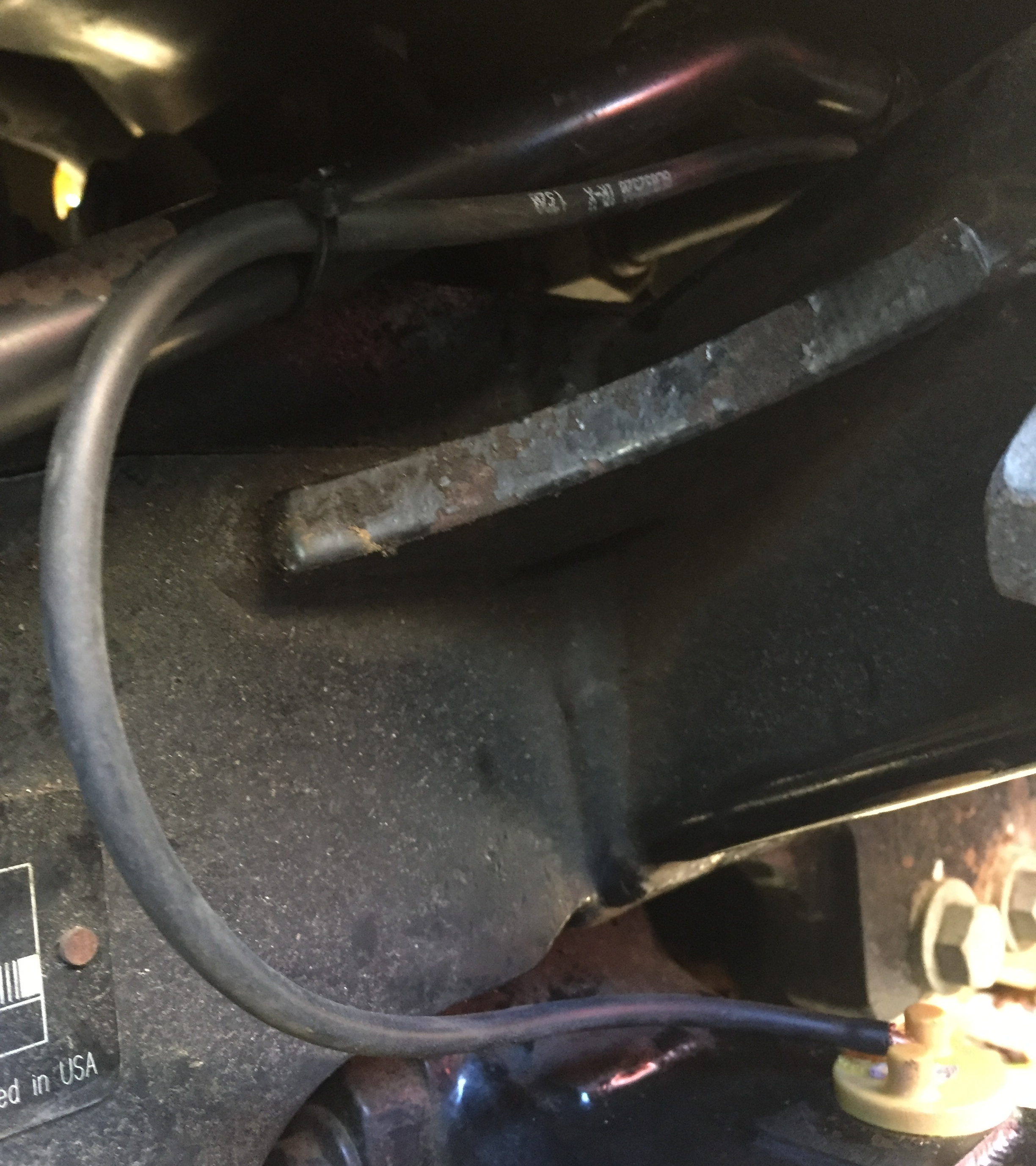

Completed project previously mentioned...drilled straight down fill plug and then in from side with 1/8" drill. I then cut a 90 degree section of old copper windshield washer squirter nozzle and seated into drilled hole. I then packed cavity with RTV. Lastly, i ran a piece of windshield washer hose up under the RH engine bay side cover and attached hose to hydraulic line, end aimed downward.
