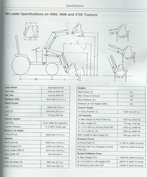

Like I have said I pull all my numbers from what I give my customers the brochure. It lists in the brochure the weight of tractor at 7600lbs. And by the way if it is by obmission that manufactures mislead why is it that Kubota is no longer stating lift capacity at pivot pins on the lit? Not to say they are misleading here but maybe telling the truth at 2200lbs rated lift capacity. QUOTE said:
Being around for too long sometimes answers some questions, it was only with the introduction of the deere 4000 series for a marketing advantage that the pivot pins became a measuring point and the ASAE standard was ignored by them. For a short time many where fooled about deere's sudden major increase in lifting ability until they got out and worked them and found no advantage or increase over the rest of the market. Before that it was in the bucket at the mid point for decades which is hard to judge but does include the weight of the bucket and load in it. So which manufacturer really was misleading? How many of your customers don't have a bucket on their tractor? Does the whole industry have to change for one manufacturer?

Art, nice to see you're still around too! All these brochures and such are hard to figure out. I would like to post a pic of the JD 460 loader specs and you can tell me how it compares to the Kubota LA853 lift specs. It's kind of hard since Kubota is fairly vague on at what height specs are recorded.
By the way, I was using the specs for the LA853 from Kubota's website.

Billy, it looks like if anyones was hard to read it would be Kubota's! I started out to look thru the boxes of old literature that I have to find the one that was ever so lacking and misleading when there was a switch to the pivot pin in reading the jd literature but yet they didn't disclose it when the rest of the industry was using the ASAE standards of in the bucket. The mid height range for load is new and is just becoming a point of reference and I believe that comes from the skid steer market. Could it have been a mistake? Possibly but when the company that has the highest investment in marketing for the last thirty years in this industry does it, doesn't it just make you wonder?

This is off Kubota's web site.
http://www.kubota.com/h/products/l39Specs.pdf
Kubota's Web sheet states lift at pins is 2767 Lbs and 2200 At bucket bottom mid point.
I should point out 500 mm from pins is past bucket midpoint which is a realy vague dimension. (Actually it is not a dimension, is it?)
Has Kubuota restated the capcities in a new brochure?
I figure lift at bucket edge is only 1500 Lbs at as delivered pressure setting. The loader has been a disapointment, expecially in curl force.
