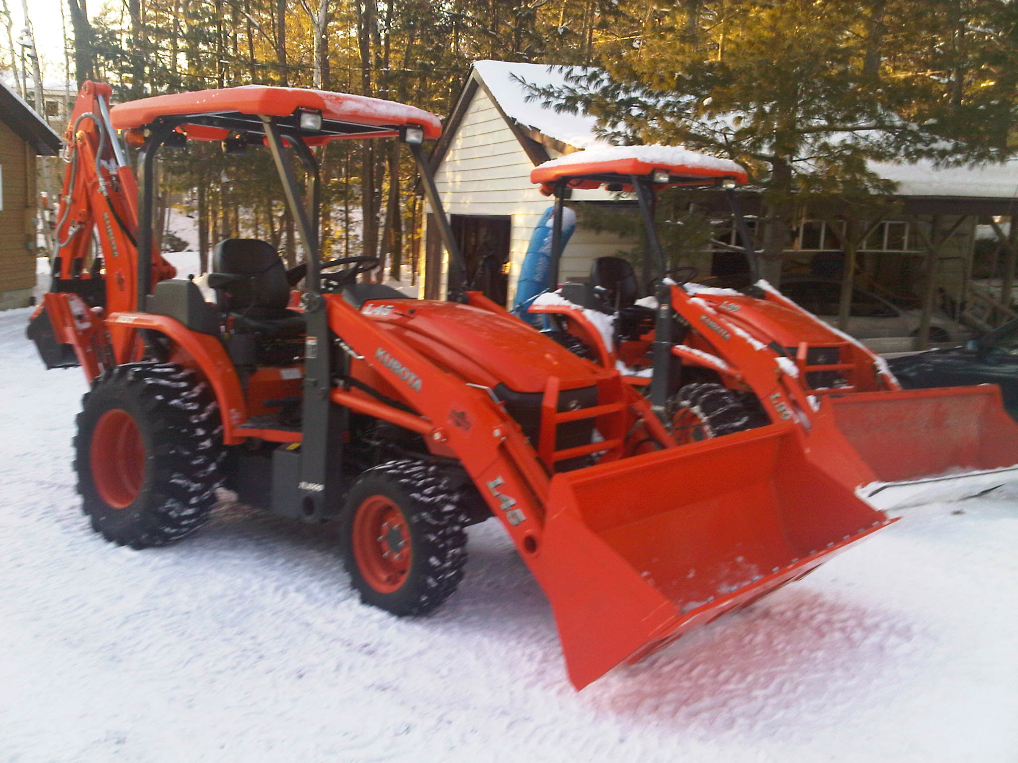

You could look at the Kubota L39 and L45. I believe they both spec out about the same or a little better than the 110. I have a L39 and use of a brand new L45 and love them both.
