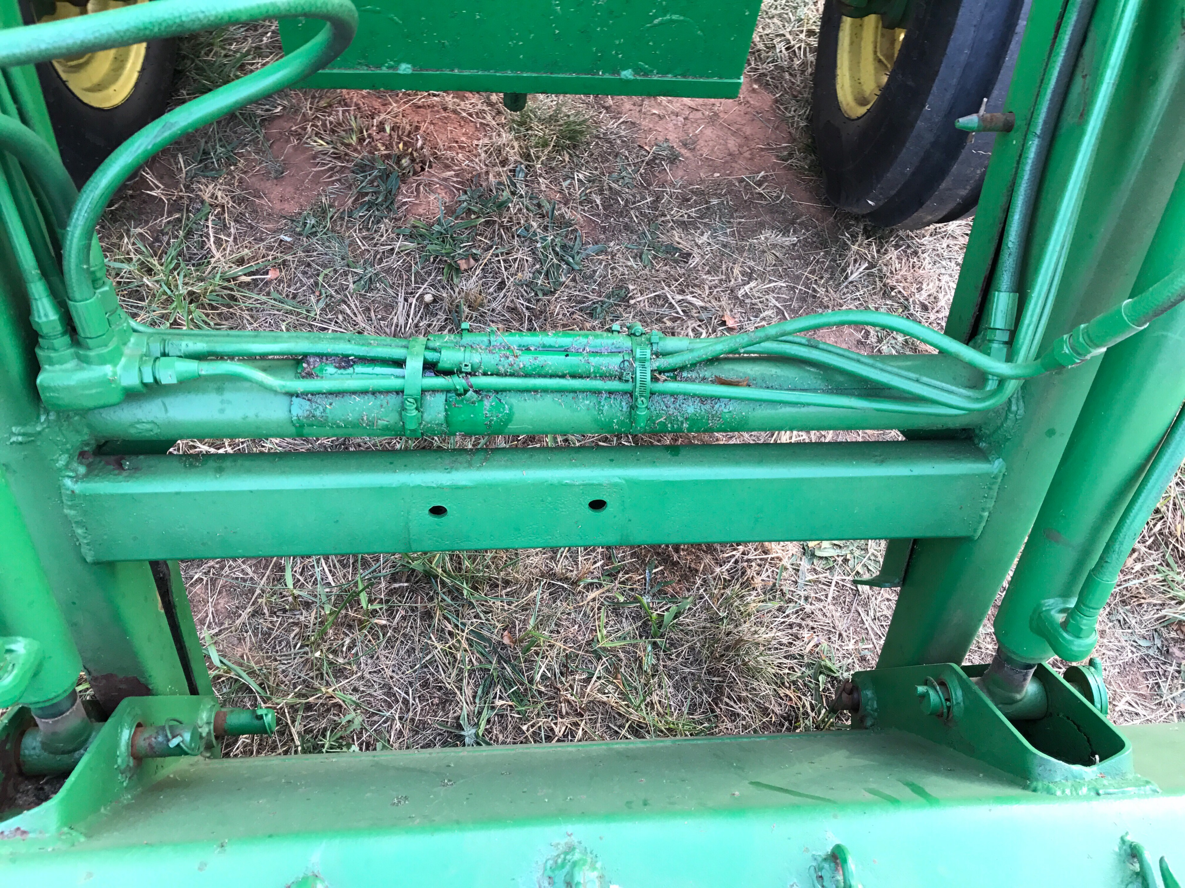

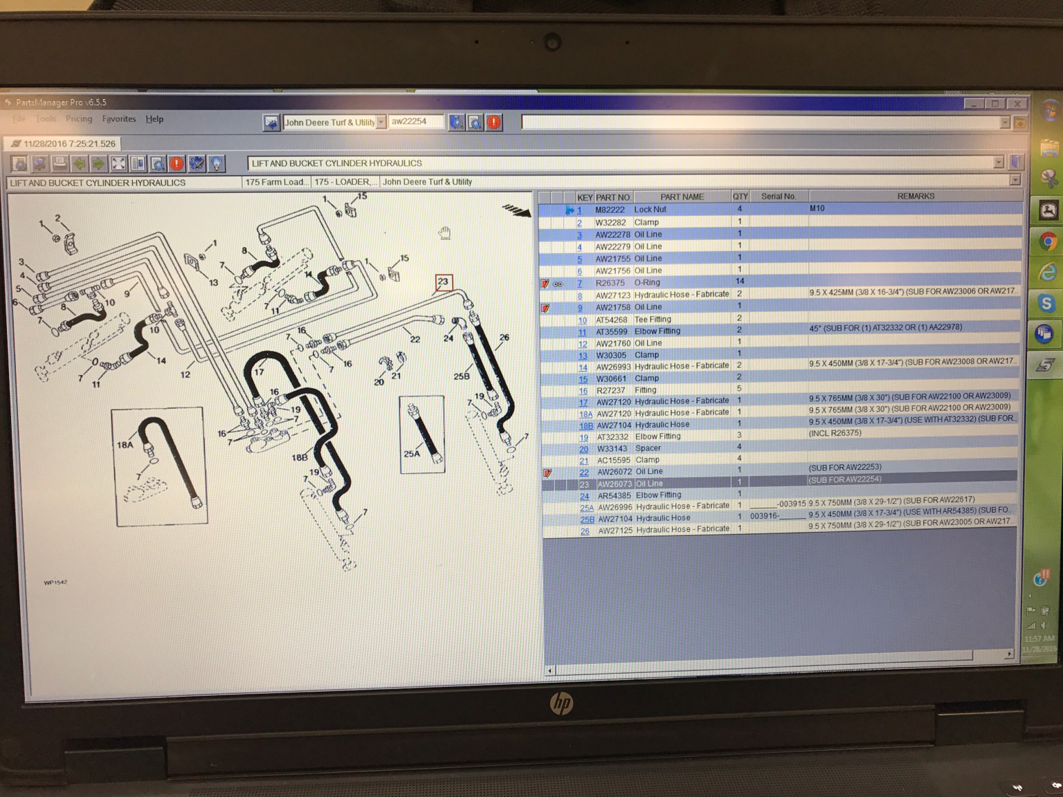

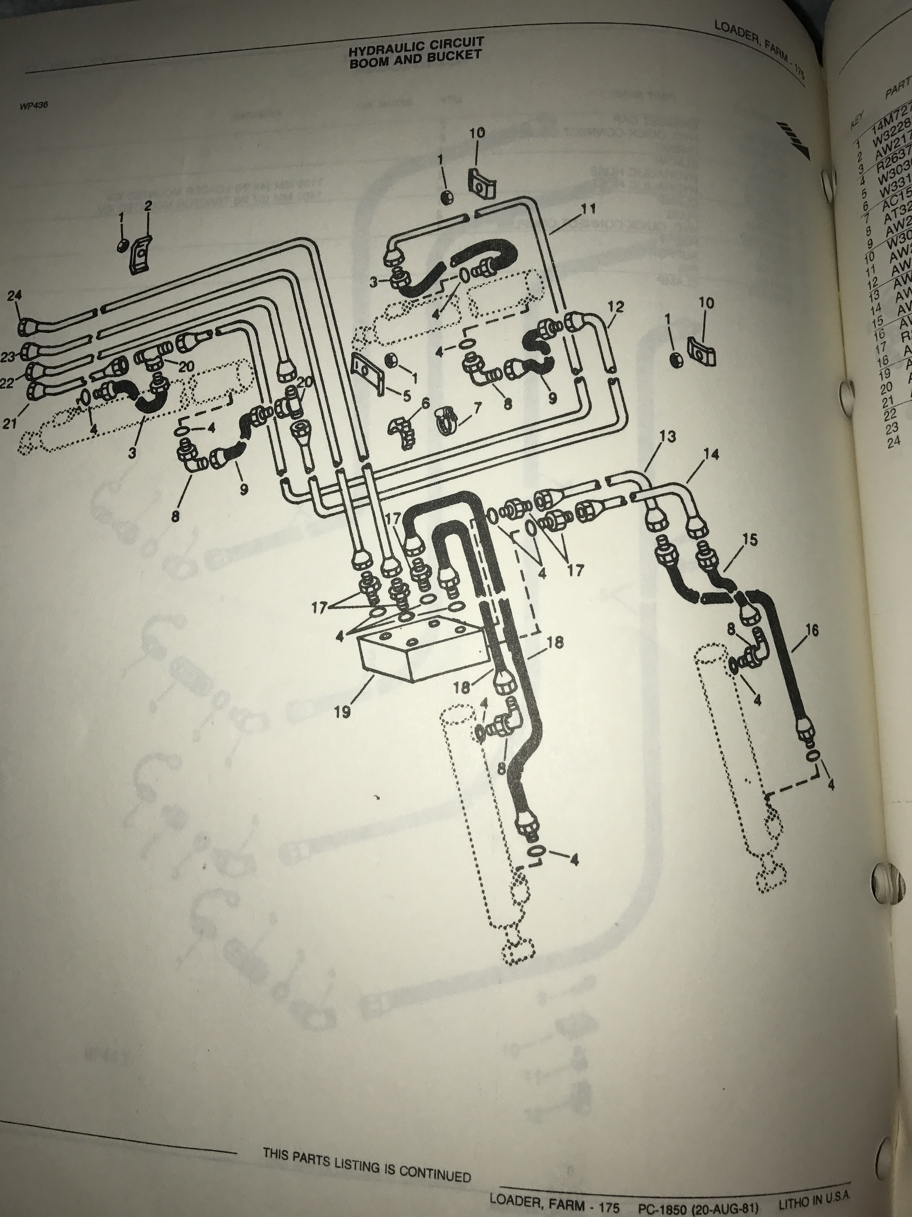

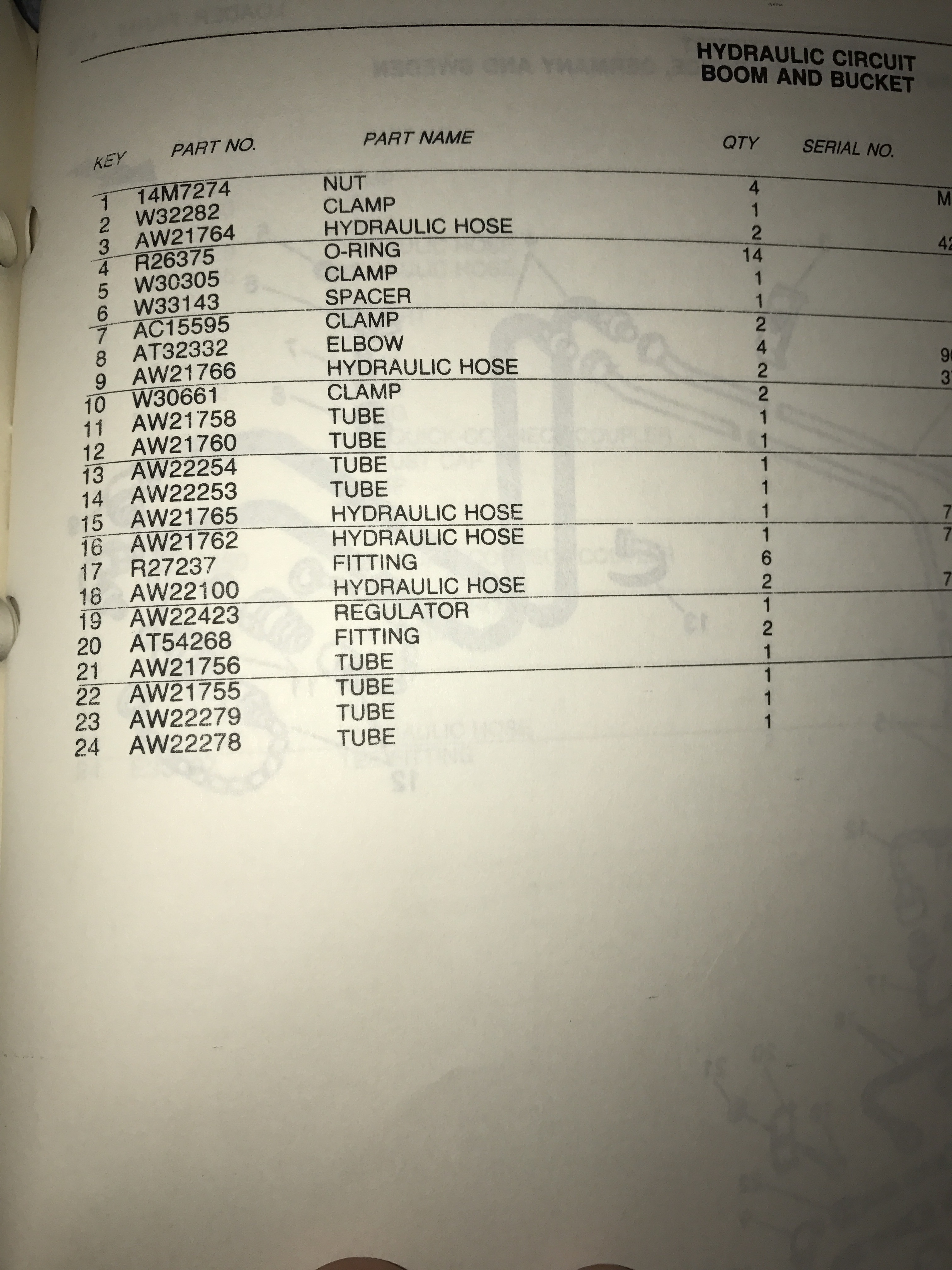

I have a 175 loader on my 2155. I bent a rigid hydraulic line yesterday while moving some debris around, which resulted in a hole and a nasty leak. Item #13 seems to be obsolete.
Does anyone know of an alternate PN to AW22254 (other than AW26073)? I might just have to have a line manufactured but I figured it's worth asking.

Picture I have is a bit different but same part #. Looks to be obsolete like you said. I'll check one more source for you and see if we get an answer.

Here is a picture of the line that is damaged.
It is the middle line (behind the one in front) which got bent and twisted by a branch on the right (left on tractor). The twist made a hole under the hose wrap.
Yea it's obsolete unfortunately. It will be fine if you get a regular hose made for you. Don't need to go back with hard line.

Ok great. That was going to be my next question. I'll just find a flex line and replace it with that.
Thanks for chiming in!

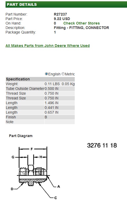

Would your software be able to tell you what the thread size is on the fitting (#17 on the diagram)?
The flex line will probably come with male/male ends. I'll probably have to pickup some unions to make it all work. Maybe remove the fitting from the regulator (#19) and flex hose straight into that, but then will still need a union to connect to the other flex hose (#16).
Would those be 3/4" fittings?
Are these the spec's you need?
