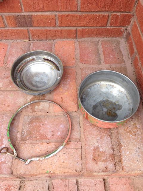

I think photo from 2020 parts catalog will be closer to correct air cleaner than the photo spanner posted for an oil bath AC for 2030 built for Spain sales. The mess screen isn't designed to be removed to clean. To clean mesh one needs to submerge canister & mesh in solvent as a unit.
the 2020 diagram Tx jim submitted is spot on... unfortunately i believe he's correct "to clean mesh one needs to submerge canister & mesh in solvent as a unit"

Actually one doesn't have to submerge canister in solvent to get mesh clean spraying with solvent then blowing with compressed air will suffice but submerging will get it cleaner.

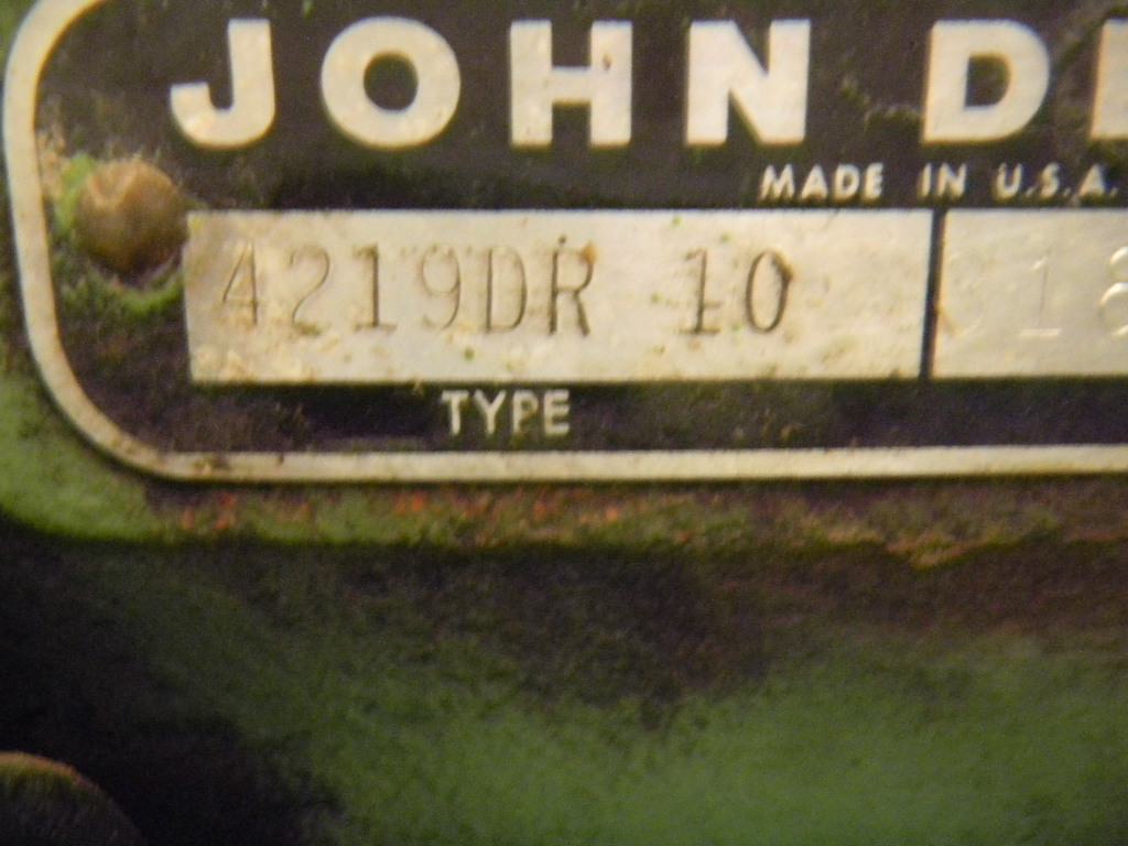

That's because I'm nearly 100% positive it's not a 2030!!!!!!!!!! Read my #4 post on this thread Z5 does your 2030 have 4219 on engine SN tag?
Yes my 2030 has 4219 on the engine S/N tag

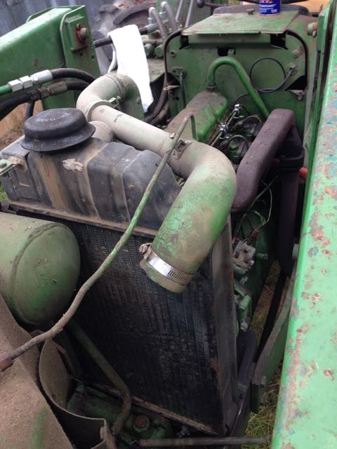

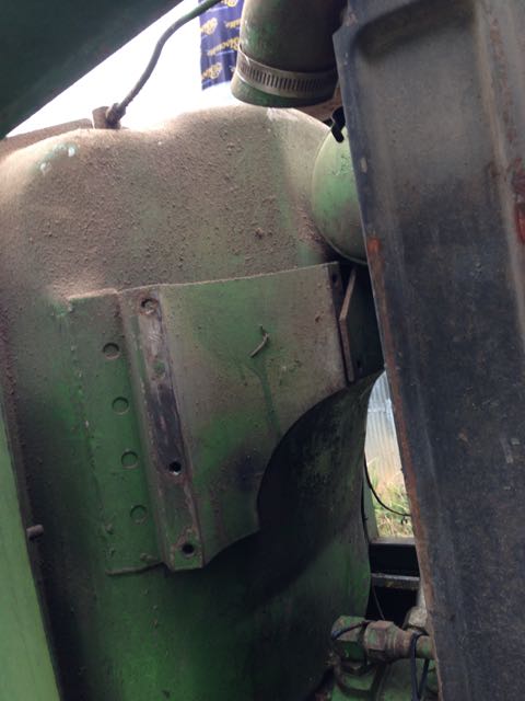

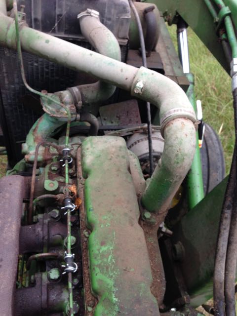

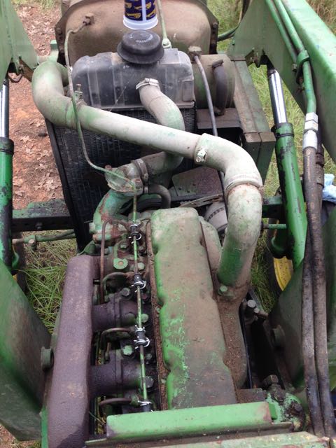

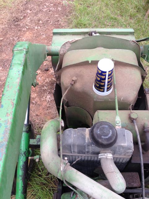

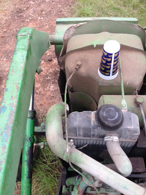

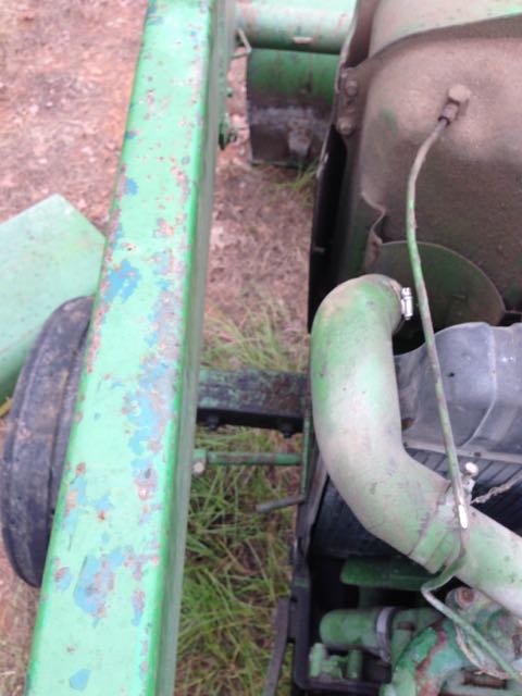

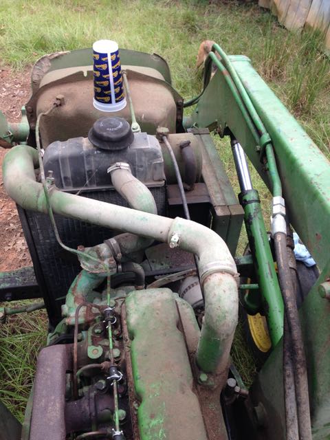

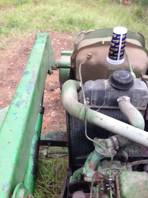

Yes, but the Air Intake pipe plumbing is different for the various engines. A picture of the piping layout would help clarify matters?
here is some pics of the piping and area of course oil bath air cleaner is off....
   / JD 2030 Tractor SERIAL #? #56
Good pics!
The significant items to me are the High-Rise air intake at the manifold end and the single bend hose connecting that to the cross-pipe.
Does tend to look more like the 2020 set-up than any of the 2030's :scratchchin:
   / JD 2030 Tractor SERIAL #? #57
Good pics!

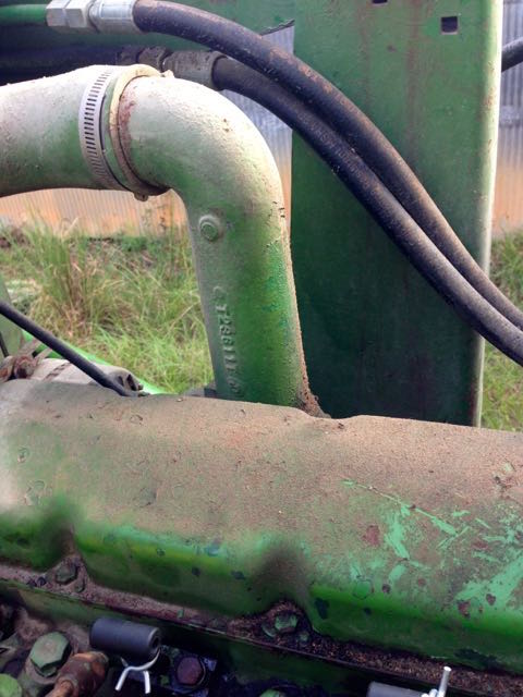

Air intake pipe(T23611) appears in both 2020 & 2030 parts catalog.

looks like this is a 2020 by the numbers... maybe it just has a 2030 hood?

Tach cable attaches to RH side of flywheel housing under battery box & drives from end of camshaft. I agree I have thought it was a 2020 since near the beginning of this thread.
   / JD 2030 Tractor SERIAL #? #60
It does. But, I think my thinking was - it doesn't get connected to an oil bath on a 2030, unless it was built in Spain ?
Whereas it does connect to an o/b on the 2020.
