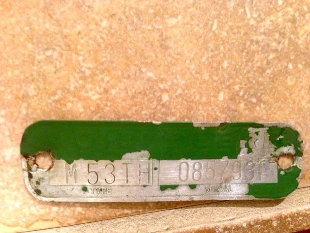

Engine serial # is: M53TH 085793T

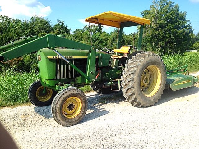

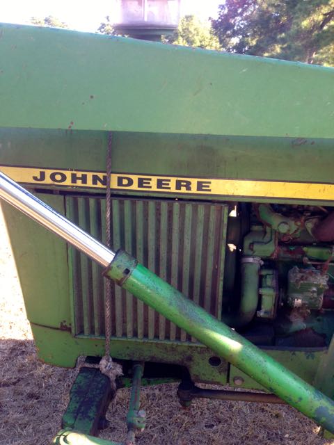

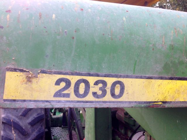

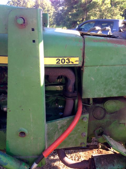

....some identifying photos and any serials i could find

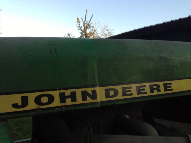

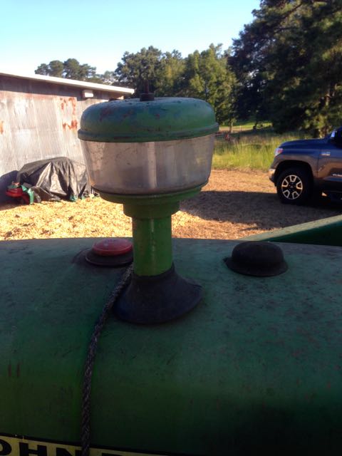

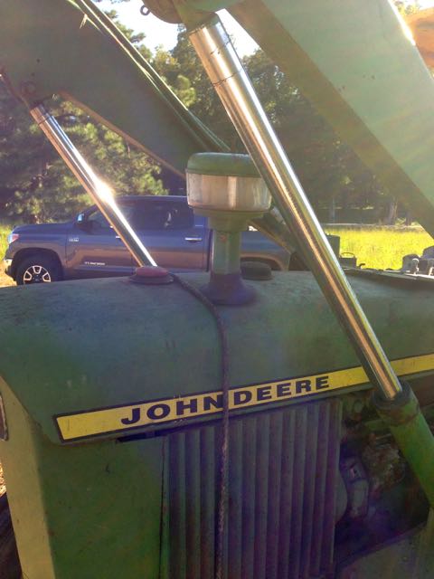

is this air intake on the hood common on a 2030?

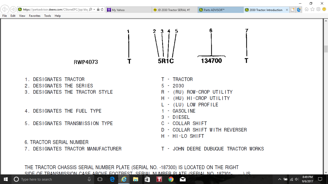

I was thinking INCORRECTLY that CID of engine was on engine serial # tag. T21411 casting # is on both 2020 & 2030 rear axle housing BUT R55011 engin e block casting # only shows up in 2030 parts catalog. Engine could have been changed as engine SN appears very low at 085793 for a 2030 since they were only built for 5 yrs because SN break I find in 2030 PC is at 248,000. Where is casting # T23611(your last photo) located as I don't find it on rear axle housing?

i went to the local JD dealer to get parts. some parts fit the 2030 some don't.... the JD rep was a confused as some of you.. one guy called it a "gray market 2030"

Parts catalog shows the pre filter stack, but I have never seen one on a 2030.
I've never seen a pre-cleaner on very many JD 20-55 series utility tractors either.

air filter is not in the usual place (maybe w/ the air filter stack) and i had a broken Fuel Injection Return Line T Boot which is rubber and the parts rep said those on 2030s are usually metal?

Two different air filter elements: AT20718 used up to S/N 190319, AR84228 after S/N 190319
Pre filter should not have made a difference. It attaches to the metal tube on the filter housing and the hood will a hole for it to go through.

casting # T23611 is on a pipe right above the engine that flows to air intake area.... see pic

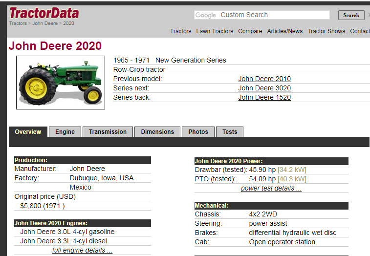

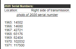

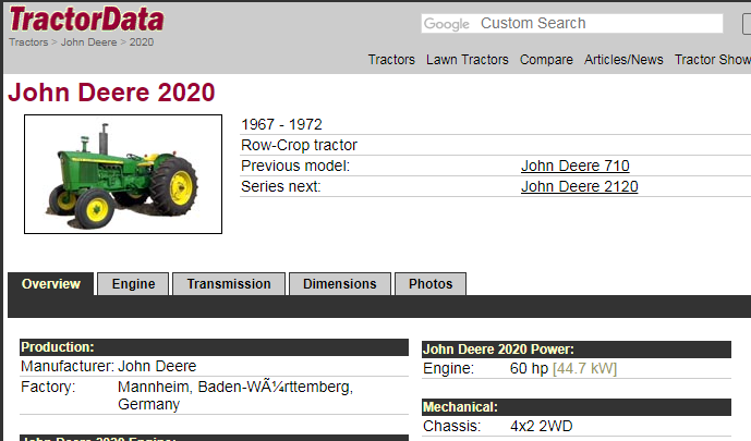

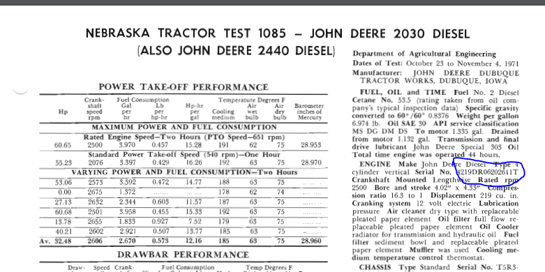

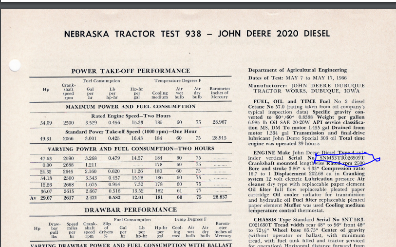

Look at the engine serial number outlined in blue for the 2020 & 2030 Nebraska test compared to your tractor's engine serial number. As I previously stated I though engine CID(219) was supposed to be on SN tag on some models BUT notice the similarity of test 2020 engine SN to your tractor's SN.

That's because I'm nearly 100% positive it's not a 2030!!!!!!!!!! Read my #4 post on this thread Z5 does your 2030 have 4219 on engine SN tag?
