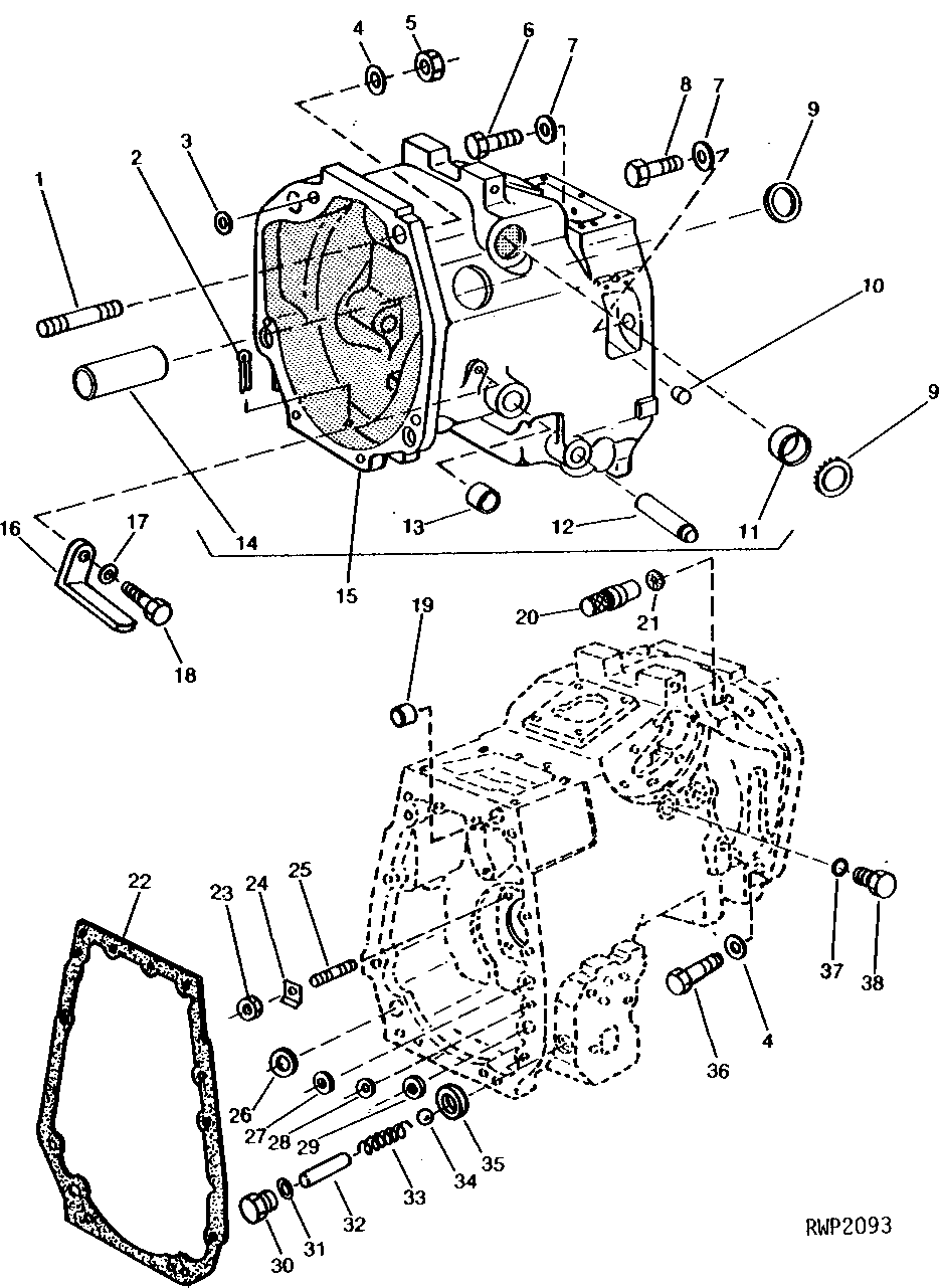

Tach cable attaches to RH side of flywheel housing under battery box & drives from end of camshaft. I agree I have thought it was a 2020 since near the beginning of this thread.
thanks, where about does the end of the wire connect on the camshaft. do u have a pic?
In the drawing from jd parts, key 20 is showing a plug (if no tach) this is where the tach cable connects. Upper right side of clutch housing

   / JD 2030 Tractor SERIAL #? #65
Well DUH!!!! Thanks Z5 for posting photo. I wasn't considering the clutch housing was bolted BEHIND flywheel housing.
help out a dummy... where exactly is the upper right side of clutch housing? tx

As I stated earlier the tach cable connection is under RH side of battery box
