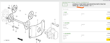

Thanks Jim.. only going by the note on the schematic in jdparts. But thought the pics would help..
   / JD 2040 Rear SCV Hydraulics #22
beenthere
No offence intended just attempting to keep info correct. Shown below is a photo of OC hyd pump confirming serial # break
