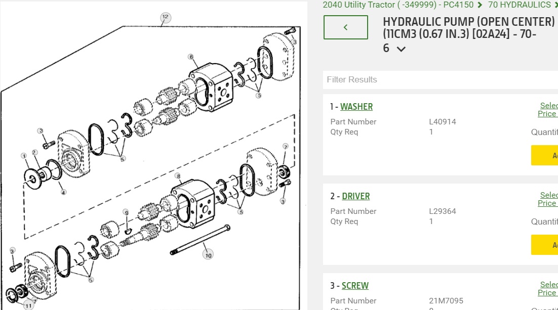

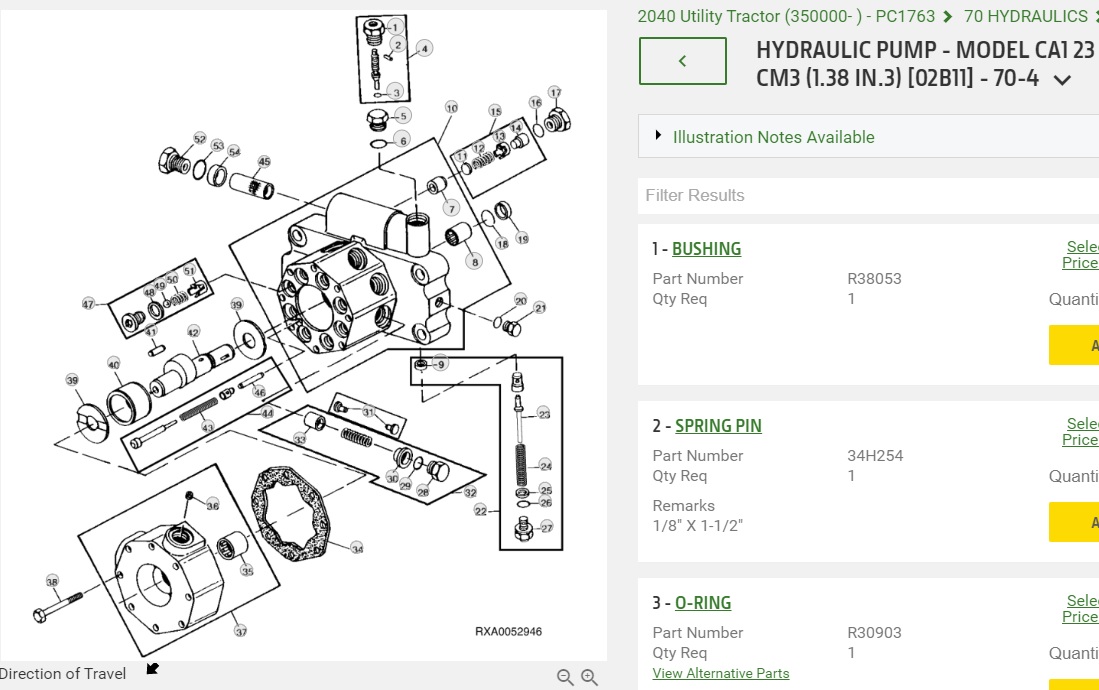

Probably no factory SCV hence the Jerry Rigged dual system. If factory equipped a pair of SCV valves are siamesed together .
If the valve is not closed centre with a closed centre pump or an open centre valve with an open centre pump, the hydraulics will malfunction.
We need a picture of the pump.
If closed center the hydraulic oil from the valve should be routed into a ported transmission filter cover. Otherwise the front pump will run out of oil if a loader, log splitter or hydraulic motor is connected.

   / JD 2040 Rear SCV Hydraulics #19
The two different pumps shown in jdparts for the 2040 may help.
Open center up to s/n 349999 and then closed (right hand pic) after 350000
Edit: TX Jim corrects "up to # 266749", and he stated that in an early reply as well... but the OP hasn't offered a s/n yet.
   / JD 2040 Rear SCV Hydraulics #20
beenthere
I realize you posted serial # for each parts catalog but open center hyd's for a 3 cyl powered 2040 was only offered through serial # 266749 not 349999
