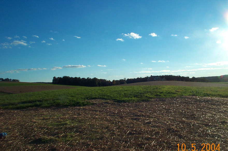

I’m new to this forum so have mercy on me. I’m desperate for advice and the 0%/36 month financing deals are soon coming to an end, not to mention the grass already needs mowed. Keep in mind that I’m currently building a house and cost is a serious consideration. I’ve got 7 acres of land. 1.5 acres will be used for lawn and the rest will be used for sheep pasture (eventually, after I put up the fence and get the sheep /forums/images/graemlins/grin.gif). All I’ve decided so far is that I need a 60” mid-mount mower. A FEL would certainly be handy for snow removal and manure management. Since the fence hasn’t been started, I’d like something that could handle a post-hole digger, but this is not a necessity as I could probably get one of my neighbors with the 50 HP Kubotas to dig the holes. A backhoe or tiller would also be nice, but again they are not necessities at this point. The terrain is difficult to describe, but basically I’ve got a hill that juts across the middle third with a 20% grade on both sides down to large flat areas. I’d guess 4WD is important in this situation and I strongly prefer a diesel engine, which use far less fuel and last a whole lot longer. I’ve been thinking about what to get for a while and it seems like either the JD 2210 or the Kubota BX23 would be good choices. I really can’t afford more than $15K on the initial purchase and that’s really stretching my finances. What advice do you’ns have for me. /forums/images/graemlins/confused.gif

I just noticed you posted a picture of your land, nice looking setup. Looks like you will be doing lots of mowing in the future, I take off the FEL and BH when I mow. They are a piece of cake to remove with no tools required. FYI, since you are just getting your home off the ground you might also want to checkout the gardenweb.com website which has a forum called "that home site" then look for the heading Building a Home. Lots of great info.

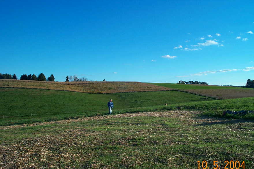

We're only about 25 miles NW of Harrisburg, where I work, but the prices are much lower. It's actually part of a farm that was subdivided into 5-7 acre tracts. Several of my neighbors have horses. Unfortunately, the adjacent 7 acres to my West was sold recently. /forums/images/graemlins/frown.gif I was hoping to acquire that too and use it for hay. Oh well, I can barely afford a subcut as it is.
