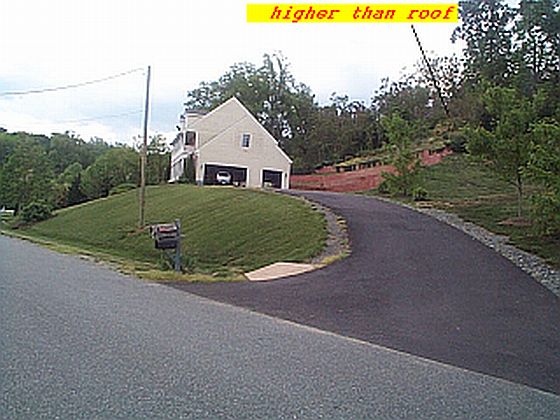

Any chance we could get some pics of this property, I think it would give us a better idea of what your really up against

Some of you have asked for some pix of the property and I am providing four:
The 2 dimensional photos really don't show the steepness of the inclines but you can see the 4 concrete tiers and the 2 earthen tiers at the rear of the house with the top one being higher than the roof and I have shown a pic from that location as well. I also included a photo taken of my neighborhood ca Dec/1862 after the union troops captured it from the confederacy, my house sits in the middle of the second/third ridge in the photo.
