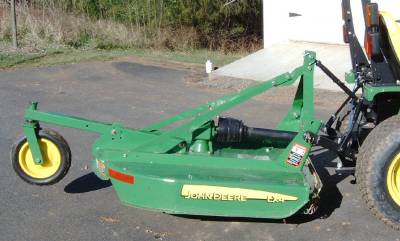

I would be concerned about the dealer suggesting a 5ft bushhog for the 2210. Per JD's own literature and website, they only recommend the LX4, four foot bush hog. I've got one that I purchased with my 2210 last September. It is still on the shipping skid as I'm debating whether or not to have it coated with the Rhino lining like I did my 62C MMM.
Anyhow, that LX4 is a large mower! I can't imagine putting a LX5 behind a 2210. Our local dealer has had several 2210's on display with the LX4 mounted on behind. The one sales guy showed my how you couldn't lift the LX4 very high with the 2210. I showed him that they were using the wrong holes for the lift bins. The LX4 has two sets of lift pin holes, the lower ones allowing added lift height when used with the 2210.

I ended up buying a JD 4010 with FEL and LX4. Cost $13,300 discounting the $300 I paid for a toothbar. A 2210 would have been $300 more.
Attached is a pic of the LX4 lifted with the 4010 and with the hitch pins in the bottom holes where they ought to be for the 2210 or 4010. It would lift a couple inches more at the rear if I had the top link shortened properly for operation (I use a chain and just replaced it with the top link for the pic). You can, of course, shorten the top link further to lift it quite high for transport or for going up and down a ramp, but it requires manually tightening up on the top link.
The 4010 is about 4 or 5 inches higher up than the 2210; so, its lift height with the LX4 may be less.
You need to also worry about weight if you have any hills. Even an 18 hp machine will handle a 5' hog, but the weight can lift the tractor up in front. A friend with an 18 hp Kubota fills his front tires to keep this from happening. He doesn't have an FEL though.
