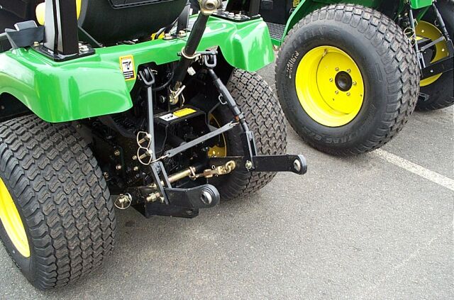

I saw my first 2210 today, nice machine, /forums/images/graemlins/cool.gif if they had it out a year ago, when I was looking at the BX it would have been really hard to decide, 62 inch deck, /forums/images/graemlins/laugh.gifwow. I think the 3 point hitch on the 2210 is a much nicer set up. I do not think the 2210 people will have the problems with 3 pt fitting the tractor as the BX folks do, see picture

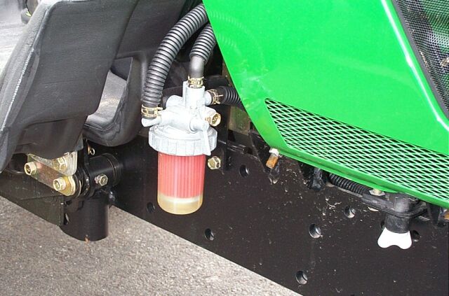

Here is a close up. I would worry something would hit it and cause some real damage, you think they would have found a better place for it. As far as changing the filter, well that will be very easy...BUT

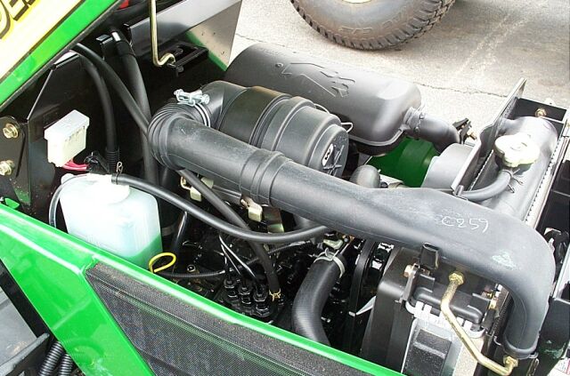

I did like the layout of the engine compartment, I like the full view of the radiator fill, I can not see the liquid level on the BX without taking the sides off, real pain with the grill guard on. I guess if you are the second kid on the block to have a sub compact, you can build a better mousetrap This took what 3 years to come out?? Would I spend $1000-1500 more for a 2210????, if I was looking again, I may /forums/images/graemlins/grin.gif

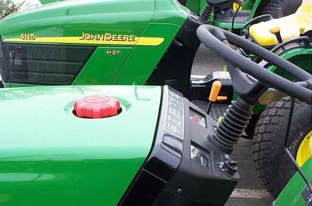

What do you think of the location of the fuel tank fill? I like the Bx better, I am short and the location on the wheel well is nice. Guess if you are 6 foot it would not matter. One thing I did notice with my short legs and big gut, the wheel was too close and the foot pedals were too far away /forums/images/graemlins/tongue.gif

I think I would have that filter knocked off the first day I was clearing trees. That is not a good place. I just can't believe they couldn't find a better place.
Murph

There is also a picture of the exposed fuel above that cause me some concern. That area is a bit more isolated than the picture shows, behind the side support for the loader. If something gets in there to damage the filter you wil also need to worry about operator safety. It's high-impact plastic, too.
