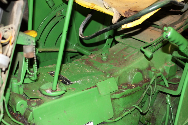

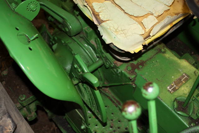

Can you post a picture of below the seat??
/ JD 2240 3 PT control?
I planned to do that this morning when I went to feed the cows, but forgot my camera. I'll try to remember tomorrow. The more I look at it and think about it, I'm beginning to think that I may have a broken or disconnected linkage inside. I ordered a manual, but it won't be here until sometime next week. Right now I'm just trying to figure out which control is supose to do what and I think I figured that out???:confused:
I believe the larger lever should control the up/down on the 3PH and doesn't. I think the smaller lever with the detents tight to the 3PH housing is like a depth control or something. I'm pretty sure the bolt under the seat is the control mentioned earlier for controlling the drop pressure. I'll try to get pix out tomorrow.

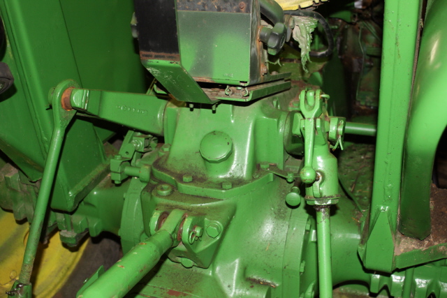

Here are the pix.

Yup, control right in front of the seat is the Rate of Decent valve...if you want to call it that. To the right of the seat is the draft control, and this should be in the top hole...all the way up do defeat the draft control. Far right control is the up/down for the 3pt. I had to go all the way thru my 3pt at about 5000 hours replacing valves/seats/and springs. Not a big job.... Mine was doing the automatic up/down pulsing thing. But I bet you are in for a run to the JD dealer for some little expensive parts...... Everything is in the top casting that the seat bolts to. If your bottom 3pt seals are leaking where the shaft for your two 3pt drag arms go into the main casting....this is a great time to deal with them, too. Since you will be dumping all the fluids. Me, I forgot...and mine still leaks some....... Good luck, ,Jerry... :)

Sorry for not updating this thread. I ended up doing a rebuild on the 3PT. Here's the thread on it. http://www.tractorbynet.com/forums/hydraulics/174760-jd-2240-rebuilding-my-3-a.html The gist of what I was experiancing was that my lift valve was leaking and putting pressure to the cyclinder.
The rebuild was pretty straight forward and simple. IIRC, the parts weren't that expensive either. Under $200 I think.

We adjusted the ROD and moved the drift to top notch and everything works perfect. BIG THANKS!
