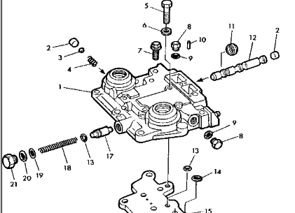

I toke this photo out of the JD3140 book just to show you the gaskets under the gearshiftcover. I do not have the JD 2240 book.
Several things:
I don't have a JD2240 book either. I do have the 2120 Technical Manual - but not Parts, and not Shop Manual. In the transmission section of the 2120 tech manual, one of the top views of the transmission shows a hole that looks just like the one that is spouting. But unfortunately it doesn't say a word about that hole or why it is there.
Lots of JD tractors during that era used variations on the same transmission design, the collar shift 8/4 or powershift 16/8. Since the hole shows on three of the models we've looked at, I am assuming that it shows on most.
BTW, I never got a reply to whether it was threaded or not - but a vertical hole would have to be threaded & plugged.
The reason I asked about parts 15 & 16 is that the picture that DLTTreckers posted seems to show an item that fits into the hole. Kinda out of focus, but looks like it might be a pressure regulated breather. Could that part have gone missing?
Back to the hole itself, I figure something is missing because I cannot imagine that any designer or manufacturer is going to be dumb enough to allow an unprotected open vertical hole like that in a casting where it would hold water and dirt. And certainly not a hole that can communicate with the inside of the tranny as this one is doing. You wouldn't expect that on the cheapest import, and certainly JD is better than that. If JD had to put a hole there for some manufacturing reason, then good design practice would demand that the hole be threaded and/or plugged. So why not simply put a fitting into the hole to seal it? It could be as simple as a screw and washer.
But whatever goes there, if it were my problem I'd simply go over to the local JD dealer and order whatever part their part book says fits into that hole. Done.

I think leak is at pin(key 10) which can only be resolved by replacing gaskets/seals in shift cover as DLTTrekkers stated earllier
TxGrndad, I believe you said you had already had the cover off and replaced all the O rings and gaskets. What is under that hole in the cover? Is there anything there? If not, is there a chance that there should be a locating pin that has gone missing? If so, it could be that the missing pin should have an O ring around it.

Well, we may have gotten there for TxGrndad's oil spouting problem anyway.
Because of your post #23 we now see that mysterious hole may in fact be a locating pin hole.
And if it is, then we are in luck here because we also know that locating pins often have an O ring around them to help in case the gasket itself isn't enough to separate a pin hole from an oil system.
And we know that it's possible for locating pins to sometimes fall out and be lost when you take off a cover to do gasket work.
It's sounding more and more like that's what happened. At the least we have workable theory that explains what we are seeing.
And that's a step forward.

Post 23 ...look at bolt 5....from the top.....thats the bolt thats missing. Get that bolt and install it !
   / JD 2240 Hydraulic Geyser #28
Take a piece of wire and see if it can go thru that hole ? If not that bolt broke off. Then you will have to remove shiftcover and remove that brokenoff piece . While you are there check the gaskets in that sandwich !

I toke another look at you first photo.....pleas ignore all my advice....Sorry !
   / JD 2240 Hydraulic Geyser #30
looking at this, I think the locating pin somehow got pushed out the cover, and that's why it leaked.. there should not be a hole going through the cover.. fix.. buy a new cover that has not been abused..
