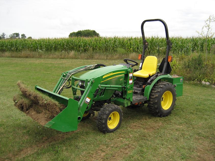

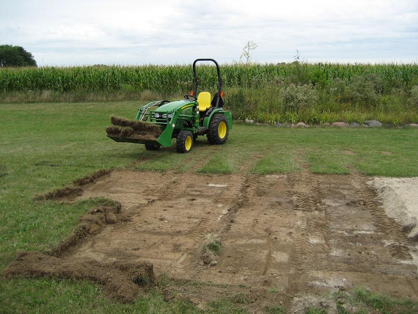

The 2320 digs quite well without a toothbar. I have removed sod and dug out 6" deep for our 20x50 patio and just finished digging out a sand bunker for our kid's climber. I can only imagine that having a toothbar would relieve a fair bit of strain on the loader and bucket since the actual ground penetration would require less force. If digging is what you want to do, the extra lift power of the 2320 definitely comes in handy. The 2320 will push into the sod so deep, you have to back away so the hydraulics will lift the chunk out. Just make sure to have lots of ballast or the rear end lifts up! It is amazing what these little tractors can do!

Good pics, I am going to take my toothbar off when I cut sod next week. I am hoping that it will make a smoother cut. That toothbar sure has been a help digging in red clay and rocks this summer though.

Woody ,nice pics thanks.

The first cut through the sod is the tough part. Depending how deep you are planning to go down, you may want to cut your edges with the toothbar on. After the first bite, as long as I didn't try to take more than a 3 inch layer at a time it just rolls into the bucket like butter. It sure beats the heck out shoveling.
