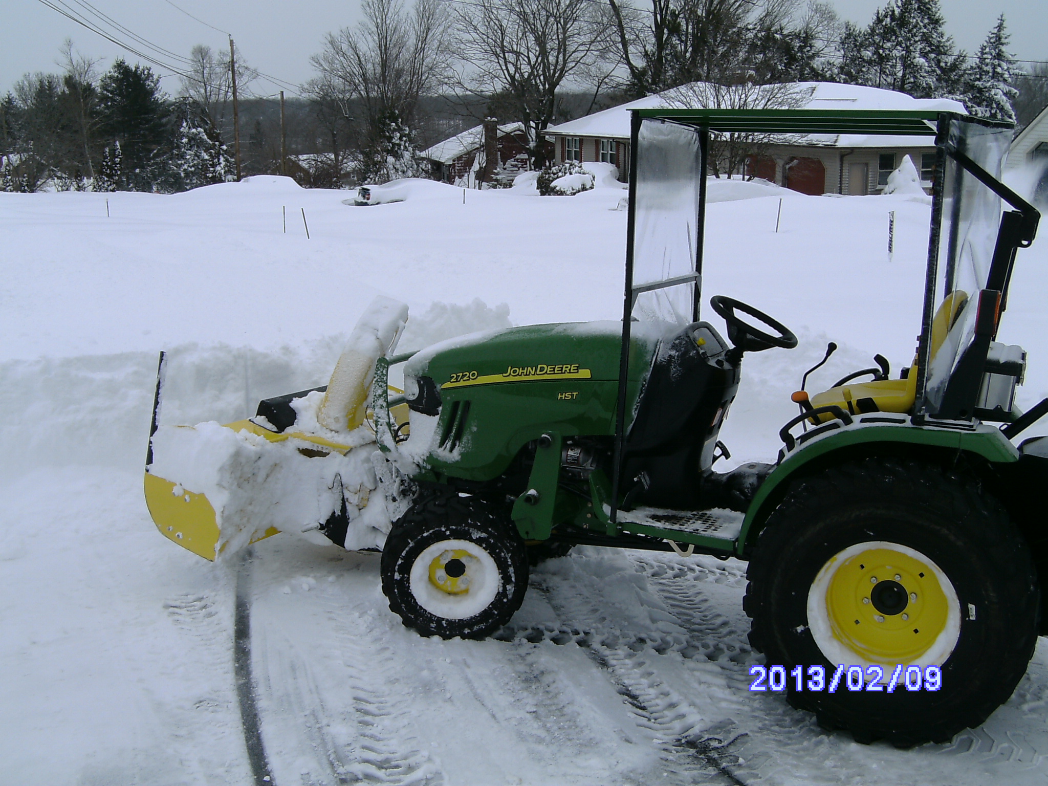

I have a 2720 with R4. I just went though the 2013 Blizzard in CT. Where I live on top of a hill. I got over 4 feet of snow and drifts over 7 feet high. The R4 in 4wd worked fine. I have a ballst box onthe rear with 350lbs. Just enought to conter the weight of the 54' blower. I had one issue on Sunday when I went to far in bottwm of a 6 foot pack snow bank that the street plow left infront of a driveway. The bank fell between the tractor and blower. I tried to back up but the weight of the snow burying the front was to much. I was also on a layer of ice. Dug out the snow between the blower and the tractor and it backed out without any issues. I was a little more careful after that. I do have chains, but in 3 years i have never had to use them.
/ Jd 2320 #20
Here is a picture of my 2720. I working on making the cab myself. The front, roof and back are done. still working one the doors. The roof, front and back come off is less then 5 minutes.
Nice not to have the snow flying in my face. In this pic I finished my driveway and the tractor is in the street which had not been cleared yet.
