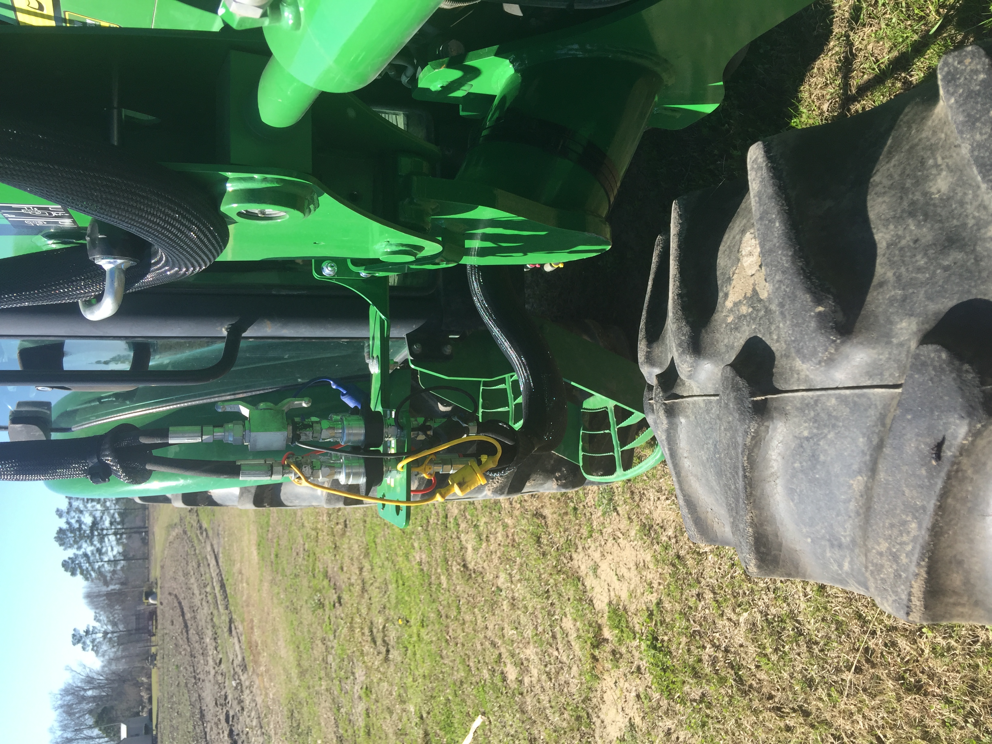

240 hose connection.JPG What I read concern about was the platform for connecting the hoses and how it was position to easy tear it off. My tractor tires are on 6 foot spacing but that mount is totally protected by the tires. If it gets damaged on my tractor then the tractor is in a place it should never be. It is heavy enough any vine I have ever seen would not stand up to it and in our southern trees we have some big vines or at least two inch if not three inch diameter. This set up is so much better than under the tractor where they were. On the quick disconnect under the tractor you had to tie the hoses up to prevent them hanging low and really being exposed to getting caught on stump, limb or such. If you only run in clean areas no issue with either, sorry mine works as has been pointed out with trees also. It is so much easier to use than under the belly is. Especially if in mud or water.

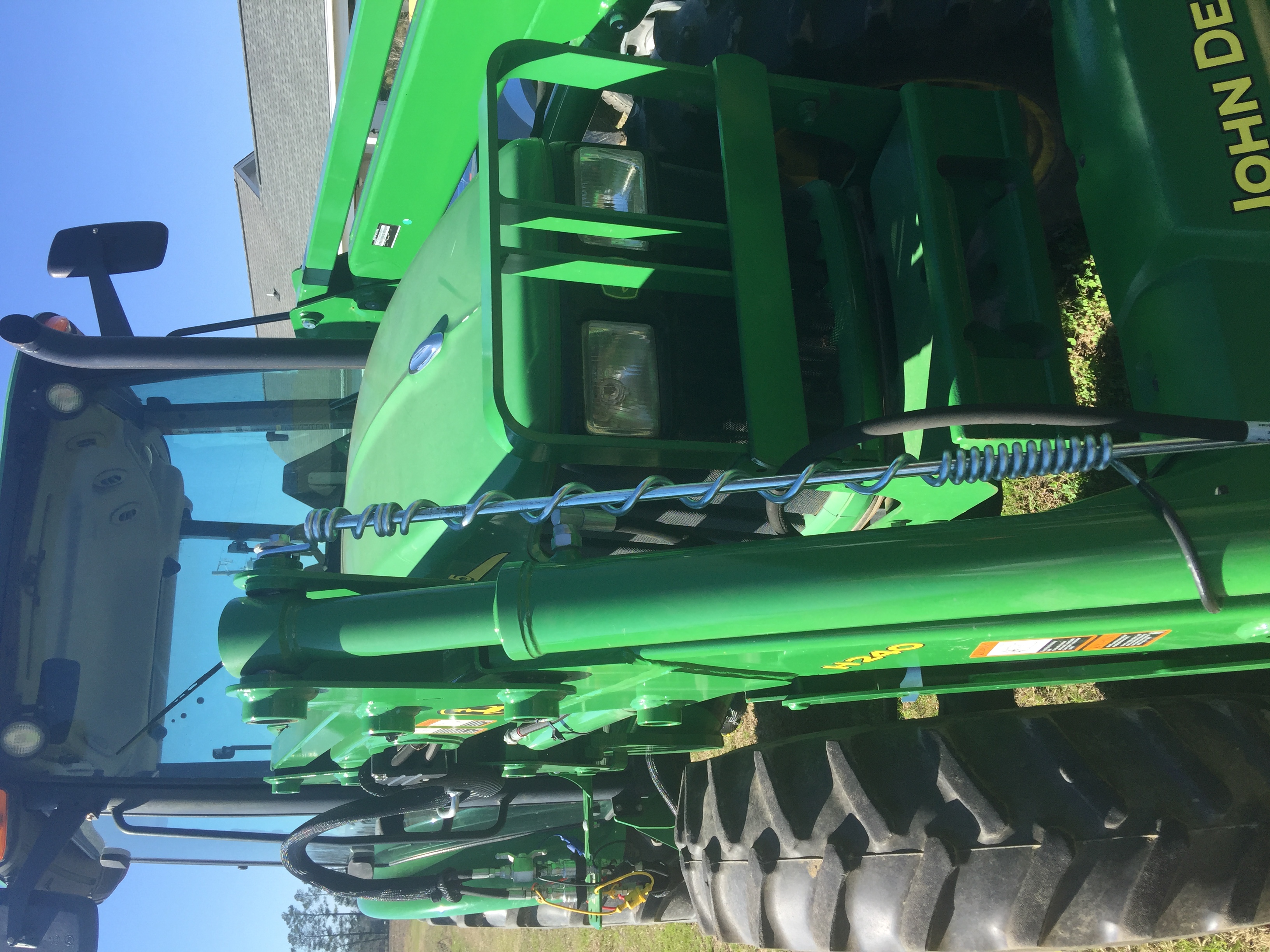

240 with level indicator.JPG I had asked questions on installing a camera to see the position of the bucket and know it was option on the 541 but buying used did not have one but the 240 is it standard (boy the price to buy as parts was costly!). I do like the coil wrap they use for it prevents rod being jammed by trash falling into a tube and you can see how low the rod is. I am still getting use to this.

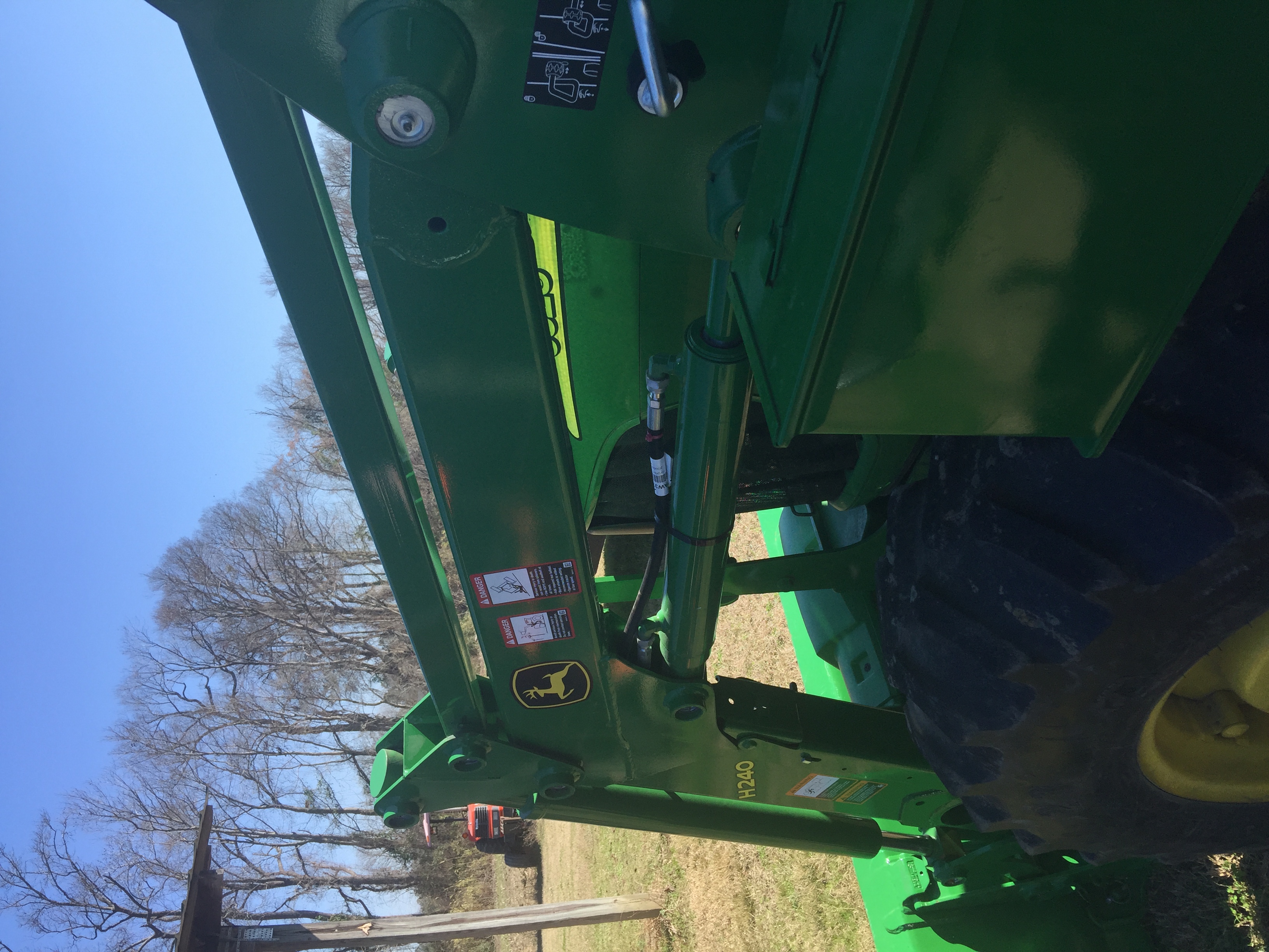

240 with sel bucket.JPG The self leveling bucket option which my 541 did not, I really like. One less thing to worry about as you are lifting a load and moving helps you keep your eyes on tractor movement and not having to watch the angle of the bucket for the lift. Do not suggest you never do a visual check on the load with this option for some loads will shift and can roll out even with level bucket. It does not replace "thinking". Do realize it adds a few inches to the height of the loader boom which does interfere with vision some. If memory is correct a $700 price but an option I strongly recommend after using it once. Sure beats dumping any load on the hood or worse a load that could roll out the bucket onto you.

Well have removed the loader once now for plowing and that process was good. Little slow as was new too it: The legs to support it are fold down and just have the fel lifted enough or the front tires turned so the legs can clear them and that is very easy and quick. Lower the fel so the legs and bucket have the load and easy to pull the two pins to remove it. They do not have to pull clear of the loader and they will store in place. Use the fel cylinders to move the loader off of the mount. Now I turn the cutoff on the hyd line to lock it and then worked the control for the fel. Really like the mount setup for the hyd hoses on the side of the right mount compared to access the hoses under the right step, big improvement.
The past Saturday reinstalled the loader to move some dirt and that process was quick and simple. Maybe I just lined up best possible but was easy to connect the hyd lines and easy the loader into place. Was not sitting perfectly level and happened to pin the right side first and then realized the left side was at least quarter of inch off but was quick to a line with using the fel cylinders. If it took five minutes and my first reconnect that was it. Again really really like where they have the hose connection now. Much easier than under the step.
Not sure where I saw a concern on the location of the hose connections on that loader as they will be torn off was about the way it read. I have had no issue with it being located where it is. It is inside of the width of my tires which are set on 60 inch center, inside of the fel bucket also so not sure where the concern is with them. I think they are every bit as safe as when under the step.
