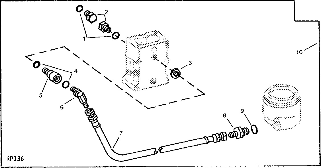

RP136__________UN01JAN94.gifI agree, lower that pressure down to 2350 and check the clamps on the lines. The trans pump pressure can be checked at plug on the right side of the shift cover. That is the port for the pressure for the Hi-Lo. The loader stuttering at times might be due to running the loader off of the rear remotes. From the factory, the rear remotes return their oil to sump, through a short 3" hose between the valve and the three point housing. If that short hose is there, you should change that routing so it returns to the filter cover. The transmission pump does not have enough capacity to supply enough oil to the main pump for steady raising and lowering loader cylinders. If return oil is routed to filter cover, it is sent directly back to main pump to assist the trans pump. Is there a hose attached to the cover? Do you have a ported filter cover? If the cover has no port for attaching hose, a new cover is required. You can then remove the short hose with clamps and put plugs in place of hose nipples. Then on the outside of the remote valve housing directly opposite of original hose is another plug. Run a new hose from valve to ported filter cover. Illustration shows the conversion kit. Part number is listed as AR71945.

The tubes supplying oil to the hyd pto have been known to leaking robbing supply oil from trans pump to main pump. For diagnostics remove and cap power steering line(parts key #10) and operate hyd's and see if noise is still present.

Removed and capped steering line, noise remained. Installed pressure gauge and charge pump pressure is 140 at idle, 160 above idle. The valve assembly has the 3 inch line between the valve and lift cover. I did lower the pressure down to 2350 PSI at the rear remote and the noise reduced significiantly but not completely. I was wondering about the fluid flow through the 2 large lines. I missed originally a crimped line which could be limiting flow from the charge pump to the front pump. It is not completely crimped close but enough to reduce flow. It is the lowest line on the rear housing that goes forward. My concern is the noise goes away when rear remotes operated and or 3pt raised. Returns when no fluid flow is needed. Steering circuit has no influence one way or another on the noise. The owner will be by tomorrow so I can discuss where we are so far. Thanks
