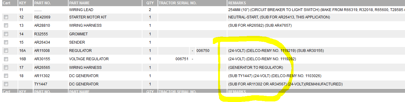

You are right Tx Jim on the alternator, but I was talking about a generator.
Generator JD utilized on 24 volt systems were also 24 volt not 12 volt. Supply this forum with a part number of this phantom 12 volt generator utilized on a JD 24 volt system
   / JD 24volt charging #30
I see 24 volt but no mention of 12 volts on 24 volt system

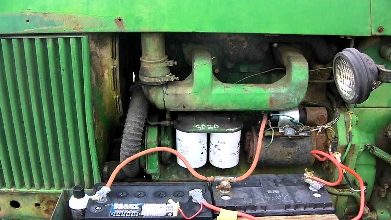

Wow, I've been too busy to check here for a few days. I didn't mean to start an argument. Thanks to all for the ideas and links to possible options to solve the problem. Between the I&T manual that I found, the parts guys at the local dealer and a lot of brain picking of the old timers around here, I have come to terms with the whole 24v thing. It's essentially the same as house wiring, where you get 110v between the hots and ground, and 220v between the hots. I've done enough wiring and working with electronics with bi-polar power supplies that I'm not too worried about putting it back on this tractor.
Provided the alternator works, I'm just going to keep the 24v setup. Why spend the money to fix what ain't broken? That leaves me with 2 questions:
The alternator has 2 terminals in the side to power the field and regulator. Does anyone know the polarity on them? If I can power that up, I can see if it's 12 or 24V, or working at all. The outputs are isolated from the frame as someone had said, and it apparently charged the batteries, so it may be 24V even though it's marked 12. Based on the serial No. of this tractor, it shouldn't even have a delco alternator. With all the hacking that was done on the electrics in this tractor, anything is possible.
TxJim, can you post a better picture of that fuse kit that was installed to prevent fires, or give me a part number that I can take to the dealer?

The breakers that were field installed have no illustrations(photos ) in JD parts catalogs. Part number for breakers is AR47660. Can you post a photo or part numbers for the alternator on your tractor? Here's is the parts photo of the Motorola 24 volt alt that the very few 4020's with AC cabs came with from the factory. I found a photo with the mounting bracket for a 3020 which should be very similar to 4020 BUT bracket & breakers are mounted to starter incorrectly but will give you the idea.
