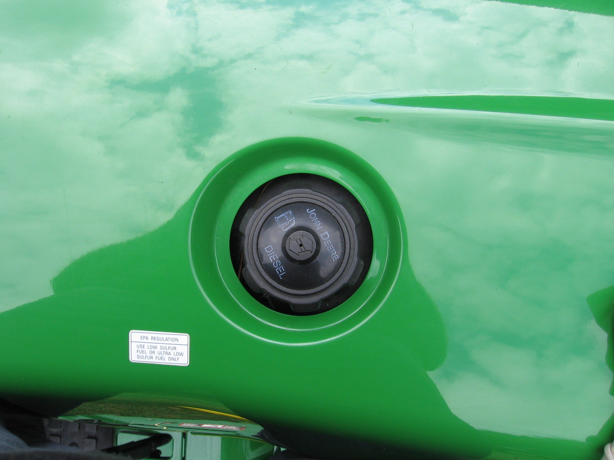

I'm piping up here too.
I've had my 2520 since August of '06 and from what I can recall at least the first 3 years I had no issue of opening the hood:thumbsup:
...then all of a sudden one day I opened the hood, and something seemed stuck, so I gave a little harder pull and I heard a pop. That's when I realized I had a problem.:confused:
After closing the hood back down I figure out it was the fuel tank cap. I'm lucky, my hood has the slightest of bends and it is practically un-noticable, However, it pulled up a corner of the fuel cap. My situation could have been alot worse if the what-ever happend to be the cause of this was just slightly worse. I imagine those hoods are not cheap.
Deere should figure this out. It get's old quick having to remember to take the fuel cap off everytime someone wants to open the hood.
Plus you run the risk of contaminents sliding off the hood into the tank.
There are obviously alot of 2520 owners...and I'm sure 2720 owners too out there with this problem. JOHN DEERE...if your listening, this needs re-engineering:confused3:

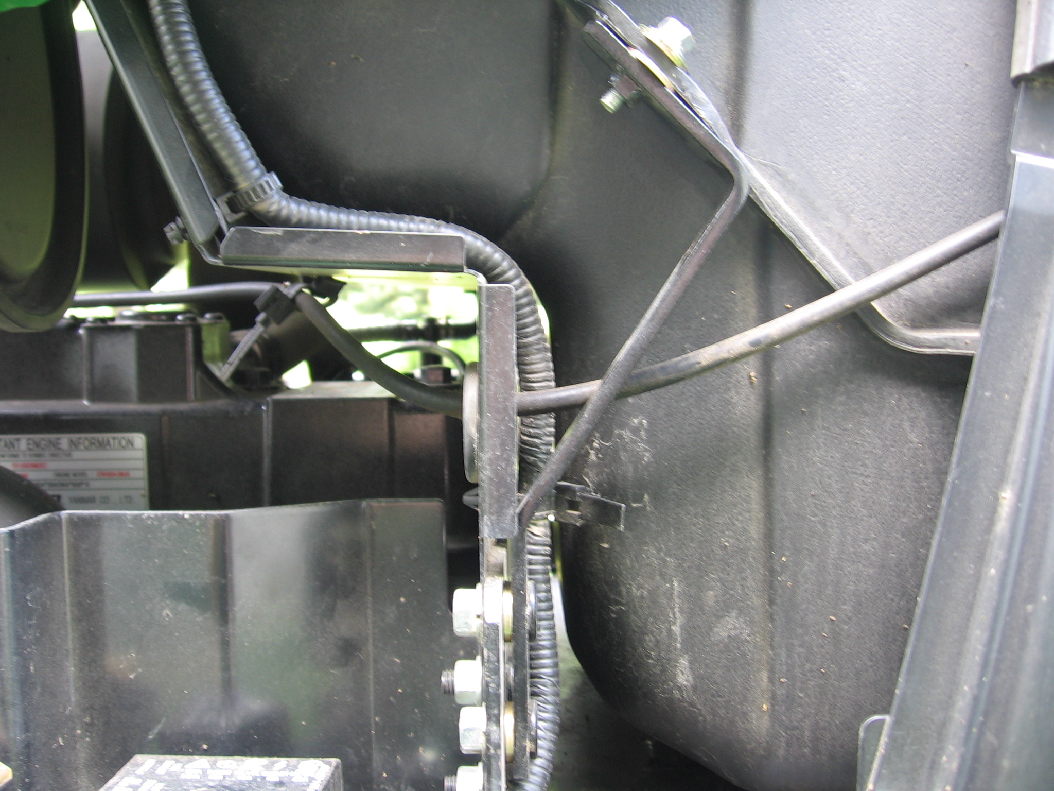

   / JD 2520 gas cap/hood clearance problem #38
I had a pretty empty tank after mowing today so I figured I'd take a look at this tank problem.
My diagnosis: the firewall is way to flimzy.
When I took the two side brackets off,the tank was unbelieveably easy to move,firewall and all. I don't think it's a bracket problem at all.
So I pondered it a bit,and decided what others have done............washers.:)
I loosened the front bolt in the middle of the firewall,so the tank was really free.
I had some pretty thick (about 3/32) 5/16 washers that I put between the brackets and the firewall which moved the bracket backwards and made them alot tighter against the tank. Then I put a regular thickness 5/16 washer between the tank and the bracket. Right now the tank cap is perfect,we'll see how this fares.
After seeing that it wasn't a bracket issue,I'm not going to do any gussett work because it's not necessary.
JD needs to beef up the firewall,my .02 of course.:)
Greg

Nice work. I agree with the firewall.
   / JD 2520 gas cap/hood clearance problem #40
So what do you think would happen if one were to just unbolt the connection at the firewall. That bracket holds the tank down vertically and the tank is sitting on pads underneath so it can't drop downward anyway. Then put shims under the angled bracket mount on the sides. You would be left with 4 connections instead of 5. Would that work?
