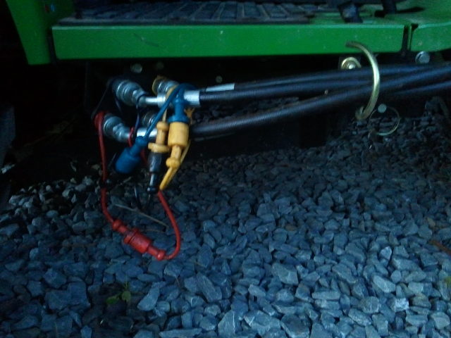

- +1 on getting the wire bracket for the hydro hoses.

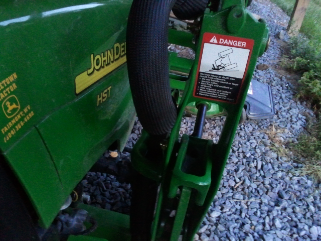

I think the hose loop is supposed to come with the loader. Check with your dealer and see if they forgot it. Also, try routing the hoses below the loader cross frame. It seems odd, but I've found that running through the loop and under the frame seems to keep the hoses higher than routing over the frame. That said, most people seem to route them over the frame as you have them.
   / JD 2520 with pics #13
Yes it should come with the hoop. But I recommend pulling the line up from the loader side.

Thanks for the tip kennyg. I also added a large and thick spiral wrap around all four hoses together for a little extra protection. I'll take a picture tonight if i remember.
