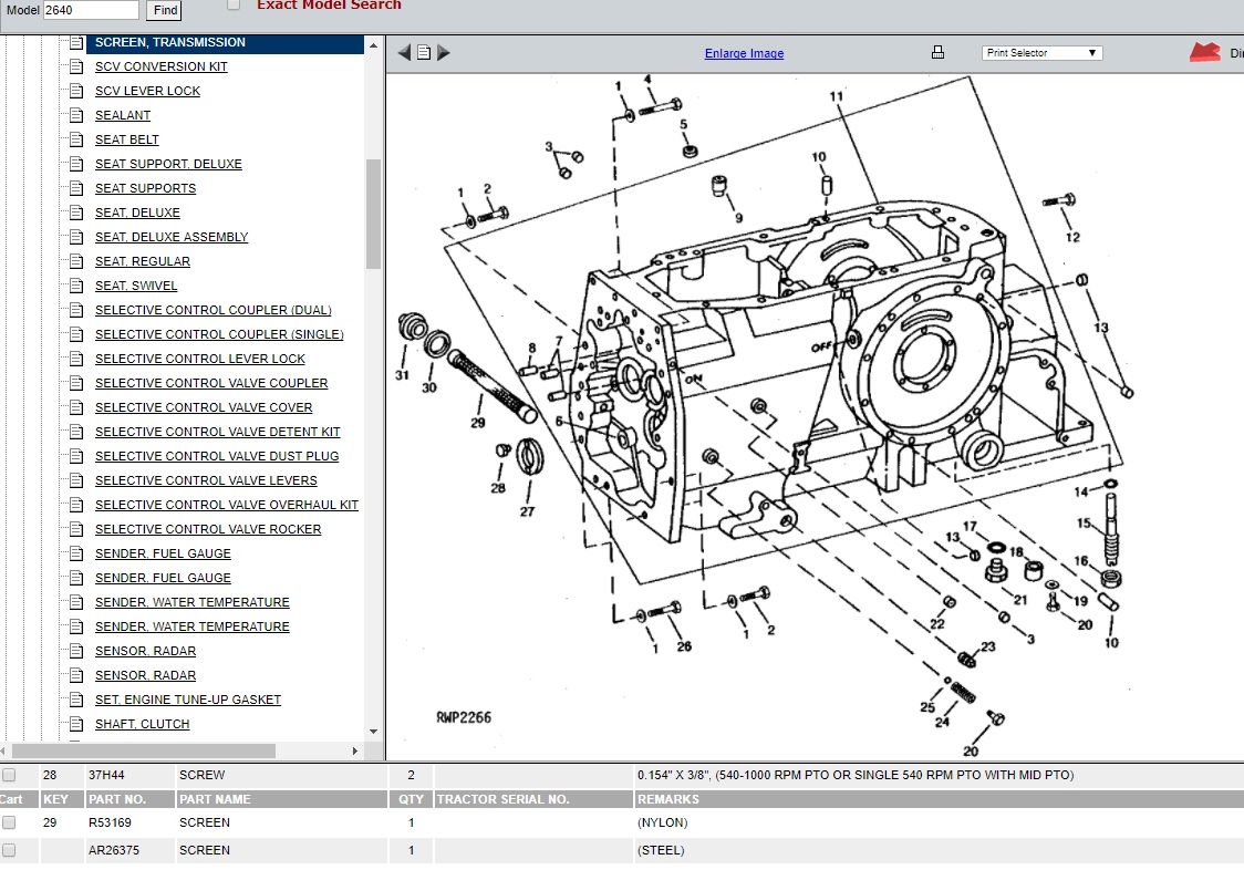

   / JD 2640 Loss of Hydarulics #15
Rathpr
Was the hyd screen that you cleaned nylon or steel? key item #29
   / JD 2640 Loss of Hydarulics #16
I dont know that much about hydraulics. The FEL control valve is a 2 Spool 5 GPM Eaton Cessna. I started the tractor and the coupler is working OK
Disconnect FEL control valve return hose from tractor. Aim open end of hose in hyd filler hole behind seat. With engine running,valve control levers in neutral no oil should exit hose. Of course this test is invalid if frt pump isn't pumping any oil. Another test is with bucket under housing remove hyd filter housing & turn engine over for 15 seconds bucket should have 1-1/4 gal of oil in it.
   / JD 2640 Loss of Hydarulics #18
In Post #1 says he checked the filter. Thtat will be the external 'can' filter?
There is an internal screen in the bottom of the transmission case. Access by removing plug cap on RH Side.
A Clogged screen will cause loss of all your functions, especially if steering has gone since steering has priority in the circuit.
You don't say you checked this screen filter. Some models had a steel mesh screen, some had a nylon mesh.
When was the last Trans oil change?
Rathpr
I'm curious what difference screen material matters?
No difference I don't think Jim, other than to jog OP's memory and confirm he actually accessed the screen.
   / JD 2640 Loss of Hydarulics #19
tks Spanner.. was hoping to confirm that this screen was one of the two "filters" mentioned, in a subtle way.
   / JD 2640 Loss of Hydarulics #20
Yes BT. I was going in the same direction. Still not sure.
It sure 'seems' like suction screen problems...
