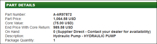

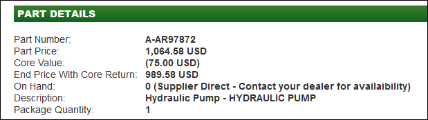

   / JD 2640 Loss of Hydarulics #25
Thanks for update. If trans pump shot hyd oil 6' into the air I doubt a spring was blocking much flow. $5300 sounds way too high to this former JD dealer service manager. Gees a new frt hyd pump from JD is less than $1000 so that leaves over $4000+ for labor.
