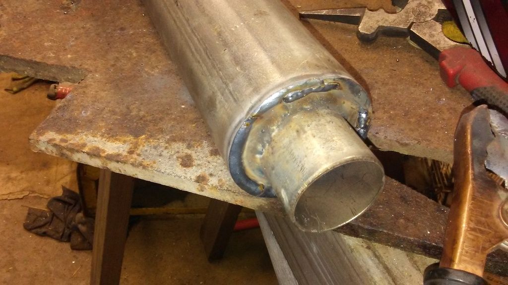

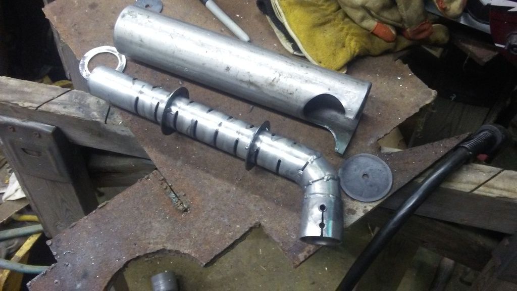

Got the muffler assembled. Here is the inner section.
Got that inside and tacked in place.
Got all seams welded up.

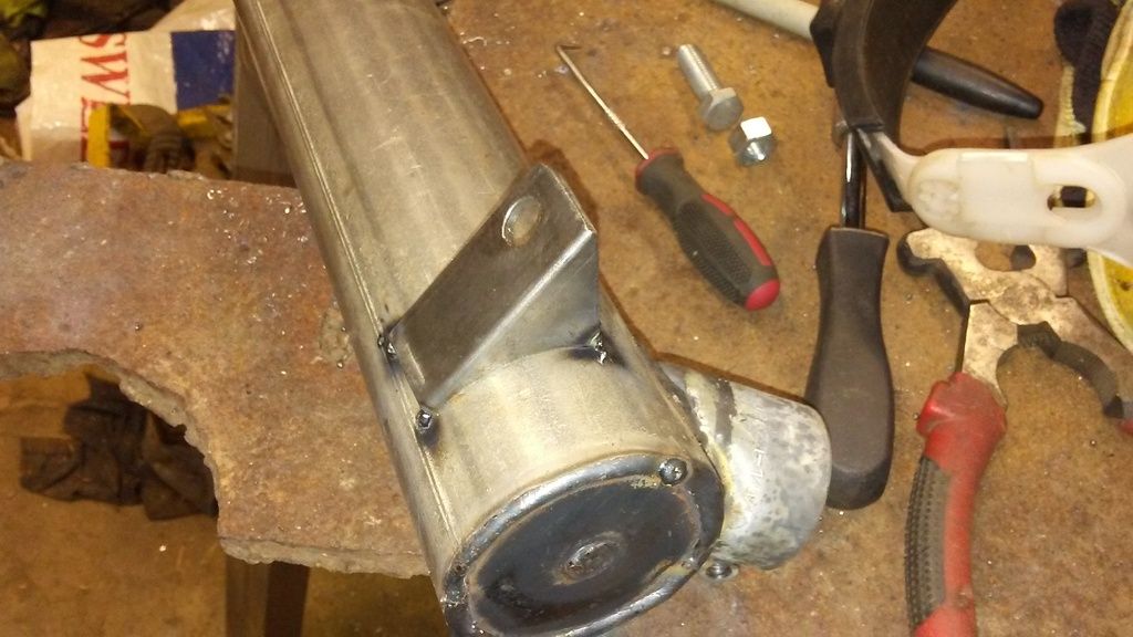

Few minutes here, few minutes there... Got a bracket to mount the exit end of the muffler cut out and welded on... Only tacked in the picture. Uses existing hole in the front frame.

Made the last mounting tab/bracket, and tacked it in place. Welded in the bracket and muffler. That much is done-ish. Want to smooth up seams/welds, paint with heat resistant paint, but its on there for now.
